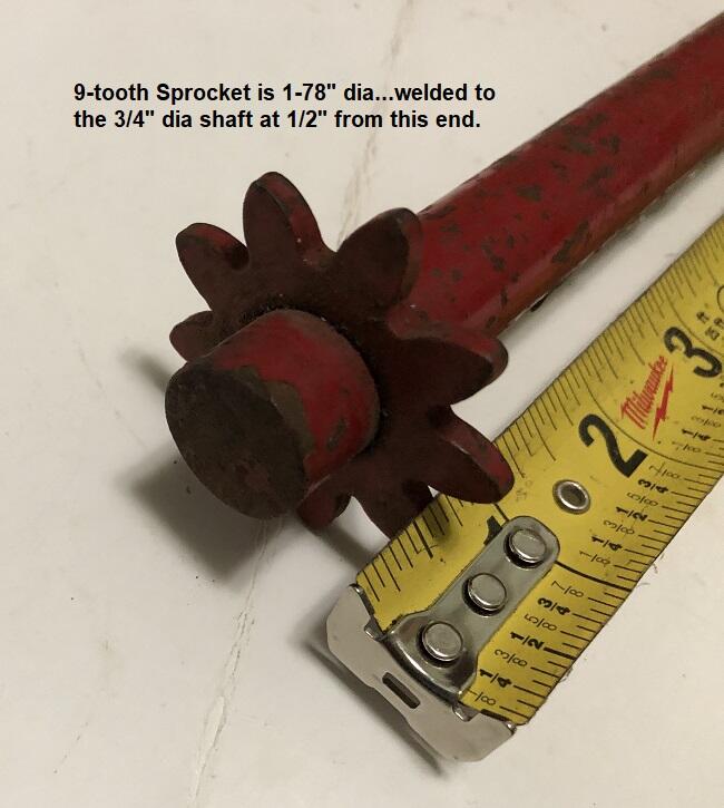

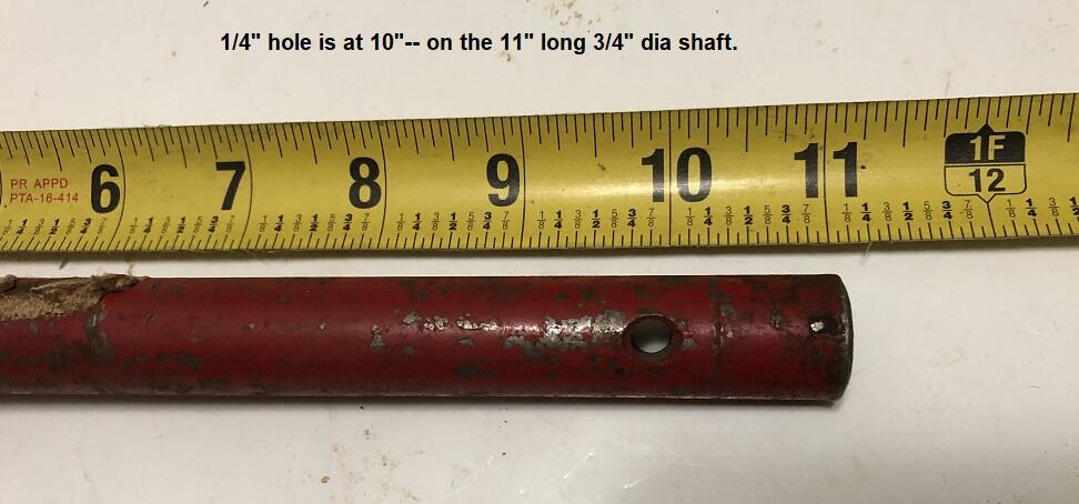

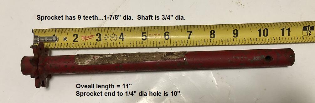

daveoman1966 3,884 #1 Posted May 22, 2025 Help identify.... It was in a box of other Wheelhorse parts. ---NEW--- but I can't read the sticked part #. Appears to be a steering shaft / column and is Wheelhorse RED. It is 11" end-to-end. 1/4" hole is 10" from Ssprocket end. Sprocket has 9 'teeth' and is 1-7/8" dia...welded to the 3/4" shaft. HELP--- 1 Share this post Link to post Share on other sites

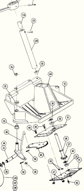

gwest_ca-(File Mod) 12,485 #2 Posted May 22, 2025 Possibly a R-26 rear engine rider? We have a 1973 parts list 4 2 Share this post Link to post Share on other sites
gwest_ca-(File Mod) 12,485 #3 Posted May 22, 2025 The parts list was copied from Toro but does not match the illustrations. Parts Tree may have attempted a correction - Must go to bottom of the list to get to item 37. Part number 103168 https://www.partstree.com/models/2-0102-r-26-toro-rear-engine-riding-mower-1973/r-26-riding-mower-1/ 2 2 Share this post Link to post Share on other sites
gwest_ca-(File Mod) 12,485 #4 Posted May 22, 2025 Managed to get all of the parts list except a page or two around item 60. Got to give up on it after many tries. Rev (revised) is in the file name. 3 3 Share this post Link to post Share on other sites
