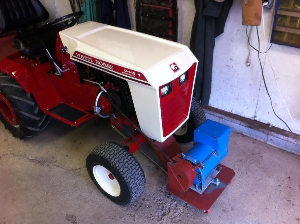

squonk 46,990 #16 Posted May 23, 2025 1 minute ago, ebinmaine said: Pete I just tossed a "mention" on a thread that has some good info. Trina ended up buying a Graco of some sort. Don't recall the model. @squonk. Love that white black hood. That C-145 in those 2 pics was done in 5 weeks including an Eaton Hydro swap. I bought a hood and trans at the Big show and finished it for the Steam Pageant in August 1 1 Share this post Link to post Share on other sites
