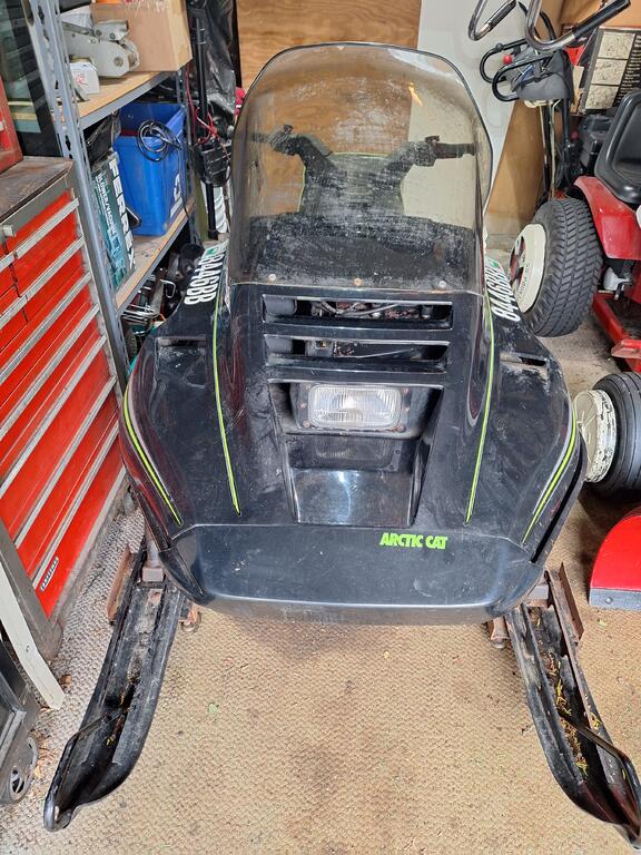

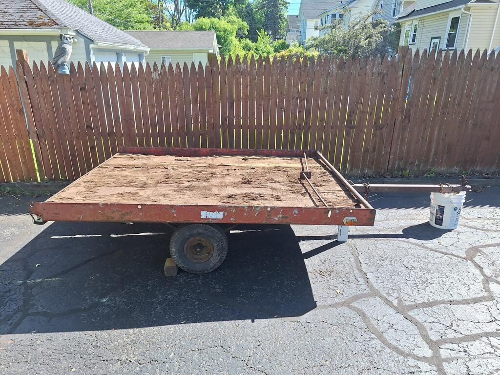

D_Mac 9,333 #1 Posted May 20, 2025 1990 Artic Cat Jag 440 AFS. It hasn't run in 20 years. Stored in a shed. Appears to be in great shape. No tears in seat, no cracks in cowl or windshield. 3400 miles. Also came with snowmobile trailer. Trailer is in bad shape. Registration for the sled not for the trailer. More to come. 4 4 Share this post Link to post Share on other sites

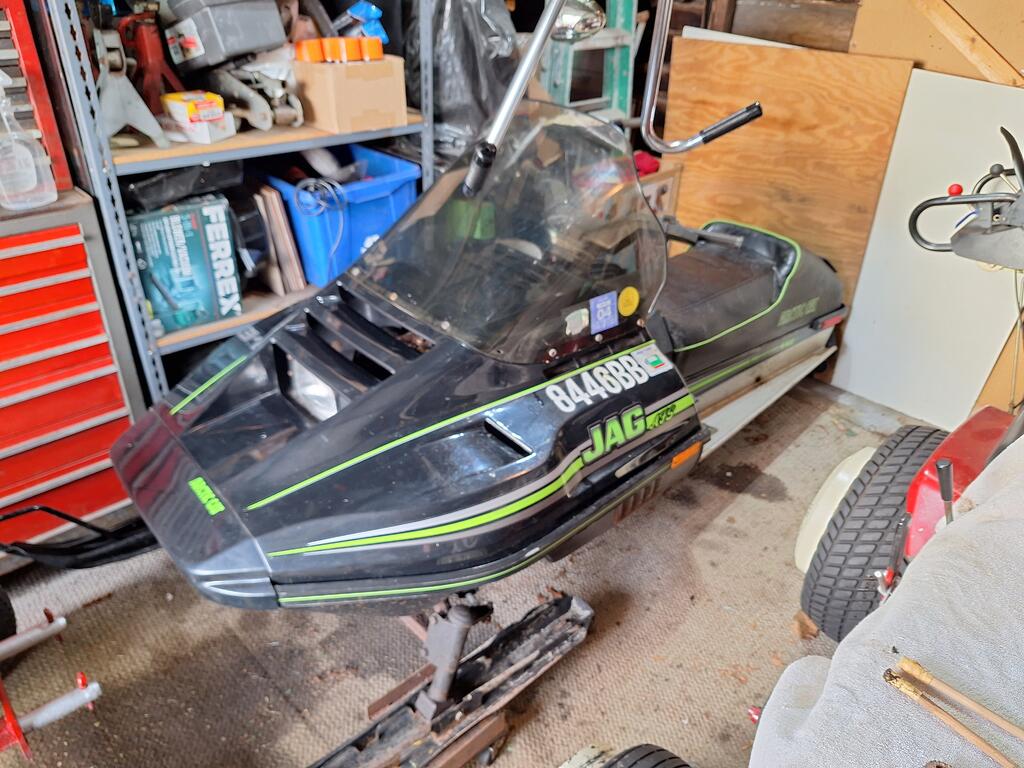

D_Mac 9,333 #3 Posted May 20, 2025 (edited) So when I got it home I checked for spark at the plug. No spark. Checked all wires for possible mice chewing all looked good. I watched a bunch of videos on YouTube. They say pull the plug where the stator wires come out of the engine and make a little jumper wire to bypass two other wires. If you then get a spark the issues is in the switches on handle bars not electrical on the engine. So I did that and got spark. So now I know problem is in the kill button, key switch. Throttle safety switch, handwarmers. According to the video the machine will run with the jumper but to kill it you have to pull your jumper wire. So the tank was empty, there was oil in the jug. I had already broke the choke cable by accident so the choke is stuck off. I poured some gas in it. Blew into the tank. The fuel filter filled with gas. Gave it like 20 pulls. Got excited when it fired so I set phone down. It's a runner !!! 20 years later. 20250519_191650.mp4 Edited May 20, 2025 by D_Mac 4 5 1 Share this post Link to post Share on other sites
