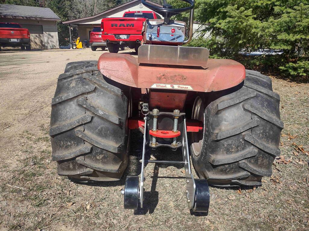

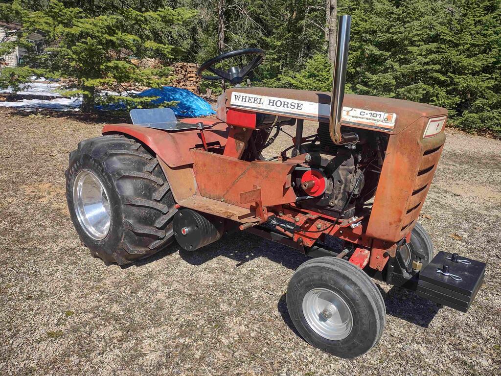

Achto 32,728 #2 Posted May 18, 2025 My pulling tractor "Horse Apples" This tractor is made from many tractors. C-101,Raider 12, 1257, etc. Engine is a "stock'ish" K321 from a Quiet Line Cub Cadet. Tins on it are from the K241 that was removed from the tractor. Hand made F-plate re-enforcement also holds the mid mounted weights. Custom extendable weight bracket on the front will move the weight 2ft out in front of the tractor. Rear fender pan raised 1/2" to make room for the 26x12x12 tires on the back. Brake peddle converted to a gas peddle. Let's not forget the comfy bare aluminum seat. Custom stainless dash that narrowed things down to the bare necessities, toggle switch for ignition, starter button and choke knob. Custom hitch with adjustable height. Wheelie bars to keep the front down to a safe height. A tether switch that is tied to the eliminator. If my tractor should come unhooked the tether will be pulled killing the ignition and fuel pump. 6 4 Share this post Link to post Share on other sites

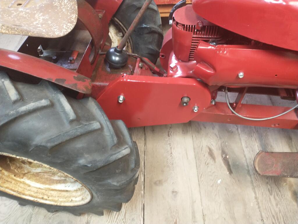

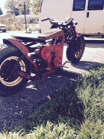

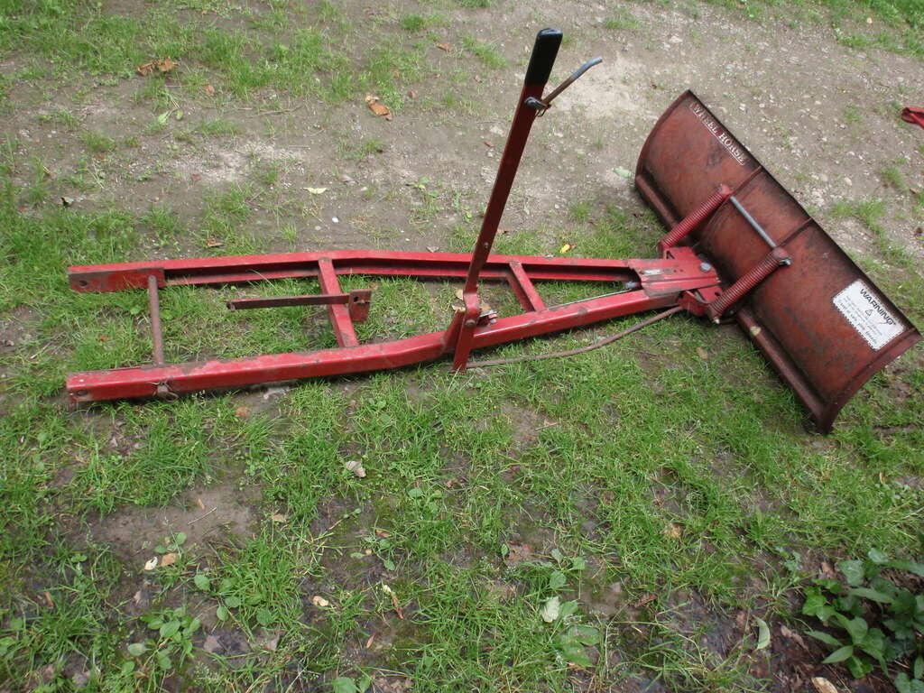

wallfish 20,618 #3 Posted May 18, 2025 Oh boy. Does this count? Turned a snow blade into this with a few tractor parts. 5 6 3 Share this post Link to post Share on other sites

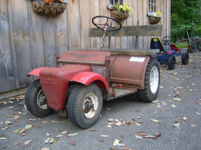

wallfish 20,618 #4 Posted May 19, 2025 And here's the blade part! LOL 4 6 2 Share this post Link to post Share on other sites

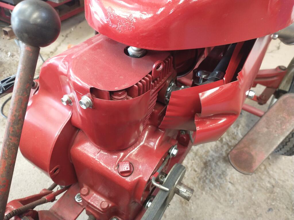

squonk 48,127 #7 Posted May 19, 2025 (edited) Cents @WHX?? calls me a "sally" I decided to quit burning my leg on my Suburban and fabbed up a 2nd Air Gap exhaust pipe shield. Works pretty slick keeping the drumstick from getting over done! And Sense I don't want said drumstick ground into Chicken Salad. I fabbed a belt guard out of another tractor guard that made a few trips up and down the East coast! Edited May 19, 2025 by squonk 4 6 Share this post Link to post Share on other sites

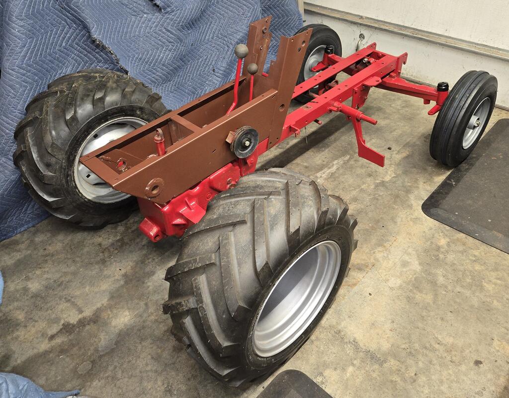

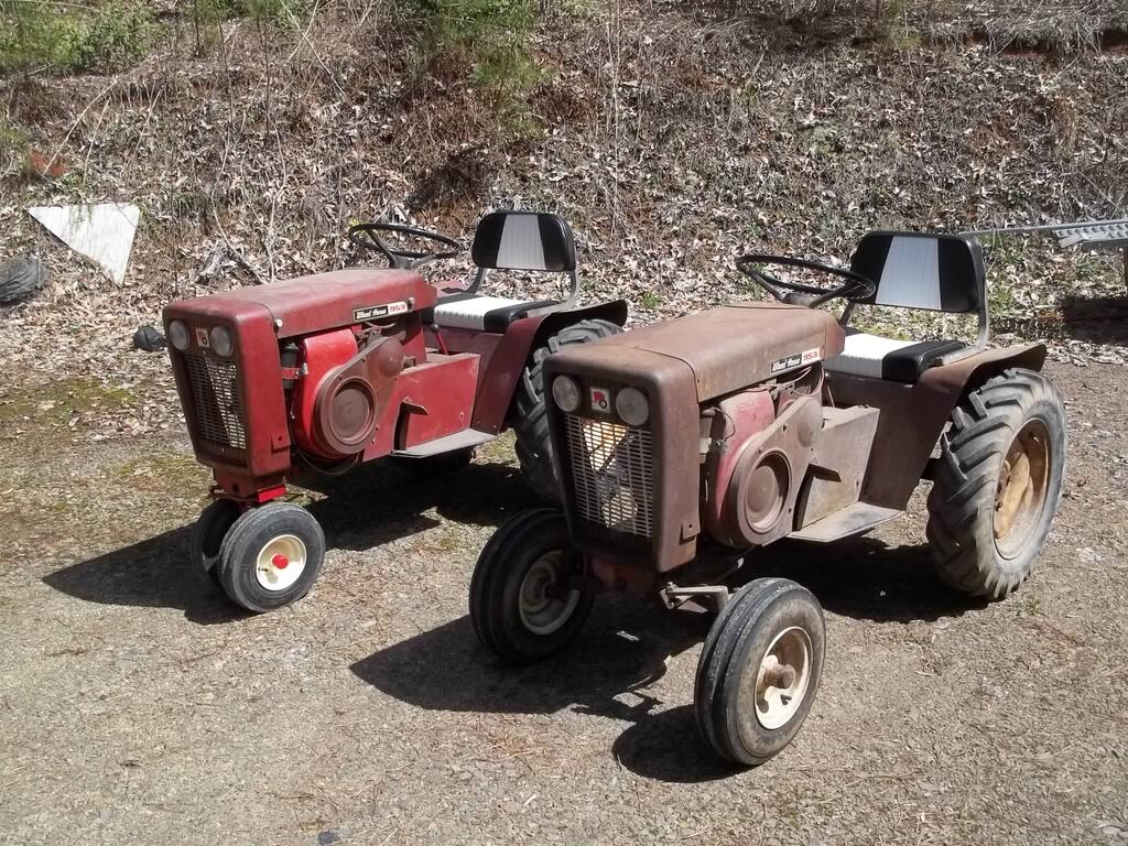

953 nut 69,351 #8 Posted May 19, 2025 I have a 953 that received the "Row Crop" narrow front end treatment and a three point hitch. 5 4 Share this post Link to post Share on other sites

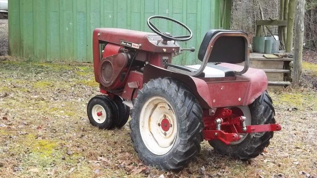

Lee1977 7,772 #10 Posted May 21, 2025 (edited) My C-120/180 - 8 bought it new in 1977 was my main mowing tractor for years. It was slowly transformed over the years as parts wore out. It has 3500# front axles hubs and 6ply 16 x 6.50 x 8 tires and 5 lug wheels. Then went to 1/2" heims joints on the tie rods. Rebuilt the axle pivot with over sized pin and thicker bushing in the front hitch. Next was a 16 HP Briggs Vanguard that I went off a bank and broke the oil pan, had that welded used it for another few years until it open a crack and I didn't check it in time. Some where 90's I busted a bearing in the transmission and replace all the bearing in it. The steering was up graded to the lower shadt with the 3/4"nut and cotter pin.. 2010 I replaced it with a 18 Briggs Vanguard. The PTO lever shaft and the Clutch shaft I installed brass bushings. There is also a frame brace. Edited May 21, 2025 by Lee1977 3 1 Share this post Link to post Share on other sites

kpinnc 18,969 #12 Posted May 21, 2025 On 5/19/2025 at 8:25 AM, 953 nut said: I have a 953 that received the "Row Crop" narrow front end treatment and a three point hitch. I've never owned a 953/1054 just because they don't share much with other models. There was one for sale here a few years ago. Your trike makes me wish I'd bought it. It looks really good like that. 1 Share this post Link to post Share on other sites
