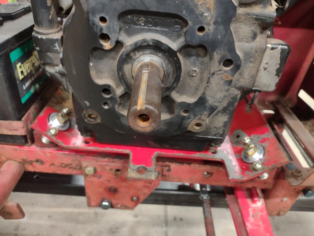

Mike'sHorseBarn 3,601 #1 Posted May 16, 2025 (edited) I got these aluminum isolators from lowell and nothing is even close to lining up. I can get one bolt to go in. The opposite side of the engine of off by a mile. Do I Have them in backwards or what's the deal? Edited May 16, 2025 by Mike'sHorseBarn Share this post Link to post Share on other sites
oliver2-44 11,632 #2 Posted May 16, 2025 Yes, you have that one upside down. They can be a bit of a challenge to install. If you're not pulling the belt guard, start with the right rear one. It can still be a challenge. Loosen all the old one up, install the new ones loosely, then tighten them all up. 2 1 Share this post Link to post Share on other sites
WHX?? 57,448 #3 Posted May 16, 2025 (edited) 13 minutes ago, oliver2-44 said: t can still be a challenge Mine flew right in Ollie. Took longer to take the belt guard and pto off. @Achto did you install yours that we got from @Shynon? Maybe try flipping them around Mike. Thinking that would make the plate sit lower on the wedge blocks. Edited May 16, 2025 by WHX?? 1 Share this post Link to post Share on other sites
Achto 32,096 #4 Posted May 16, 2025 (edited) 12 minutes ago, WHX?? said: @Achto did you install yours that we got from @Shynon? I installed one set on Horse Apples. Had the engine completely out though. Wasn't trying to install without removing the engine. It does help if you loosen the brackets that bolt to the frame. Every thing loose until all the bolts are started, then tighten. Edited May 16, 2025 by Achto 3 Share this post Link to post Share on other sites
WHX?? 57,448 #5 Posted May 16, 2025 Zoom in on his flange bolts Mike... Dan's using his nuts... I remember Tom saying he didn't like the ones he gave us cause the flanges weren't threaded. 1 Share this post Link to post Share on other sites
Mike'sHorseBarn 3,601 #6 Posted May 16, 2025 56 minutes ago, oliver2-44 said: Yes, you have that one upside down. I have the whole engine out, nothing is connected to it. I thought the flat side went toward the v block? 46 minutes ago, WHX?? said: Maybe try flipping them around Mike. Thinking that would make the plate sit lower on the wedge blocks. That's what im gonna try tomorrow. Share this post Link to post Share on other sites
ri702bill 12,496 #7 Posted May 16, 2025 6 hours ago, Achto said: It does help if you loosen the brackets that bolt to the frame. Every thing loose until all the bolts are started, then tighten. Absolutely loosen the triangular frame blocks and start all the bolts before tightning. I raised the engine to allow removal and instattation easier. I purchased mine used and noticed that 2 of them has threads partially cut into the ID. I opened up the ID of all four to the next drill size to clean that out - that helps too.... 1 1 Share this post Link to post Share on other sites
WHX?? 57,448 #8 Posted May 19, 2025 Any luck yet Mike? Share this post Link to post Share on other sites
Mike'sHorseBarn 3,601 #9 Posted May 19, 2025 3 hours ago, WHX?? said: Any luck yet Mike? Yep got em in Saturday morning. I tried flipping them upside down, no dice, I tried putting the flange topside, still no dice. I finally just elongated the holes to the rear and then I got it. Share this post Link to post Share on other sites
WHX?? 57,448 #10 Posted May 20, 2025 That's just bizarre they didn't fit. Did you talk to Lowell or Tom? Share this post Link to post Share on other sites
Mike'sHorseBarn 3,601 #11 Posted May 20, 2025 9 hours ago, WHX?? said: That's just bizarre they didn't fit. Did you talk to Lowell or Tom? Yea I talked to lowell and he suggested flipping them around too. They measure just about the same as rubber ones too so I have no idea what the problem is. I guess the rubber ones just had some give so you could line up the holes. Share this post Link to post Share on other sites
