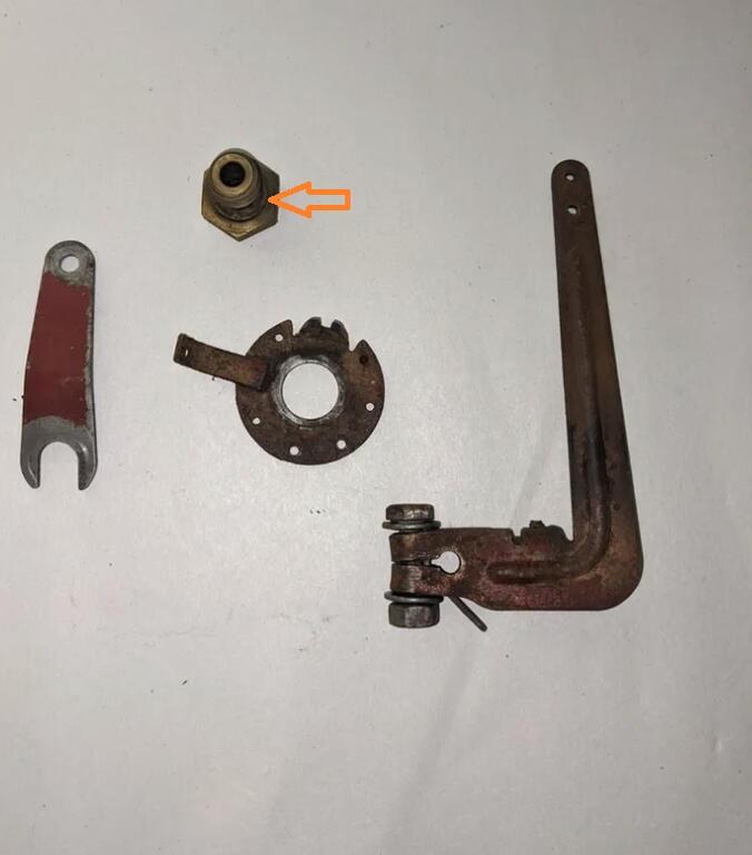

Achto 32,347 #9 Posted May 12, 2025 6 hours ago, 1968Commando said: can I get a picture of this I’m having a hard time imagining this in my head The wheel fits over this step ring on the nut by the orange arrow. The face of this step ring tightens against the throttle cable bracket to hold it in place. 1 1 Share this post Link to post Share on other sites

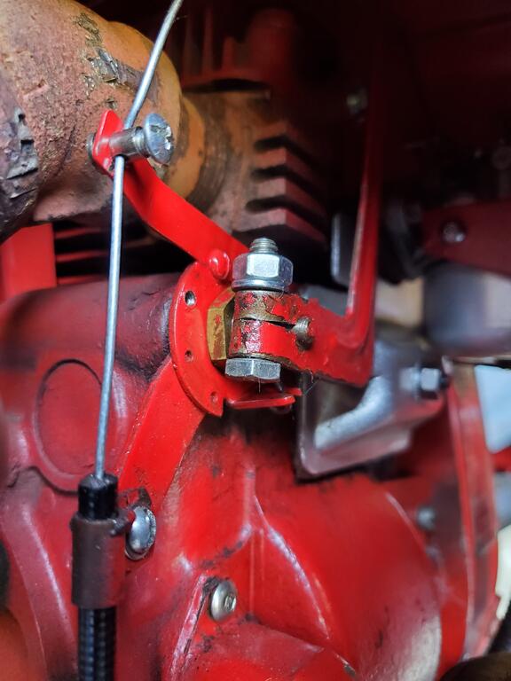

Achto 32,347 #10 Posted May 12, 2025 6 hours ago, 1968Commando said: also on my wheel I have a stud does that go above or under the throttle cable bracket? Are you referring to the stud by the white arrow? It looks correct in this pic. Share this post Link to post Share on other sites

1968Commando 189 #12 Posted May 12, 2025 (edited) 1 hour ago, Achto said: Are you referring to the stud by the white arrow? It looks correct in this pic. Yes I am, ok I guess it’s correct then Edited May 12, 2025 by 1968Commando Share this post Link to post Share on other sites
1968Commando 189 #13 Posted May 12, 2025 1 hour ago, Achto said: The wheel fits over this step ring on the nut by the orange arrow. The face of this step ring tightens against the throttle cable bracket to hold it in place. Ok i actually had my throttle and governor assembly installed like you said and it’s on the step and stuff but it still dosent work right nothing moves like it should at all Share this post Link to post Share on other sites
