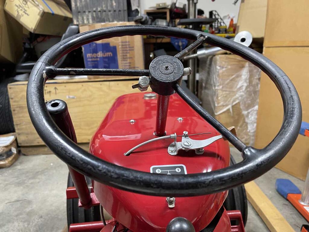

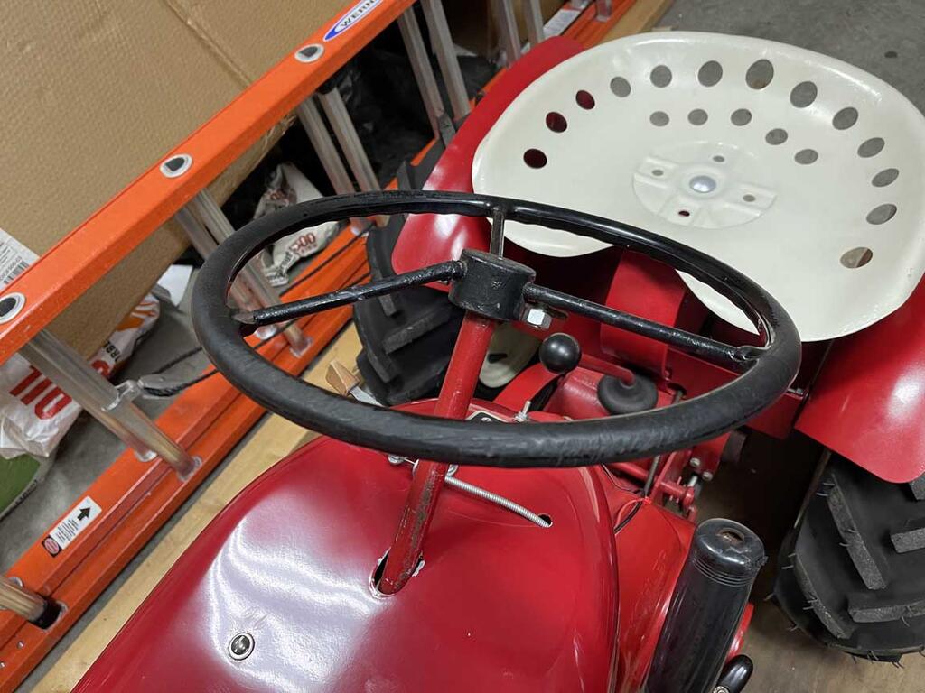

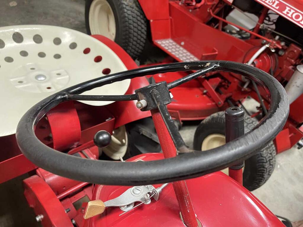

Rich16 44 #8 Posted May 7, 2025 Pix of bent steering wheel to Wallfish - and forgot to answer - the steering rod is not bent. I think while I was holding onto the steering wheel as it went down I never let go - and the weight fell on me and bent as I tried to hold the whole thing up off the pavement - don't think it ever hit the pavement and definitely spared a much worse outcome. 5 Share this post Link to post Share on other sites
Achto 32,739 #9 Posted May 7, 2025 (edited) If worse comes to worse you can purchase an early Cub Cadet steering wheel. You will have to drill the center out to 3/4" and drill a hole cross ways for the roll pin. Other than these alterations to the center hub they are an exact match. https://www.amazon.com/Reliable-Aftermarket-Parts-Name-Says/dp/B07BBWR8BS?gQT=1 Edited May 7, 2025 by Achto 4 3 Share this post Link to post Share on other sites
SylvanLakeWH 32,545 #10 Posted May 7, 2025 Why not try bending it back? Maybe two wood boards one on either side of the spoke(s) for leverage? 3 Share this post Link to post Share on other sites

wallfish 20,618 #12 Posted May 8, 2025 You can try some heat and bending it back but getting it flat/straight is another story if the outer circle of the wheel is bent. I would certainly give it try and then fill/shape the scratches broken plastic with epoxy like JB weld and paint. If it doesn't meet satisfaction after bending it back, buy one. 2 Share this post Link to post Share on other sites

oliver2-44 11,753 #19 Posted May 9, 2025 (edited) Those are 2 great tractors. Blah you were not hurt, but I bet you were sore the next day. As mentioned you can repair the black material on the steering wheel with JB Weld. When mixing it I spray some black paint in it. I tape either side of a crack to reduce cleanup. I use a file to work it close, then final sanding. Edited May 9, 2025 by oliver2-44 1 Share this post Link to post Share on other sites

Rich16 44 #22 Posted May 9, 2025 Absolutely can't thank everyone's help and comments enough - got a new handle grip ordered (thanks 953 nut!!) and am going with one of the steering wheel options suggested - amazing how there are so many possibilities this many years later - terrific. Yeah, I've never had a problem with humility - always told folks 'there are no stupid questions', etc, etc and if you're not doing something stupid you're probably not having enough fun Many many thanks again all!!!! 2 2 Share this post Link to post Share on other sites
