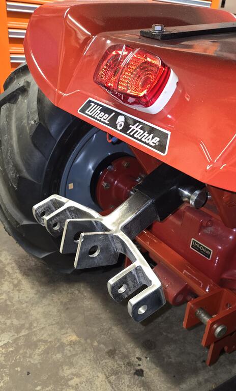

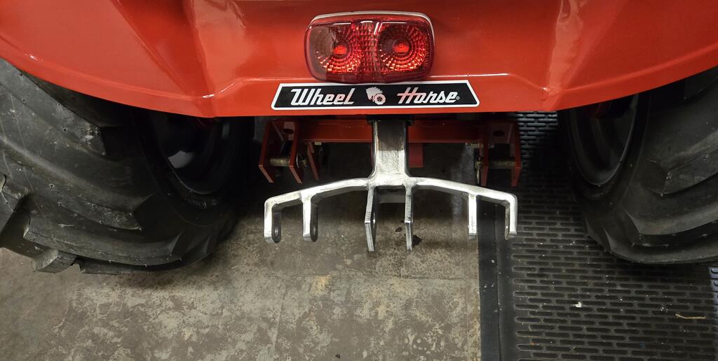

kpinnc 18,771 #153 Posted October 30, 2025 My 3 point drag links and lift arms are from another brand machine... I only had one set of WH arms, and they are in my Bronco. Nothing I can do about that. Sometimes you gotta work with what you have. But they'll look like this, just painted red. 1 1 1 Share this post Link to post Share on other sites

kpinnc 18,771 #155 Posted October 30, 2025 38 minutes ago, "Manic-Mechanic" said: They’ll work! I had a pair sitting here, asked you if you had a set, off a D. Yeah the D series are much nicer in my opinion. The bends on them definitely work better in a small space. But these will work. Since the rest will be fabricated (minus the lift arms)- they'll still look somewhat custom. 2 1 Share this post Link to post Share on other sites

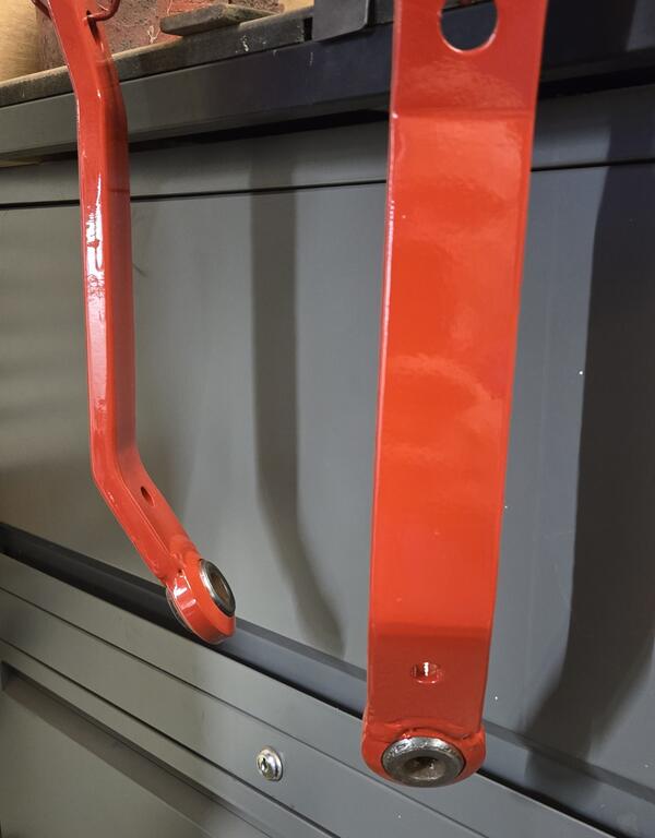

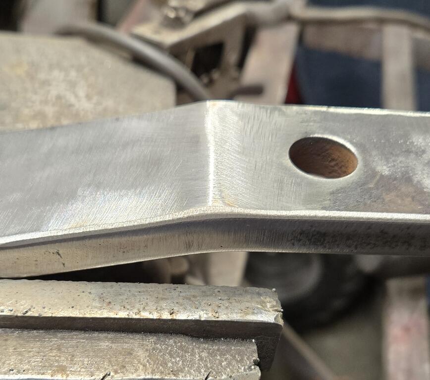

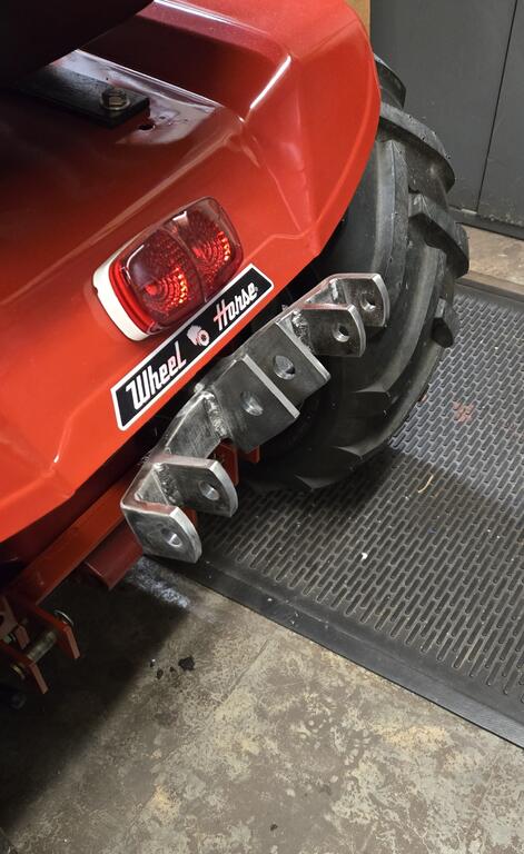

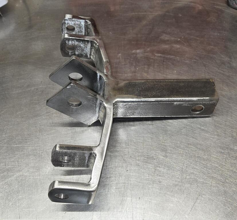

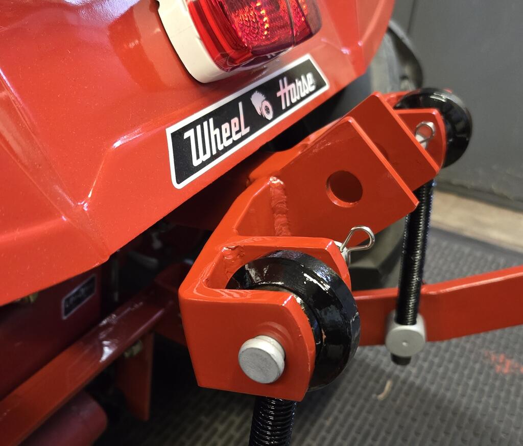

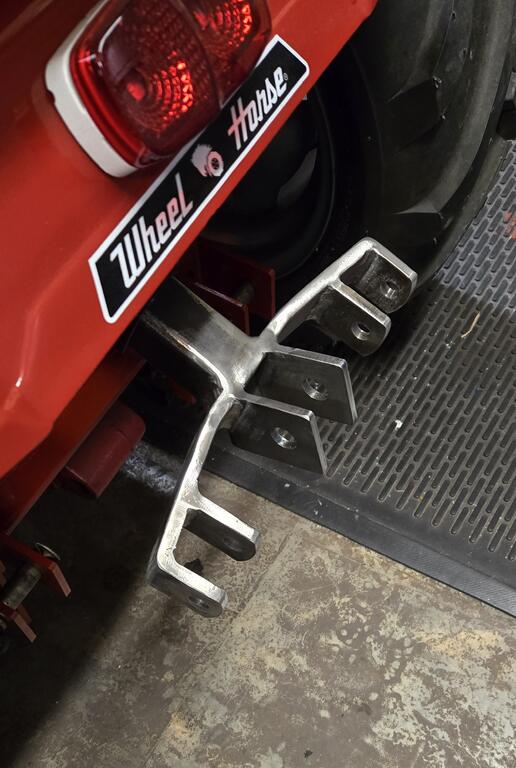

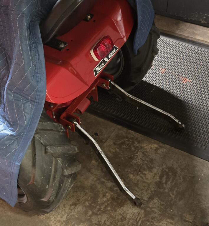

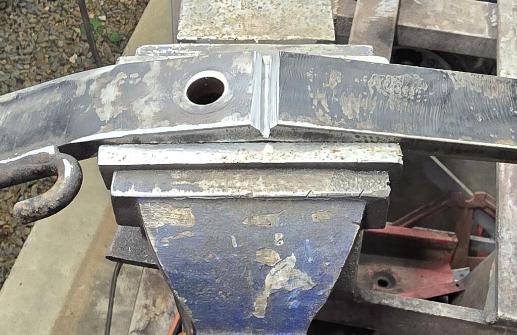

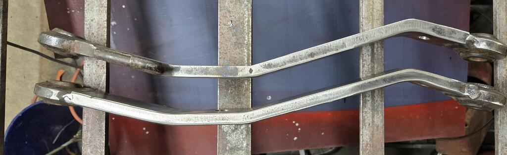

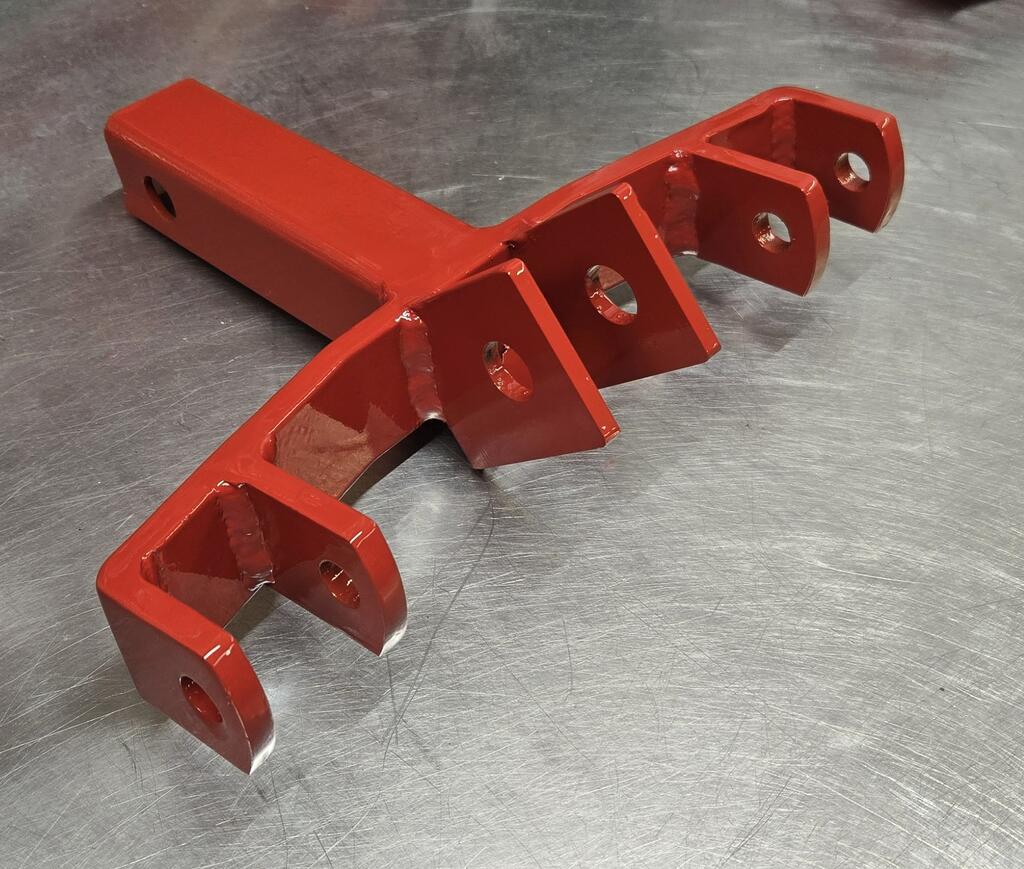

kpinnc 18,771 #157 Posted November 2, 2025 Finished fabbing the 3 point parts today. I think it'll work OK. Testing will have to wait for my top link, and it's delayed per tracking until next week. Anyway... Don (Lee1977) came by today, and dropped some common sense on me. I've grumbled about the drag links for a while because I just don't like how narrow they are due to the tiny bends in them. My acetylene torch is broken and nothing else will get hot enough to bend the 3/8 steel arms. Don suggested cutting them almost all the way and bending them to whatever I want and weld them back. As he said, nothing I can possibly pull with a 500lb tractor will break them. They turned out nice and the pic below is the top of one and the bottom of the other- just comparing to make sure they are the same now. I also fabbed up the top part of the hitch. Both lift links and top link will connect to it. And it installs with a 5/8 pin just like the drag links. It will be quick to remove and reinstall. Full up and down clear everything and still give decent amount of lift. It actually turned out pretty good. And finally a dash of red makes it look better, so tomorrow will be assembly and initial testing. 2 9 Share this post Link to post Share on other sites

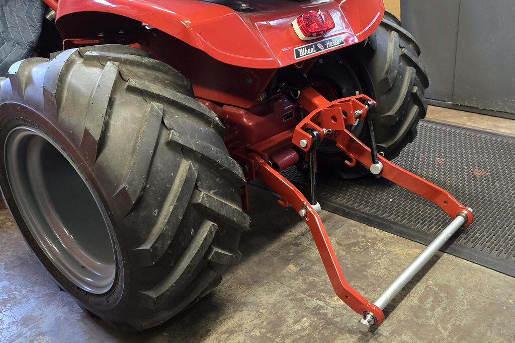

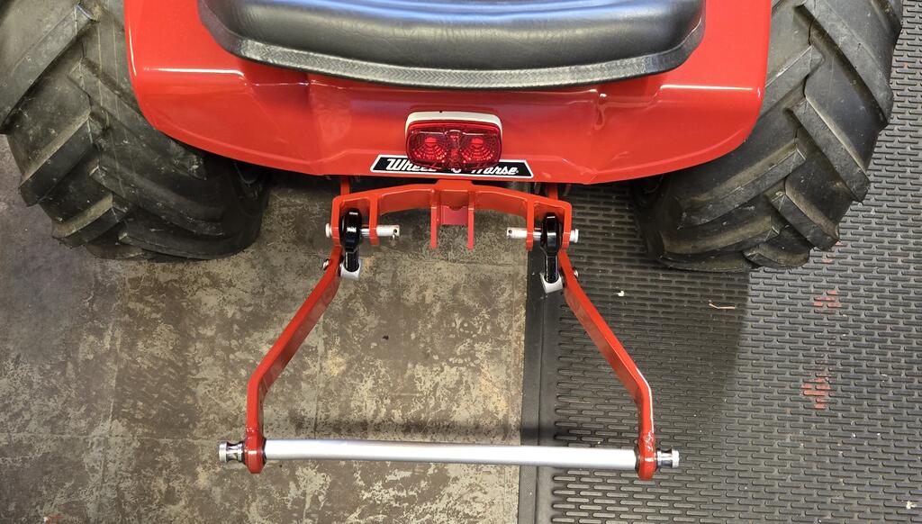

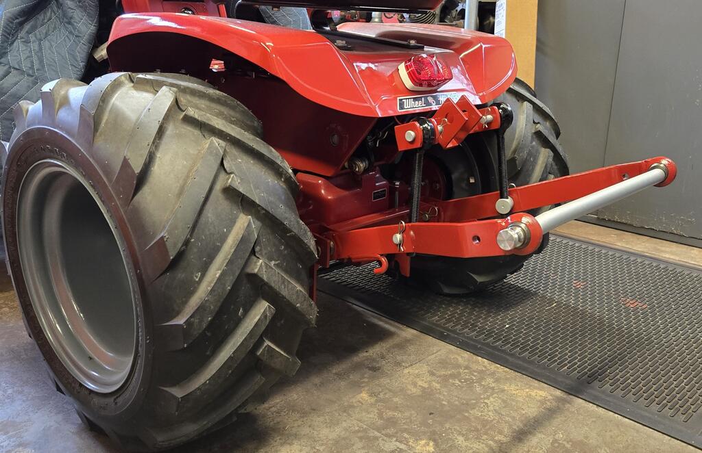

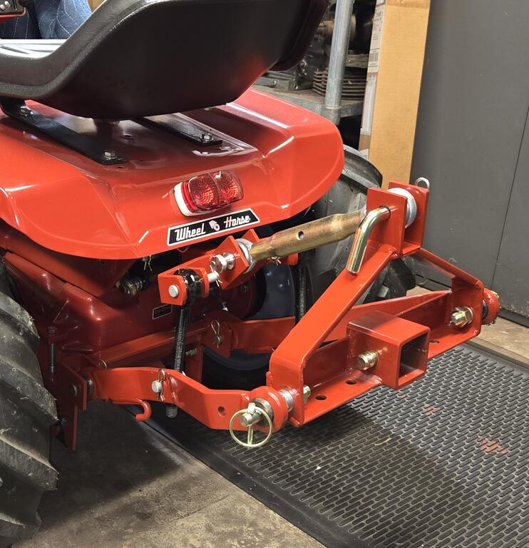

kpinnc 18,771 #158 Posted November 2, 2025 (edited) Here is the completed hitch. Forgive the aluminum tube but my top link isn't here yet so it's just to hold the drag links out... Full travel- needs adjusted up some but that's easy. Is very smooth. I was afraid it would be hard to lift empty but it's like nothing is even back there. And I'm really glad I listened to Don and changed the drag links. They look much better and have more sway travel. Edited November 2, 2025 by kpinnc 1 9 Share this post Link to post Share on other sites

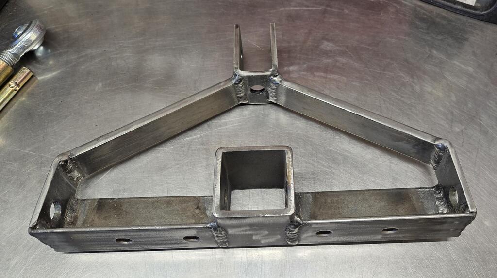

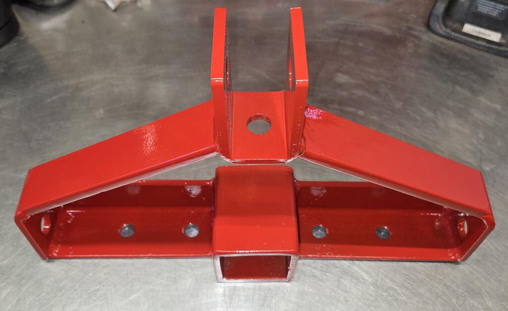

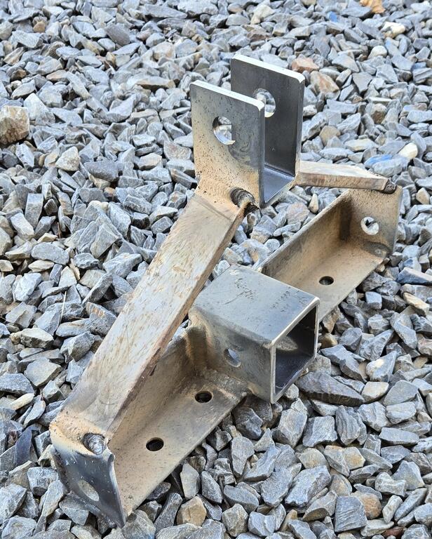

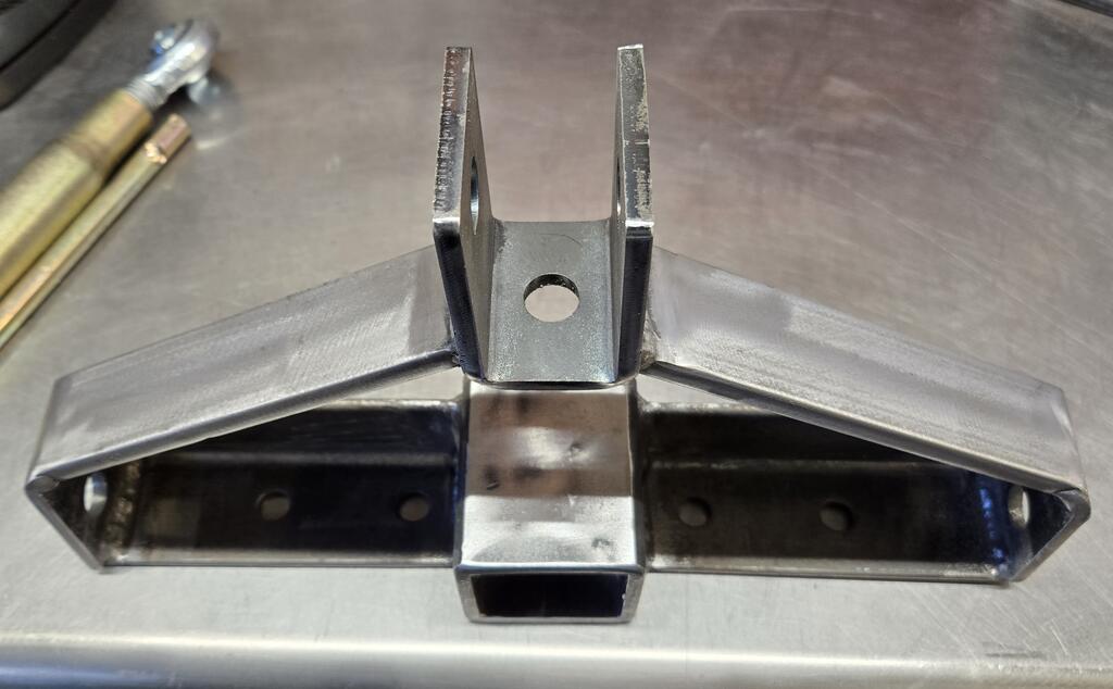

kpinnc 18,771 #159 Posted November 3, 2025 Well my top link showed up today, so I fabbed up my A frame hitch reciever during lunch. It's shorter than the one I made for the Bronco but that was on purpose. The top link connects much closer to the drag links on this tractor, hence the shorter frame. Cleaned up and painted. Now I need to go get some CAT 0 standoffs for it and this one is actually finished. ...until I think of something else. 6 Share this post Link to post Share on other sites
"Manic-Mechanic" 1,485 #160 Posted November 3, 2025 33 minutes ago, kpinnc said: Well my top link showed up today, so I fabbed up my A frame hitch reciever during lunch. It's shorter than the one I made for the Bronco but that was on purpose. The top link connects much closer to the drag links on this tractor, hence the shorter frame. Cleaned up and painted. Now I need to go get some CAT 0 standoffs for it and this one is actually finished. ...until I think of something else. Nice little A-frame! Becomes addictive, today an a frame, tomorrow? 1 1 1 Share this post Link to post Share on other sites

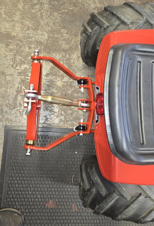

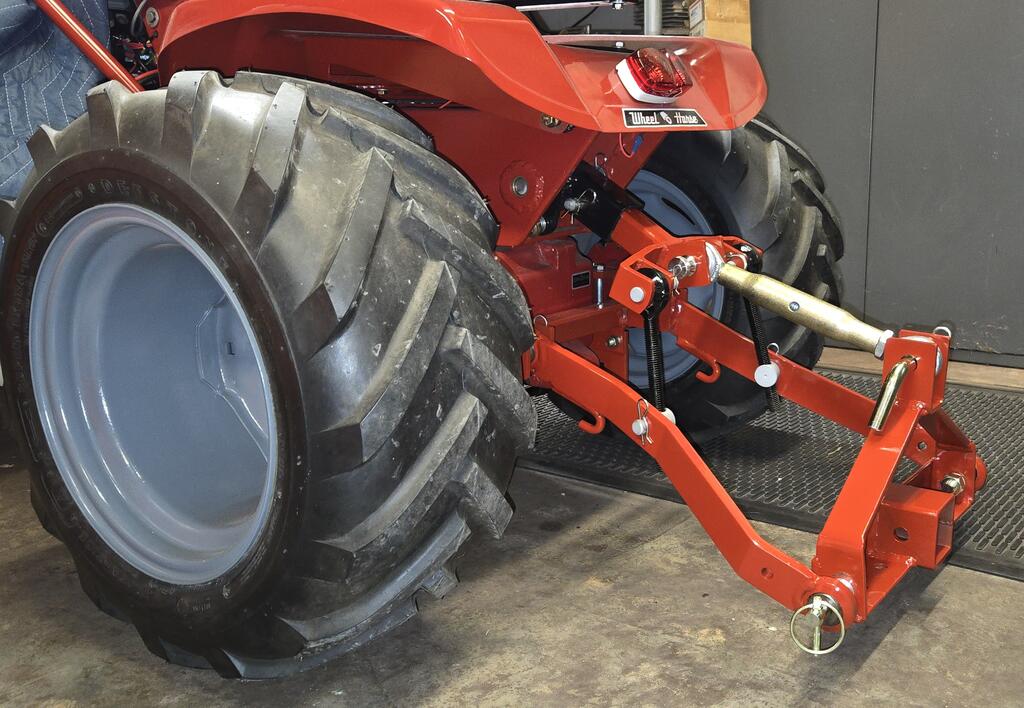

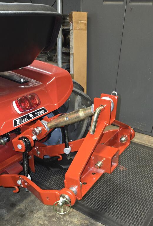

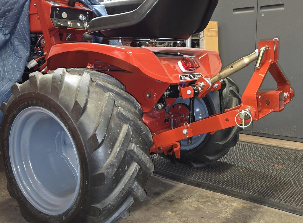

kpinnc 18,771 #163 Posted November 4, 2025 2 hours ago, "Manic-Mechanic" said: I got a nickel every time I said that! I would be a wealthy man... Well, here is the finished product. This thing has great range, but I'm certain it will be fairly light implements only since it's a "Popeye assisted lift" instead of hydraulic lift. But it's very smooth and I really like it. This tractor isn't set up for only a 3 point, but rather it's just one of the options. It will still work with all the traditional slot/ clevis hitches as well as the standard tiller and anything that connects to the rear axle hitch. Maybe I can get back to my 701 in the next couple weeks... I still need to make up a stop for the hood, but I'm calling this one done since that's a simple mod. 1 5 Share this post Link to post Share on other sites
"Manic-Mechanic" 1,485 #164 Posted November 4, 2025 I give it a “simply outstanding!” 1 Share this post Link to post Share on other sites
kpinnc 18,771 #165 Posted November 4, 2025 6 minutes ago, "Manic-Mechanic" said: I give it a “simply outstanding!” Greatly appreciated! This one has been the most work so far as fabrication since the Bronco 3 point. But it works well and looks good. This tractor will be able to do alot of different tasks, which was the point of building it to begin with. 1 1 Share this post Link to post Share on other sites
"Manic-Mechanic" 1,485 #166 Posted November 4, 2025 Just now, kpinnc said: Greatly appreciated! This one has been the most work so far as fabrication since the Bronco 3 point. But it works well and looks good. This tractor will be able to do alot of different tasks, which was the point of building it to begin with. I love a horse, but it must have a function as a true “garden tractor”. So yeah, any mods that enable the machine to do more is phenomenal 1 1 Share this post Link to post Share on other sites
ineedanother 2,649 #167 Posted November 4, 2025 That's a beautiful machine @kpinnc. I'm in awe of it all but the engineering from the hoodstand through the hitch is just fantastic. Share this post Link to post Share on other sites
kpinnc 18,771 #168 Posted November 4, 2025 11 minutes ago, ineedanother said: That's a beautiful machine @kpinnc. I'm in awe of it all but the engineering from the hoodstand through the hitch is just fantastic. Thank you very much. Most of the "head scratching/ staring for hours" parts were done years ago on the Bronco, so a great deal was just repeating the process with small upgrades. 2 Share this post Link to post Share on other sites

Handy Don 17,038 #171 Posted November 4, 2025 On 11/2/2025 at 4:15 AM, kpinnc said: cutting them almost all the way and bending them to whatever I want and weld them back I had someone show me this trick just as I was learning welding and I’ve used it several times on both bars and rods. 3 Share this post Link to post Share on other sites
