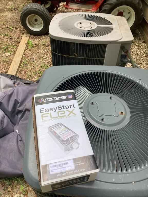

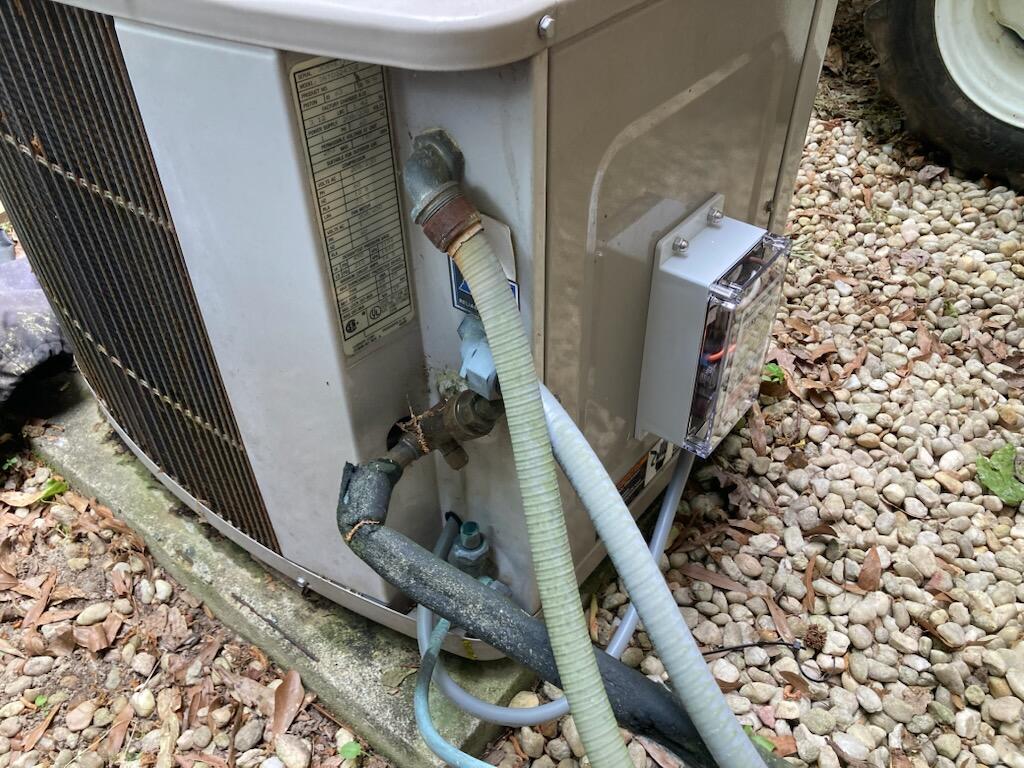

ineedanother 2,498 #1 Posted April 26, 2025 Doing some prep work to install a whole house genny. My diesel 7.5kW does fine when I'm home but I really can't expect my wife to run it given that it's back-fed with a lockout and I have to alternate the a/c units because it just won't run them both. So I finally got around to checking the inrush amps on my a/c units and was a bit shocked to see that the older unit was drawing over 80 LRA. Holy crap. No wonder I can't run them both. Anyway, even with the 12kW I'm installing that would be too much. The other unit draws 30.5 LRA which is a good bit but 80 is off the chart for me. They both run on less than 10A but I have to get them started without bogging or worse, stalling or even killing the generator. So I installed a soft starter on the older unit. About a 45 minute job and the device cost just under $400 which is nothing to sneeze at. But to my surprise, it's now pulling just under 10 LRA on startup! It starts smoothly now too which may or may not extend it's life but I think it almost has to. We'll see. 2 2 Share this post Link to post Share on other sites

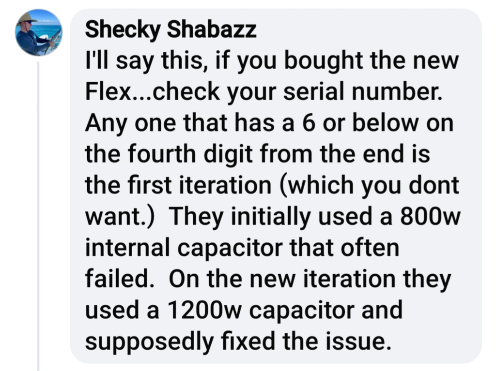

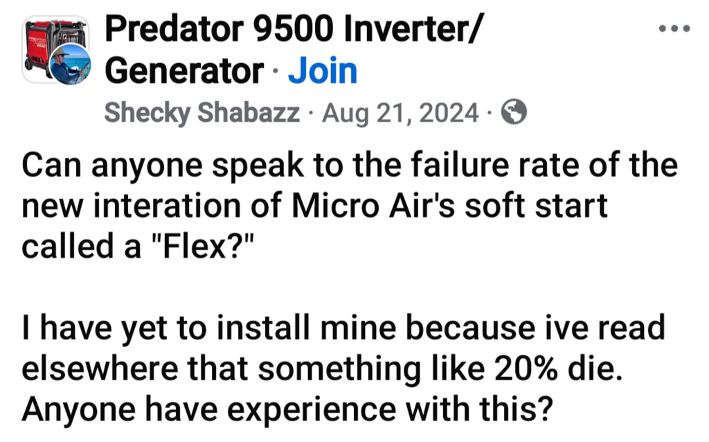

HyperPete 939 #3 Posted April 27, 2025 I was planning to buy one of these, same brand, when I bought my new generator severalonths ago. The micro-air were all the rage, with the wifi monitoring. Unfortunately, they haven't lived up to expectations. One run, in particular, has an extremely high failure rate. I will try to find details from the FB generator groups I'm in. Share this post Link to post Share on other sites
ineedanother 2,498 #4 Posted April 27, 2025 3 minutes ago, HyperPete said: they haven't lived up to expectations. One run, in particular, has an extremely high failure rate. Interesting...I read quite a bit before committing to this so I'm curious...Sources?... Share this post Link to post Share on other sites
HyperPete 939 #5 Posted April 27, 2025 1 minute ago, ineedanother said: Interesting...I read quite a bit before committing to this so I'm curious...Sources?... Let me get the links for you. Hopefully it's just that one run. Share this post Link to post Share on other sites
HyperPete 939 #6 Posted April 27, 2025 https://www.facebook.com/groups/1716967438485868/?ref=share&mibextid=NSMWBT https://www.facebook.com/groups/1434785350530510/?ref=share&mibextid=NSMWBT https://www.facebook.com/groups/1638906663069796/?ref=share&mibextid=NSMWBT https://www.facebook.com/groups/1226861290686292/?ref=share&mibextid=NSMWBT https://www.facebook.com/groups/766087290718076/?ref=share&mibextid=NSMWBT https://www.facebook.com/groups/103931416346061/?ref=share&mibextid=NSMWBT I was in several other groups, too, but I left some after choosing my generator. I think mine can handle my A/C without soft start, and if it can't, then I will deal with it at that time. Share this post Link to post Share on other sites
