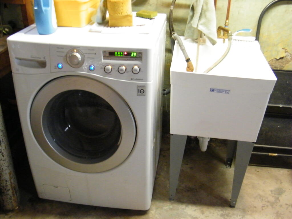

stevasaurus 23,892 #5 Posted April 22, 2025 They really are not hard to work on. Ours was like 12 years old...which means it is not worth having a guy come and fix it. I watched the videos, some also showed the kit I would need. I took a chance and ordered the parts, they were correct. Take pictures and keep parts seperate. It runs like brand new and it's been 2 years now. That little door on the bottom left of my picture has my pump in it. There is a valve there you can open to empty the water in the drum. You just may need to clean the pump or hose out. 2 Share this post Link to post Share on other sites

ri702bill 13,394 #8 Posted April 22, 2025 1 hour ago, stevasaurus said: There is a valve there you can open to empty the water in the drum. You just may need to clean the pump or hose out. I have a similar LG hE washer. the removable lint filter is behind that little door. It needs regular cleaning to remove lint buildup that CAN bind up the pump - ask me how I know.... 1 1 Share this post Link to post Share on other sites
