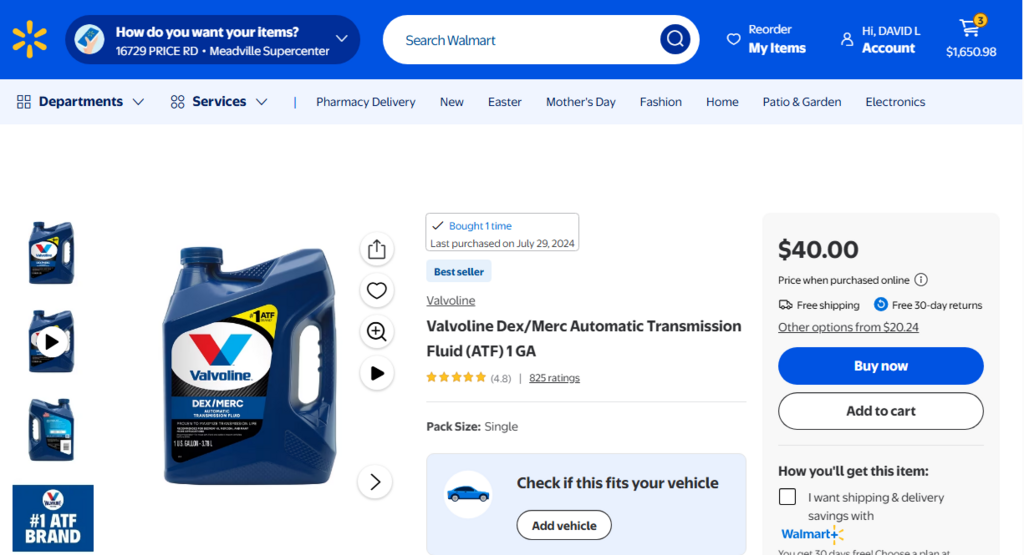

mrc 1,122 #1 Posted April 18, 2025 hi men, i am working on an old bronc 14. the tranny dipstick is red. so it has ATF in it. back in those days there were only 2 types of ATF. type F for fords and type A was dextron for the GM vehicles.. what type of modern ATF should go in the bronco tranny? thank you mike Share this post Link to post Share on other sites
daveoman1966 3,885 #2 Posted April 18, 2025 (edited) I hav ethe same Bronco 14. Use Dex/Merc from Walmart. DO NOT use some store-brand name. get the REAL VALVOLINE product. Edited April 18, 2025 by daveoman1966 4 Share this post Link to post Share on other sites
