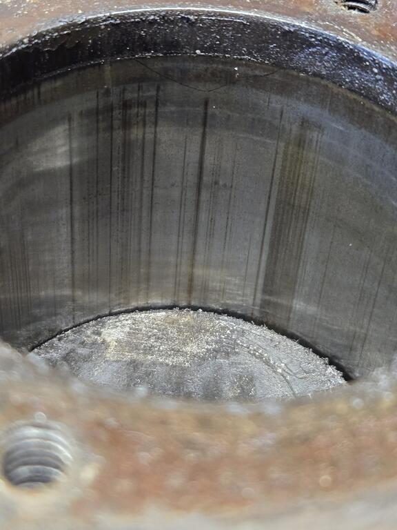

kpinnc 19,002 #1 Posted April 16, 2025 I seem to recall some discussion of using a K181 piston on a K161 a while back but can't find it. Has this been done before? I'm trying to decide the next course of action on my K161, as it needs some love on the bore. I'm not a huge fan of aftermarket internal Kohler engine parts. Mine has scratches that aren't deep enough to hang a nail, but they won't dissappear with a hone either. Anyway, if someone has done this before, let me know. I have a donor K181 that I can steal a piston from. Of course I'll get new rings. Share this post Link to post Share on other sites

squonk 48,207 #4 Posted April 16, 2025 Yes. Stroke differences. And if those marks won't clean up, I'd be skeptical that the rings would seal well. I Save Tractors sells decent aftermarket, piston, rings and gasket sets. Share this post Link to post Share on other sites

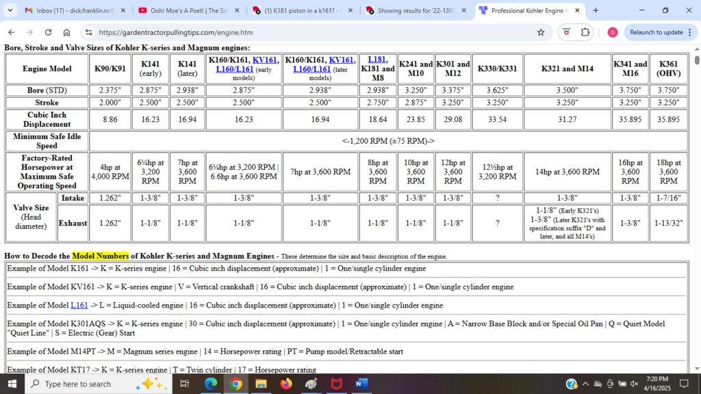

953 nut 69,724 #6 Posted April 16, 2025 This handy chart should help. 2 Share this post Link to post Share on other sites

kpinnc 19,002 #9 Posted April 17, 2025 4 hours ago, ri702bill said: What year K161?? 1961 & 62 blocks were small bore versions. 1963 & later the K161 has the same bore as the K181. So theoretically my 1961 K161 should have .063 to play with on the bore if I used a standard K181 piston? I verified mine does have the smaller bore. First mic checks were between 2.875 and 2.876. At least that's what the chart below says since later K161 and K181 had the same 2.938 bore... The stroke was the same on both versions of the K161. Of course this is all preliminary. I haven't looked at anything beyond the bore. @Achto Thanks for the link. I will definitely check the seller out. 2 Share this post Link to post Share on other sites

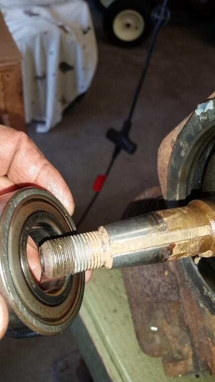

kpinnc 19,002 #13 Posted April 17, 2025 (edited) 1 hour ago, WHX?? said: Why is that KP? Well at this point it's just guesswork. I hope to disassemble the engine over the weekend and see what is what. So long as the bore is all that needs attention? It's golden. The donor K181 came from a very old generator and has a 1 inch long, partially tapered crankshaft. The engine is unsuitable for any normal application on a Wheel Horse. I'll need to take it apart as well and verify the parts I need are in spec. If not, I'll have no choice but to go aftermarket. There is a local engine shop that I've used before as well. They do exceptional work and in the past at least the prices were good. I just take the block (valve train intact) and they bore and hone the cylinder to spec and grind the valves and seats. Makes for a plug and play reassembly. Of course I'm at the beginning of this. What I find inside the K161 will determine what I do. Edited April 17, 2025 by kpinnc 1 Share this post Link to post Share on other sites

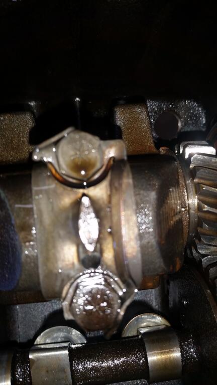

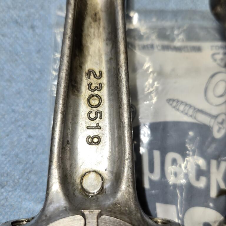

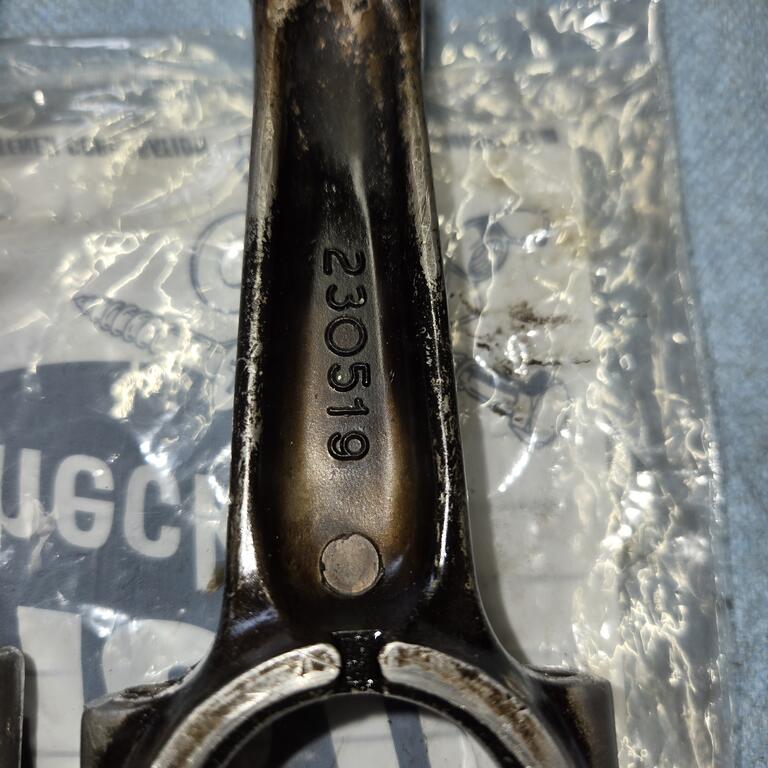

kpinnc 19,002 #14 Posted April 23, 2025 (edited) Oh boy what a mess this has become in short order... I'm not sure what the "early/ late" year was for sure, but my engine was not an early version as I previously thought. ***teachable moment*** I know better than to use calipers for precise work, but given there is a .060 difference between early bores and everything after, I figured they would be close enough to see the difference. I was wrong. My engine does have the larger STD bore but has the K161 rod and crankshaft. That tells me this engine was replaced entirely or partially if the large bore came out around 1962. Unfortunately the crank pin mic'ed out .012 under the max wear at the engine shop this morning. My donor engine that has K181 stamped on the tins is actually also a K161 because of the same bore and (same part number) longer rod. Pics of both below. Sorry but neither was cleaned up yet. My block will be bored as well as the valves and seats ground sometime in the next week or so per the shop. I don't have a piston to start with because we're not sure yet how much it will take to get the grooves out. Hopefully .010 but possibly .020. I have until then to decide what to do so about the crank and rod options. Honestly it makes sense to me to replace the crank with one from a K181 (or M8) that is in spec and go with a K181 (0.250 shorter) rod. Otherwise I'd have to grind the original crank pin to .020 under and find a decent aftermarket undersized K161 rod. I can't use the donor crank because it has a 1 inch long tapered output shaft. So- the original question about K181 pistons being used in a K161 seems to be answered. Mine already had the same size (2.938) bore in it. Edited April 23, 2025 by kpinnc 1 Share this post Link to post Share on other sites

Achto 32,816 #18 Posted April 24, 2025 20 hours ago, kpinnc said: Otherwise I'd have to grind the original crank pin to .020 under and find a decent aftermarket undersized K161 rod. Option, had good luck with LIl Red Barn. https://www.ebay.com/itm/144935186833?chn=ps&mkevt=1&mkcid=28&google_free_listing_action=view_item&srsltid=AfmBOorMTwzVVqYkUsVKzoQlhtbfCfzPk6ZMUA8RZVDKLTenVaKI8HyZNaE&gQT=2 1 Share this post Link to post Share on other sites

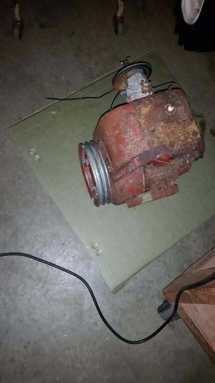

WHX?? 58,290 #19 Posted April 24, 2025 (edited) 4 hours ago, squonk said: Any good tin work and a flywheel available from it? Possibly tins but no flywheel Squonky. The fly wheel had a crack in the keyway and is now a door stop. I'll look for it when I can get in the parts shed. I know the double engine pulley is there. I shelved it when I got a 701 motor from Pullstart. Yep tins fer sure... That's a good PN on the fly wheel. I got lucky and found one off a JD on fleabay. You can have the whole motor Squonk if Dan or KP doesn't want it. 38 minutes ago, Achto said: good luck with LIl Red Barn. I have too ... yes off shore stuff but ok. I have their rings in several motors. Edited April 24, 2025 by WHX?? 1 1 Share this post Link to post Share on other sites

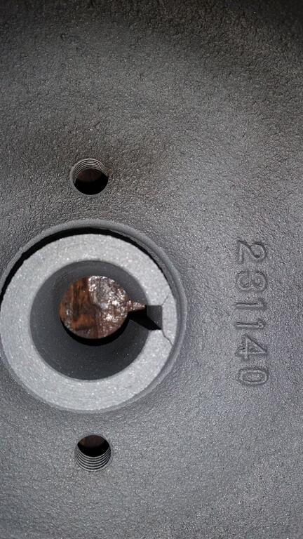

WHX?? 58,290 #20 Posted April 24, 2025 (edited) 21 hours ago, kpinnc said: I can't use the donor crank because it has a 1 inch long tapered output shaft. I have the crank too KP. Yours for shipping. Would need a new rod fer sure. Edited April 24, 2025 by WHX?? 1 Share this post Link to post Share on other sites
squonk 48,207 #21 Posted April 24, 2025 @WHX?? If available I'll take the parts motor. I need the tins for when I run an engine on my break in stand. I had to cannibalize HHHOOOWWWAAARRRDDD!!! just to break in the engine I was a puttin in him. All I would need then is a good flywheel. Share this post Link to post Share on other sites
kpinnc 19,002 #22 Posted April 24, 2025 11 hours ago, WHX?? said: Did I mention I have a 701/161 parts motor??? I would love to have the crankshaft from it if that is an option. 1 Share this post Link to post Share on other sites

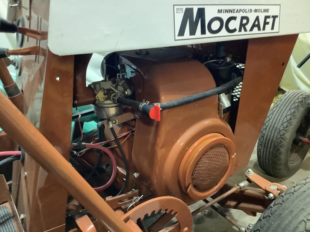

CRF857 1,194 #23 Posted April 24, 2025 (edited) My 1962 Mo-Craft had a tired out K160 “small bore”. Since nothing is available for that model I bought a “large bore” K161 kit from I Save Tractors. Took both pistons and block to the machine shop. Machinist wouldn’t touch it until I convinced him they were same stroke and piston height. After checking the crank he was happy enough to bore and hone it to fit the new piston. The little engine runs just fine now. Gotta go. The wife just pulled a pineapple/coconut pie from the oven. That has priority over this forum!! Edited April 24, 2025 by CRF857 1 1 Share this post Link to post Share on other sites
WHX?? 58,290 #24 Posted April 24, 2025 31 minutes ago, CRF857 said: wife just pulled a pineapple/coconut pie from the oven. We'll let you go on the pie but me thinks we may have to see some more pics of that tractor ... and what's attached to that turf glide photo bombing ... Share this post Link to post Share on other sites
CRF857 1,194 #25 Posted April 24, 2025 (edited) 3 hours ago, WHX?? said: ... and what's attached to that turf glide photo bombing ... That tire is attached to a Speedex S17. I could post some pictures in the thread for “others”. Take me a while to get them out to take pictures. posted pics in other brands thread Edited April 24, 2025 by CRF857 Added instruction Share this post Link to post Share on other sites
