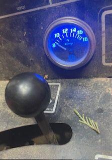

Sparky-(Admin) 26,185 #1 Posted April 12, 2025 Anyone know what the lamps are in the volt or fuel gages? Real small, and I was unable to find them in the electrical parts list for a 520. This is what I have left to work with… Share this post Link to post Share on other sites
Sparky-(Admin) 26,185 #2 Posted April 12, 2025 Something with an 89 in it maybe? Share this post Link to post Share on other sites
Sparky-(Admin) 26,185 #3 Posted April 12, 2025 @squonk Where are ya buddy!!! What do I ask for when I swing into NAPA! Share this post Link to post Share on other sites
