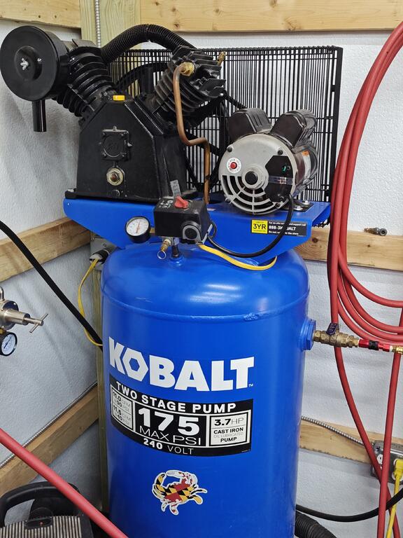

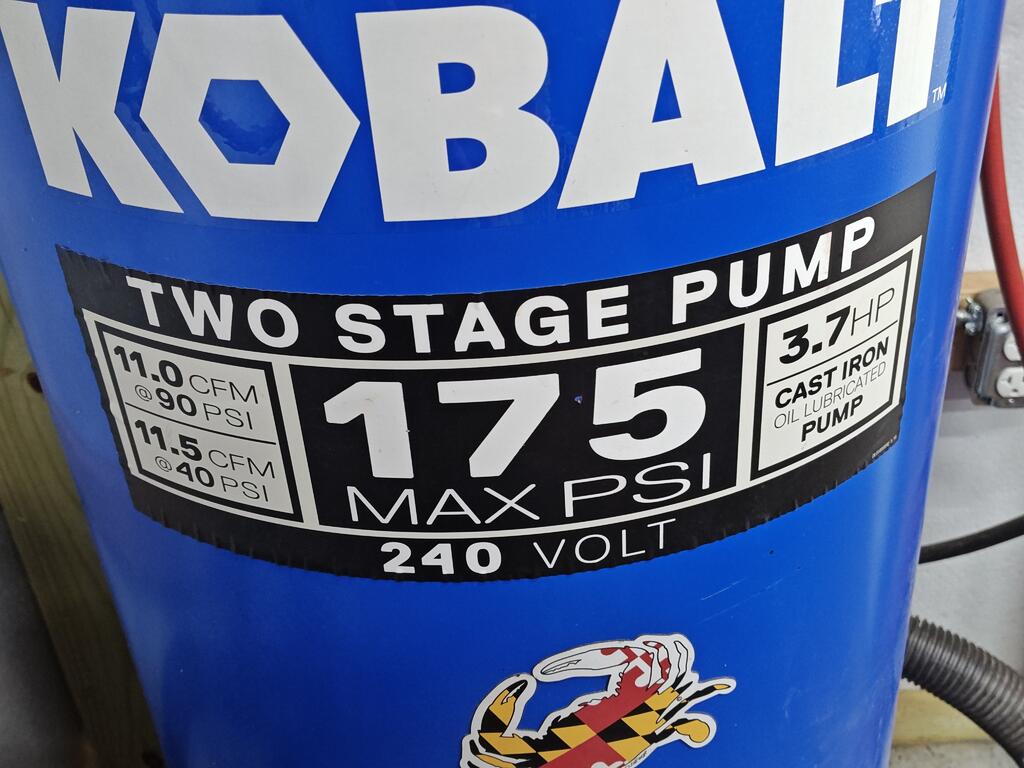

rmaynard 17,659 #13 Posted April 13, 2025 20 hours ago, HyperPete said: I'm about to sell my 2-stage 60 gallon 10.5 CFM because it can't keep up. Buy the most you can afford! I agree. I have a Harbor Freight cabinet with loads of modifications. It works well, but my 3.7 HP, 11 CFM compressor can't keep up. It runs constantly, and sometimes if I'm working a particularly difficult piece, I actually have to stop and let it catch up. Bottom line is if you are serious about doing much blasting, over-buy on the compressor. If the blaster calls for X CFM @ Y pressure, double it, or at lease go 1-1/2 times over. Share this post Link to post Share on other sites
HyperPete 949 #14 Posted April 13, 2025 That looks like my compressor. Maybe mine isn't 5 HP! Share this post Link to post Share on other sites
