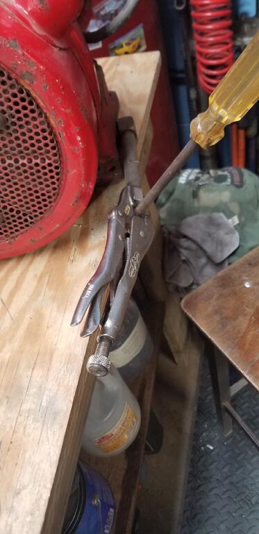

gt14rider 1,278 #7 Posted April 11, 2025 Try this , I know your cap is round but clamp vice grip as tight as you can , use screwdriver or pry bar , tap with hammer, just need to move it a little, it'll spin off Share this post Link to post Share on other sites

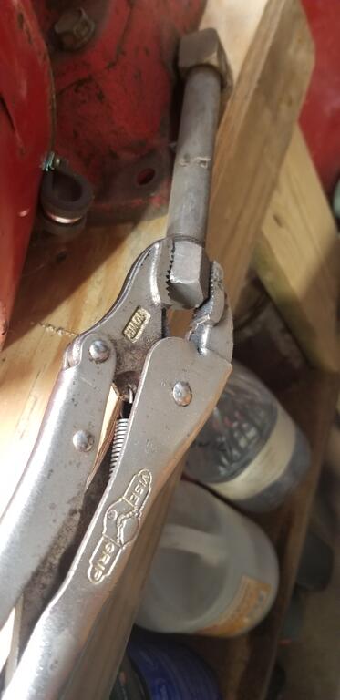

953 nut 68,503 #10 Posted April 11, 2025 My guess is the clamping force of a pair of vice grips used by a previous owner may have made that previously ROUND pipe into an oval shape along with the cap that is now permanently attached. You may need to replace the pipe and cap as a unit. 3 1 Share this post Link to post Share on other sites

stevasaurus 23,802 #13 Posted April 11, 2025 Syphoning is not going to fix your problem...you still have to fix this so you can use the drain. At this point, I would drill a hole in the cap big enough to let the oil run out. Let it drain and then cut the side of the cap with a 2" grinder, hack saw or something to get that cap off. Decide if you can live with the exention pipe, replace it if not. Re-build the drain using Racin'Bob's valve on a new pipe. There comes a time when you just get it done and go on to the next issue. Like...cut off the extention pipe and use an easy-out to turn out the pipe piece that's left. KISS...Keep it simple Stevasaurus !!! 2 1 Share this post Link to post Share on other sites
