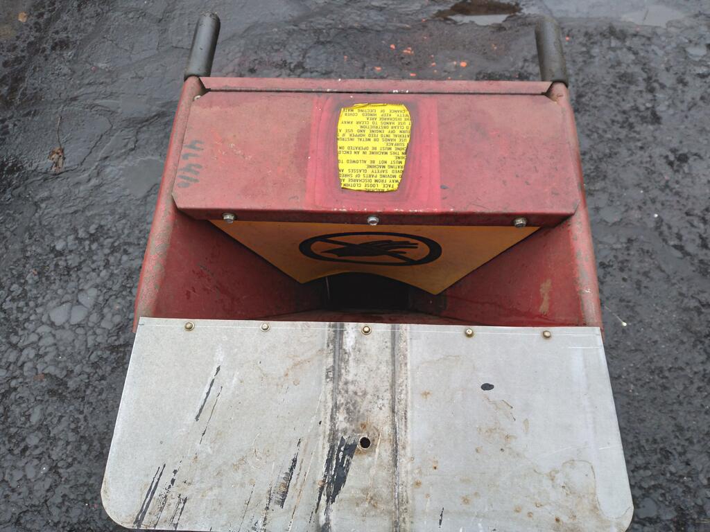

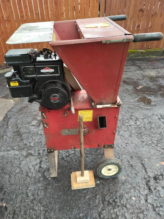

D_Mac 9,333 #26 Posted April 15, 2025 Had one a couple years ago. I gave it to a friend of mine and he built a little trailer for it so he could tow it around with his tractor. He had it a few years and gave it back to me. He loved using it so much he bought a huge chipper that he hooks up to his Kubota. I have since sold it. 3 Share this post Link to post Share on other sites

Treepep 1,037 #33 Posted August 3, 2025 On 4/15/2025 at 5:54 PM, D_Mac said: Had one a couple years ago. I gave it to a friend of mine and he built a little trailer for it so he could tow it around with his tractor. He had it a few years and gave it back to me. He loved using it so much he bought a huge chipper that he hooks up to his Kubota. I have since sold it. I like the custom pusher! 1 Share this post Link to post Share on other sites

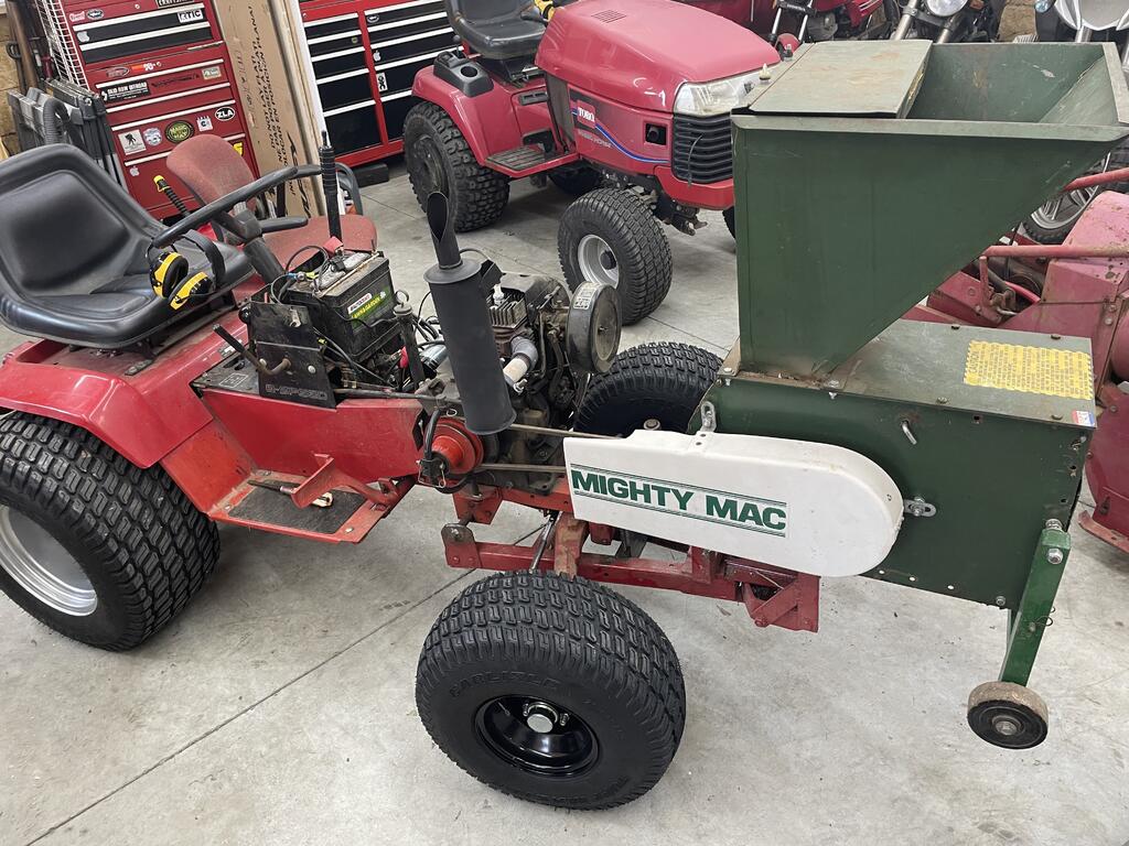

Marv 994 #34 Posted August 3, 2025 On 4/11/2025 at 12:08 PM, OoPEZoO said: Nice.....I bought my MacKissic at the big show a few years ago and love having it available. Mine is mounted on the front half of an old plow frame so it attaches to the center and front attachamatic mounts. It was originally on a full plow frame, but it was a PITA to muscle around, so I hacked off the back end and welded in the cross bar for the mid mount. The previous owner also added a set of swing down legs on the front so when its not on the tractor, I can walk it around like a wheel barrow. Then I can flip it up on its end in the corner of the shop when its not needed. It works really well. The only downside being that I have to remove the hood any time I want to use it because the belt comes in contact with the edge of the hood. I could probably fix that by remounting the unit on the plow frame slightly offset, but its not that big of a deal and works great as it is. I've probably run 8-10 tanks of gas through the horse with this thing going full tilt. Mine came with the tiny 1/2" screen installed. It worked ok for VERY dry material, but clogged often. I watched Ebay for a few months and managed to score some NOS screens and a spare chipping blade for a decent price. I typically use the 1.5"x3" oval screen. I chip/shred a lot of stringy wet stuff, plus bamboo, and it seems to handle that the best. EDIT: Oh.....and my flapper door is pinned out at the end of the unit. I pin it at the top and leave the bottom loose to swing out. If it was farther back in the machine, I would be concerned with constant clogging. This thing will chip a LOT of stuff, very quickly once you get a routine down Nice setup. Question about the muffler. What muffler did you use? I replaced an engine. Looks like I need something like your set up. Marv 1 Share this post Link to post Share on other sites
ebinmaine 77,082 #35 Posted August 4, 2025 On 8/3/2025 at 11:29 AM, Marv said: Nice setup. Question about the muffler. What muffler did you use? I replaced an engine. Looks like I need something like your set up. Marv Marv that's a Cub style muffler. Readily available on the interwebs. I've used those here too. Good sound. Relatively quiet. Deep tone. I switched to the smaller Gravely style which also has good tone and is a smaller more easily adapted piece. 2 Share this post Link to post Share on other sites

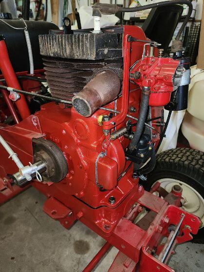

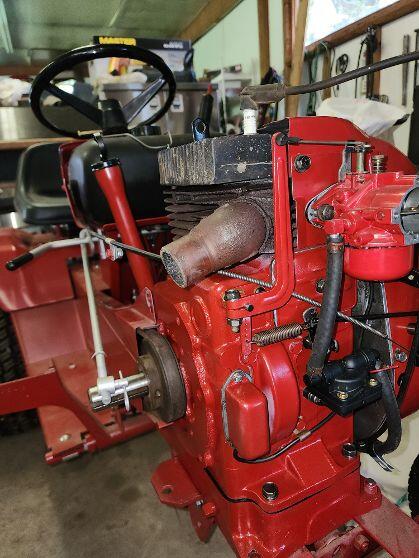

Marv 994 #36 Posted August 5, 2025 6 hours ago, ebinmaine said: Marv that's a Cub style muffler. Readily available on the interwebs. I've used those here too. Good sound. Relatively quiet. Deep tone. I switched to the smaller Gravely style which also has good tone and is a smaller more easily adapted piece. Thanks EB. Here is what I ran into. The exhaust elbow is one piece and the OD is a bit larger than the standard nipple, The nipple part is angled down too. .Doesn't make for a nice setup. Still working on it. 3 Share this post Link to post Share on other sites
ebinmaine 77,082 #37 Posted August 5, 2025 8 hours ago, Marv said: Thanks EB. Here is what I ran into. The exhaust elbow is one piece and the OD is a bit larger than the standard nipple, The nipple part is angled down too. .Doesn't make for a nice setup. Still working on it. It can be a real challenge to get those elbows out but that's what I'd do. The replacement is hardware store black iron pipe. 2 Share this post Link to post Share on other sites
OoPEZoO 591 #38 Posted August 11, 2025 Yup....What EB said. The muffler is a "cheap" muffler off of Amazon that said it fit Cub Cadet and Kohler singles. The exhaust piping is hardware store black pipe. If memory serves.....a threaded nipple, 45 elbow, and short cut off section of pipe. I think it looks a little dopey, but it sounds fine and is out of the way. It will never be show queen and it serves its purpose, so its a winner in my book 2 1 Share this post Link to post Share on other sites
