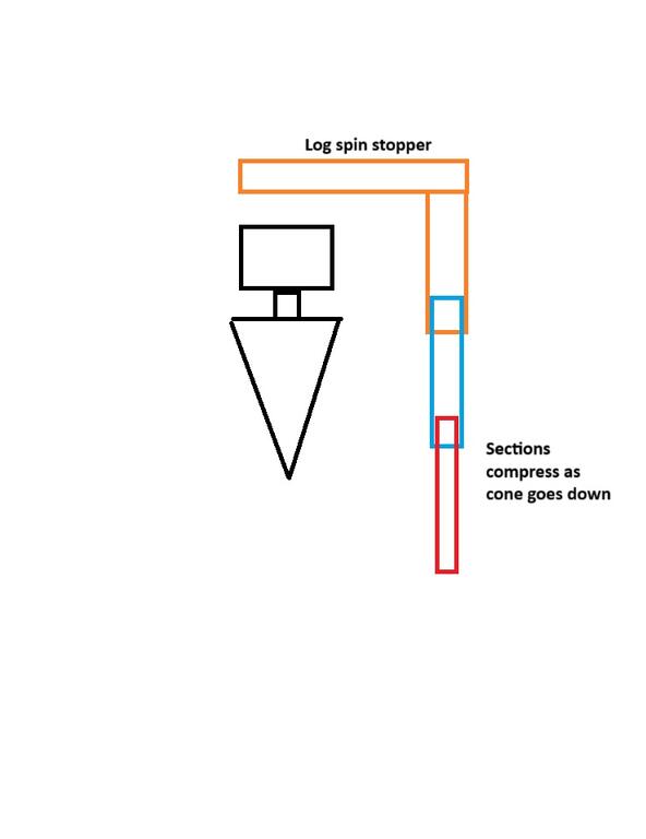

wallfish 20,553 #61 Posted April 12, 2025 More than once I've thought about doing a cone/screw type splitter for the end of that back hoe. Basically just sit in the seat and poke them logs right on the ground to split'em up. Push the splits into a pile with the loader and then get started on the next batch. You could also screw into them part way to move the big logs around 2 Share this post Link to post Share on other sites
Wayne0 1,631 #62 Posted April 12, 2025 (edited) 1 hour ago, wallfish said: More than once I've thought about doing a cone/screw type splitter for the end of that back hoe. Basically just sit in the seat and poke them logs right on the ground to split'em up. Push the splits into a pile with the loader and then get started on the next batch. You could also screw into them part way to move the big logs around I had one of those once. It worked pretty good until the log wasn't supported and became a propeller! For speed, a Kinetic splitter is the way to go. Edited April 12, 2025 by Wayne0 Share this post Link to post Share on other sites
wallfish 20,553 #63 Posted April 12, 2025 1 hour ago, Wayne0 said: I had one of those once. It worked pretty good until the log wasn't supported and became a propeller! You couldn't just push it into the ground? 1 Share this post Link to post Share on other sites

wallfish 20,553 #69 Posted April 13, 2025 5 hours ago, ebinmaine said: I've operated a Twist Splitter on a strong HAND DRILL. It was extremely difficult to control even at my personal oversized proportions. I can't begin to imagine the circular forces created by a medium sized hydraulic circuit. The long arm and weight of the hoe plus the tractor should be sufficient leverage and weight for the ground to be the log stop but had also thought of something if it wasn't. I realize you're not going this route but just throwing out ideas anyway. 2 Share this post Link to post Share on other sites

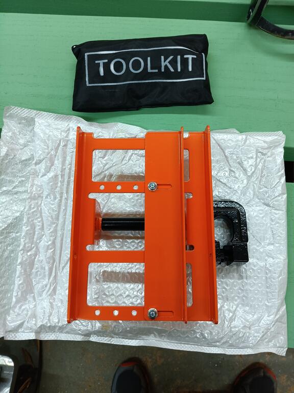

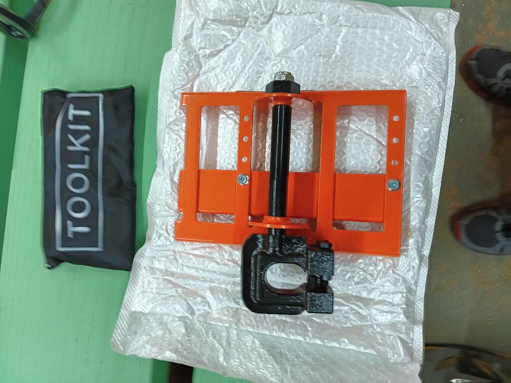

ebinmaine 80,462 #70 Posted April 16, 2025 Got this in the mail today. Share this post Link to post Share on other sites
wallfish 20,553 #71 Posted April 17, 2025 12 hours ago, ebinmaine said: Got this in the mail today. Perfect. I'll take 45 2x10s about 15-20 ft long and delivered this Sat. If you haven't set up a saw yet, there is a better way to sharpen/shape the chain teeth for ripping compared to cross cutting. 1 Share this post Link to post Share on other sites
ebinmaine 80,462 #72 Posted April 17, 2025 23 minutes ago, wallfish said: Perfect. I'll take 45 2x10s about 15-20 ft long and delivered this Sat. If you haven't set up a saw yet, there is a better way to sharpen/shape the chain teeth for ripping compared to cross cutting. Oh this isn't for a mill. This is the pivot point of the chainsaw for a cutting station. It'll get set up at the end of a sawbuck/horse. 1 Share this post Link to post Share on other sites
