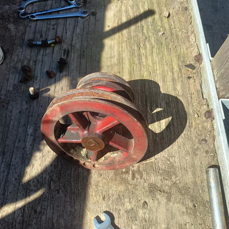

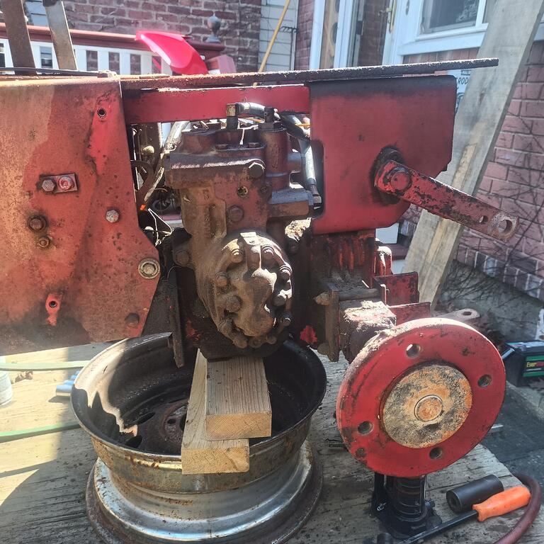

978GT14 3 #11 Posted April 20, 2025 Thank you for all the help! Here is the double pulley that snapped off while tilling. I spoke with LJ in Michigan and wouldn't you know it he has a replacement shaft for it! Easter Sunday seemed like a good morning to start the resurrection of the old horse. They are shipping out the shaft on Monday with seals and gaskets so I started digging into it this morning I'm pretty good at taking things apart... It's getting them back together that's the real chore. I was hoping to find a complete unit but I'm always up for a good challenge Thanks again for all the Intel 1 Share this post Link to post Share on other sites

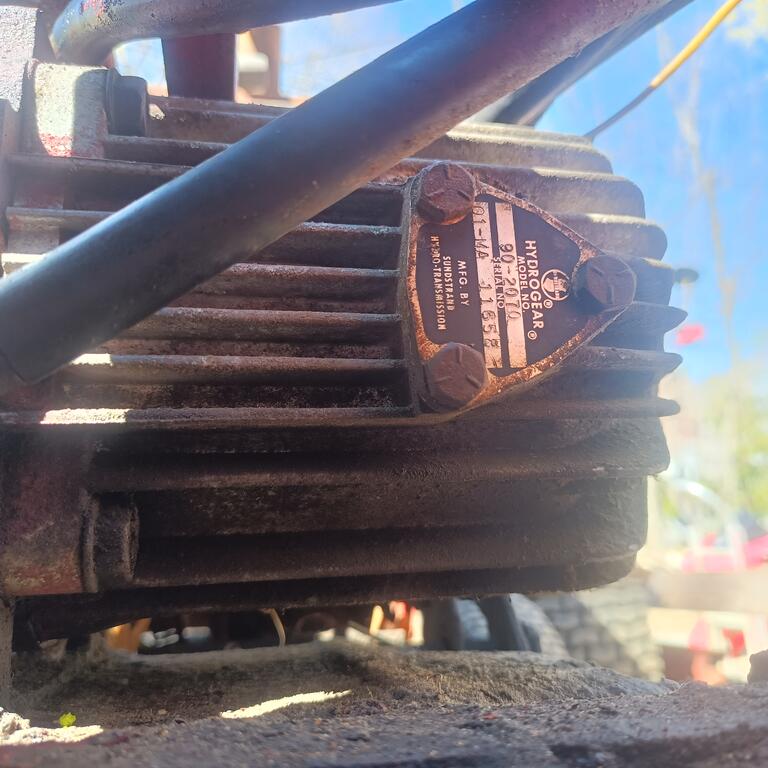

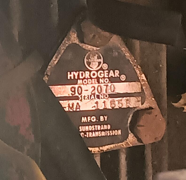

978GT14 3 #12 Posted April 20, 2025 On 4/10/2025 at 7:53 PM, gt14rider said: Hi Fyi your pump should be a 90- 2062 There are step by step info in sundstrand manual. There were different input shafts, could you get some pics of pulleys and end of shaft. If you No I have a different one 90-2070 Share this post Link to post Share on other sites

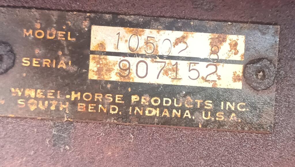

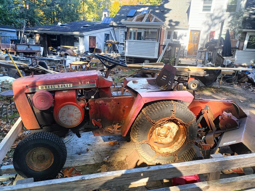

978GT14 3 #13 Posted April 20, 2025 And I was hoping somebody could tell me a little bit more about my tractor with this model number and serial number I'm not sure what year it is? Thanks Share this post Link to post Share on other sites

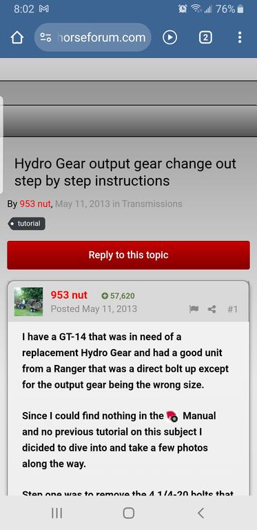

953 nut 67,724 #14 Posted April 20, 2025 (edited) Your GT-14 is a 1972 and the Sundstrand it left the factory with would have been a 90-2060 Hydrogear. Sundstrand transmissions from other models can be modified to fit the GT-14 by changing the output gear. Edited April 20, 2025 by 953 nut fat finger Share this post Link to post Share on other sites
gwest_ca-(File Mod) 12,391 #15 Posted July 11, 2025 Going to say this is a 1973 model tractor and how we got here. The tractor model numbers at the time had a 6th digit suffix. Subtract 5 from the 6th digit and you get the model year. (8-5=3=1973) The Attachment Interchange for 1973 lists the GT-14 as model number 1-0502-8. The 6th digit is not normally used but it was here. The 1972 models were stamped model number 1-0502-7. (7-5=2=1972) Suspect they had a surplus of GT-14 parts at the end of 1972 production so put them together as 1973 models. By chance are you located in the UK? All the 1973 model GT-14's may have been exported from USA. Share this post Link to post Share on other sites
