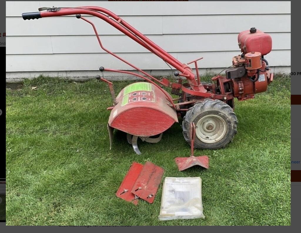

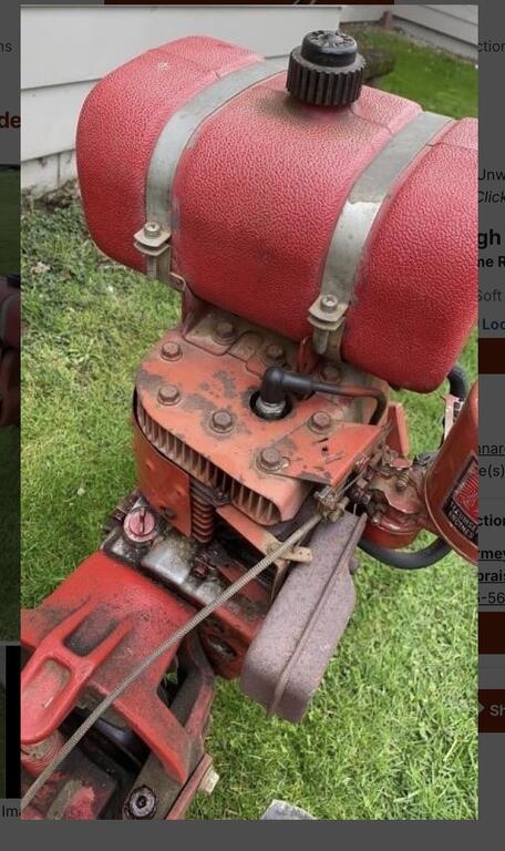

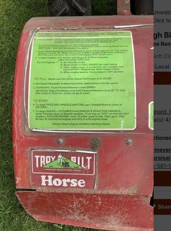

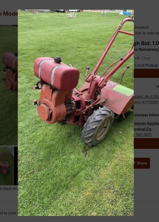

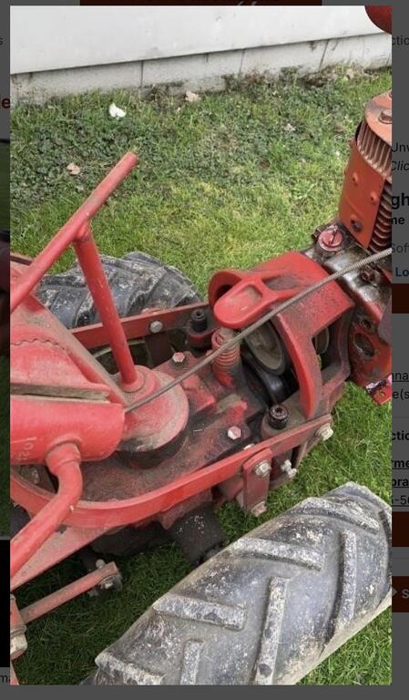

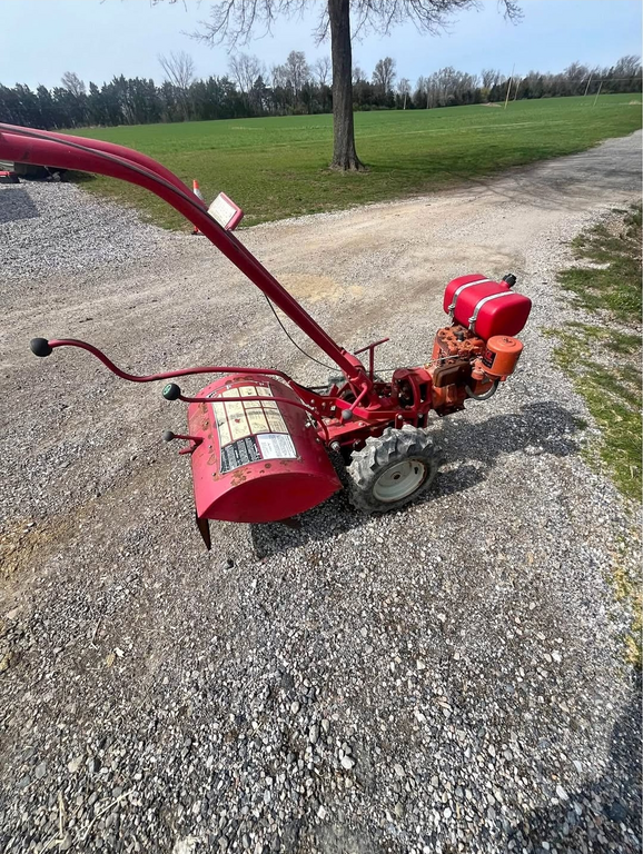

rustyedge1 201 #1 Posted April 7, 2025 Garden time again and I’m looking at this tiller at auction, states in working condition. Can’t see it in person until 4-15. If anyone out there is familiar with them would appreciate your opinion. Also any ideas what one should expect to pay ? Looks all original in photos to me anyway. May have to have this one, been wanting one for some time. Depends on how it goes.. Input appreciated. Thanks 3 1 Share this post Link to post Share on other sites
Skwerl58 831 #2 Posted April 7, 2025 They are a great tiller for most garden plots. They can be hard to handle if in rocky or root areas because they dig so good they can abruptly go forward if it grabs a root or large rock. Then just adjust the depth better. I have one and it is from the 78 or so yom. It has a replacement Chinese carb and runs great. They are beast when it comes to doing what they are designed to do. They are rather easy to maintain and this one has a furrower that is a good attachment. Parts are readily available for them. I changed the oil in mine this year and you check the tranny/drive grease by taking the handles off with the T bolt and fill in the hole. As far as price goes if you crank it and it operates as it should with little or no engine smoke I would say $250-$350 is fair for this one as good as it looks. Area also drives the price and it may go for quite a bit more than my price estimate. 1 Share this post Link to post Share on other sites
oliver2-44 11,645 #3 Posted April 7, 2025 I received a free Troy Bilt Pony tiller 2 years ago. engine was shot and transmission needed bearings and seals. I had a Harbor Freight engine on the shelf, and rebuilt the gearbox with new bearings and seals. Spent too much on bearings and seals even though I matched them up at a bearing supply. It works good, but no reverse since the HF engine doesn't have the extra drive pulley off the cam shaft like the Briggs did. Also one side of the tine shaft had some seal wear and seeps gear oil. I had tried to shim the seal out, but I guess shaft too worn. I just know I have to check and add gear oil before I use it. So inspect the tine shaft seals and drive wheel shaft seals before you buy it. 2 Share this post Link to post Share on other sites
oldlineman 1,758 #4 Posted April 7, 2025 I have the exact same tiller, except mine has a Kohler 7 hp, great heavy duty tiller, have had mine since early 80's. 2 Share this post Link to post Share on other sites
ebinmaine 79,756 #5 Posted April 7, 2025 1 hour ago, Skwerl58 said: $250-$350 is fair for this one as good as it looks. Area also drives the price and it may go for quite a bit more than my price estimate. $400 - $450 up here. 2 Share this post Link to post Share on other sites
JoeM 10,101 #6 Posted April 7, 2025 Works good in decent ground but I prefer the WH tiller on a tractor. Much easier on the operator. I called mine "killer tiller". Never put the running tines on the ground with the wheels in neutral. Like Jim says, tine seals are a problem. My friend has one and ended up using corn head grease. 3 Share this post Link to post Share on other sites
pfrederi 20,915 #7 Posted April 7, 2025 Tines look fairly good from what I can see. Tecumseh engine replacement tank. Ag Tires are a plus Very similar to mine my father bought back in the early 70s. Picked it up at the factory in Troy NY Still works never a seal issue...Rugged mac hies can be hard to control on rocky soil but once it is mostly de-rocked you walk along one side control it with one hand. if you have really rocky soil you can get pic tines for her. $400 2 1 Share this post Link to post Share on other sites

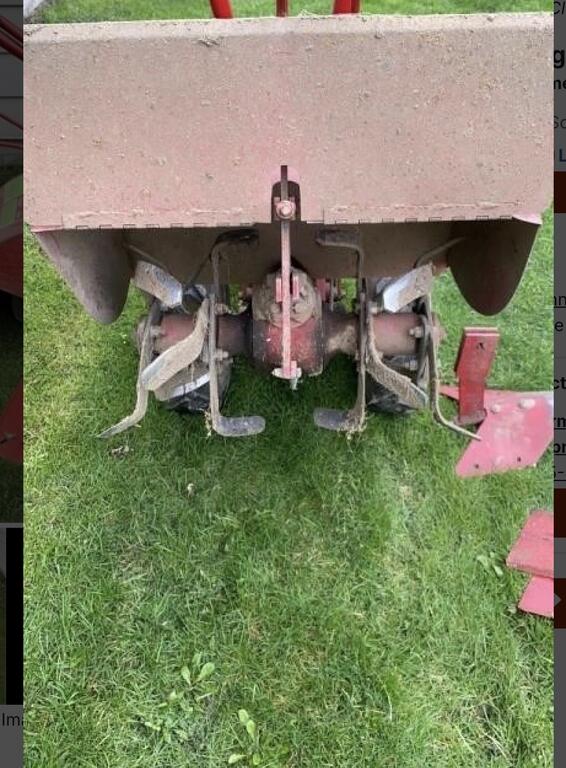

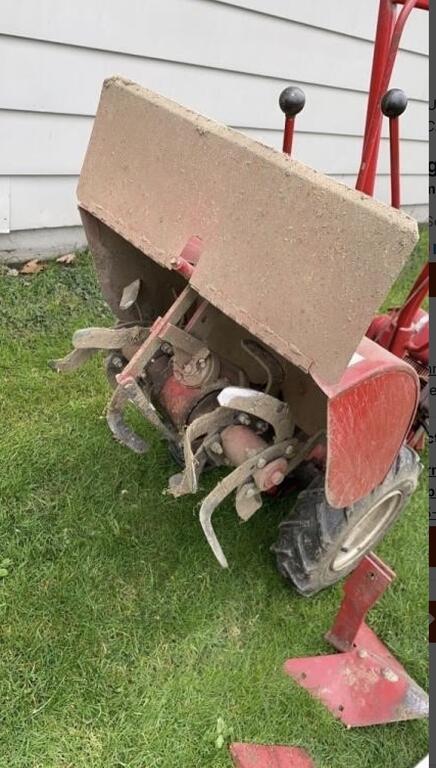

rustyedge1 201 #8 Posted April 8, 2025 Thanks for all the input everybody. These are tine photos. Looks like some oil leaks.. Share this post Link to post Share on other sites
oliver2-44 11,645 #9 Posted April 8, 2025 If you look at it, try to wiggle or rock those times to get a feel if the bearing have slop. during reassembly of my Pony tiller, there are shims that are used to set the proper bearing clearance. Essentially no wiggle when newly shimmed. 1 Share this post Link to post Share on other sites
