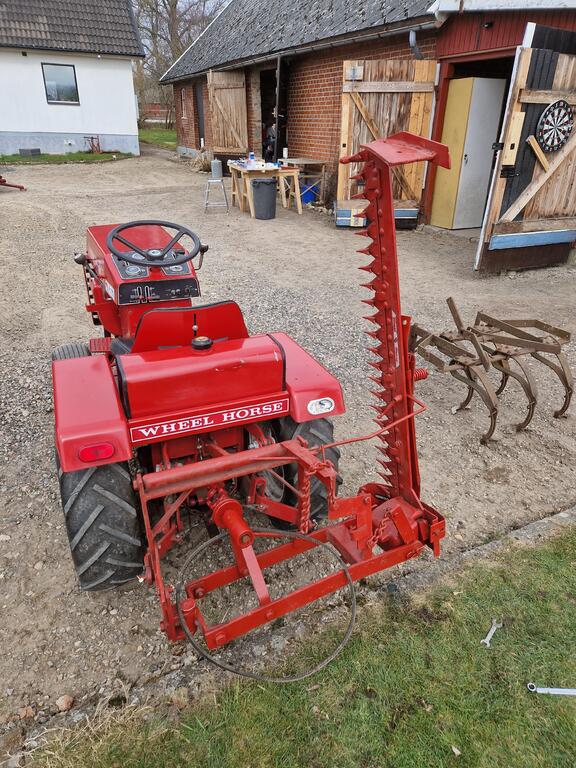

Hi,
Couple of weeks ago I bought a D180 from 74 with a couple of different attachments. One of them is a rear mounted sickle bar. But I can't really set it up properly. I have not seen any other WH tractor with the same mounting for the sickle bar. What I've seen is only the front mounted or the side mounted (that's basically online with the seat). The sickle bar looks like a original WH.
The guy I bought it from had never used the sickle bar so he didn't know either.
When I attach it to the three point the pulley discs aren't aligned. And the belt will rub against the metal frame.
Has anyone seen this type of rear mounted sickle bar before?
Does anyone have a clue what is wrong?

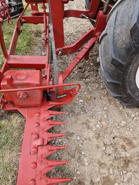

Wheel Horse SWE
Side view of the pulleys and belt.

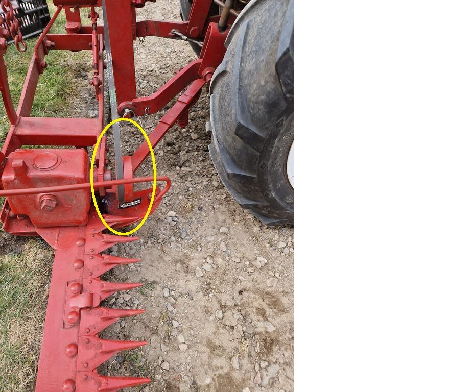

:WRS:
I have not seen a rear sickle before. It looks like there is room on the shaft to move this pulley ( circled in yellow ) closer to the gear box. If so, that could buy you some room.

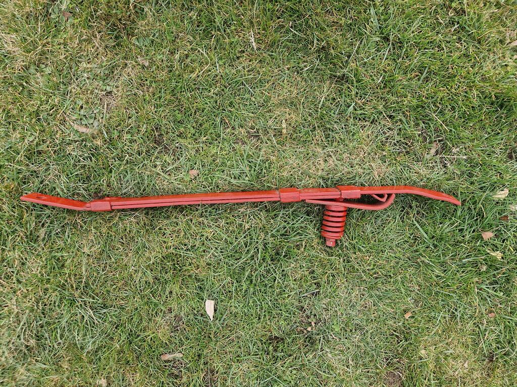

It's not adjustable. It's welded togheter. I'm not even sure it's the right place for it. But it felt logical to put it there for keeping the sickle bar turning back.
The picture is the piece that you circled.

4 hours ago, Achto said:
:WRS:
Thanks 😊
Yes there is room on the shaft to move the pulley futher back. So indeed this will help with the alignment. I'll try and do that.
That could be a problem.     I could be wrong, but it appears that bar is what fixes the mower perpendicular to the tractor and is the break-away link that allows the mower bar to swing back if it hits a fixed object.     It appears that adjustable tension spring applies the friction to the two bars that determines the total length of the bar.   If those two bars are welded together, the whole purpose of the breakaway system is defeated.
  • Like 2
  • Excellent 6
  • Thanks 1
Wheel Horse SWE
Thanks for the input. What you're writing seems logic. 🤔  I'll have another look at the bars maybe I'm mistaken that they are welded together. I'll try and release the tension of the spring and se if I can pull the two bars apart.

Handy Don
I’m curious about the shaft protruding downward from that bar. To me, that would contain a setscrew that applies friction between the two segments of the bar and, hence, regulates the force on the sickle that would permit a breakaway.

Wheel Horse SWE
I was mistaken. The two bars was not welded together. I released the tension from the spring and with a few taps with a rubber mallet I was able to pull them apart.
Your explanation makes alot of sense for the purpose of the part.
Now I think I'll be able to get everything aligned properly.
