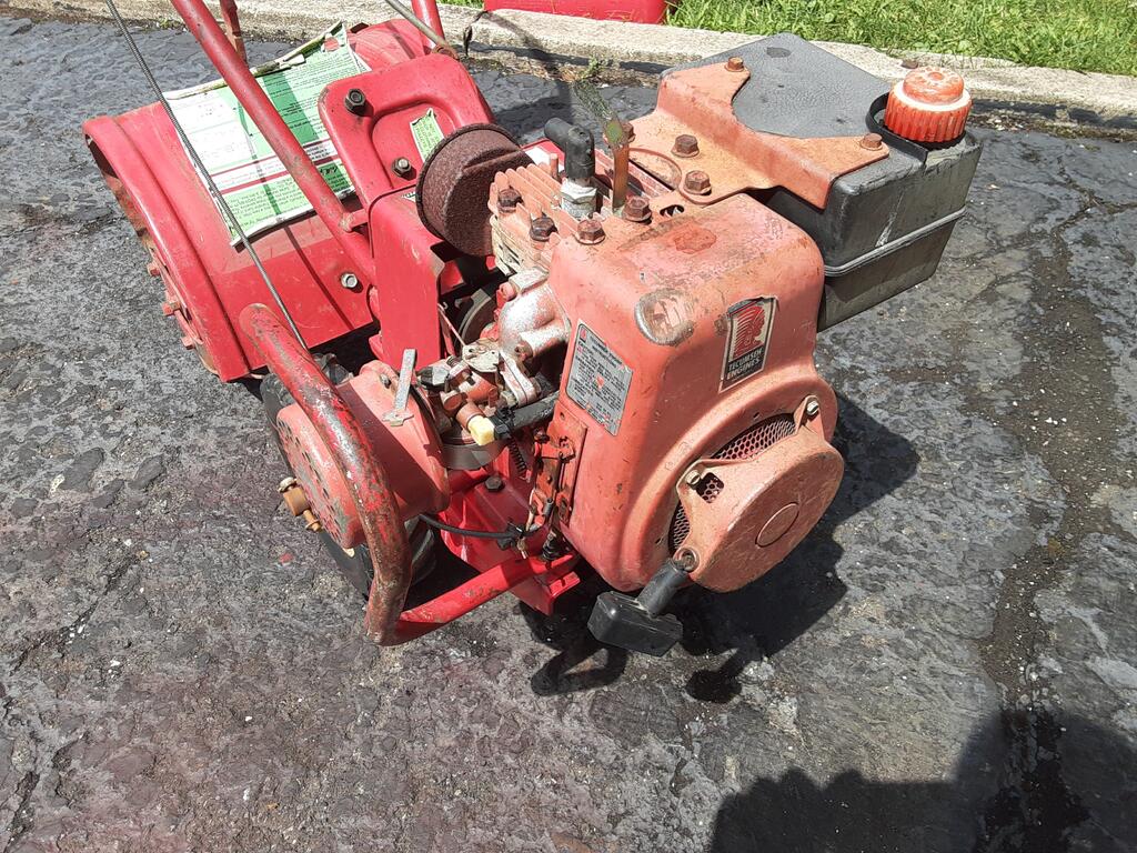

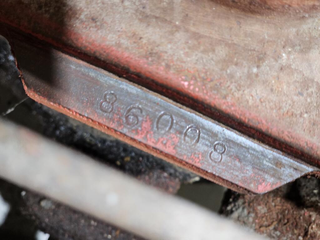

HyperPete 943 #1 Posted March 23, 2025 (edited) I'm going to try to rescue what appears to be a 1974 Troy Bilt Horse 1 tiller. Serial# 86008.( I'm attempting to locate a carb for it. Jacks Small engine has no listing. Any suggestions? Chinese replacement is ok to start. Thanks! Troy Bilt Horse Serial Numbers.pdf Edited March 23, 2025 by Pete D Share this post Link to post Share on other sites

HyperPete 943 #12 Posted March 25, 2025 So, this tiller needs carb linkage & springs as well. It does need both tires, and it's missing one of the sides to the tiller shield. It's getting pretty involved and is going to eat up time I'd rather spend on my shop & tractors. I think I'm going to return it & let him scrap it. Sad, because they seem to have been high quality tillers in their day. 1 Share this post Link to post Share on other sites

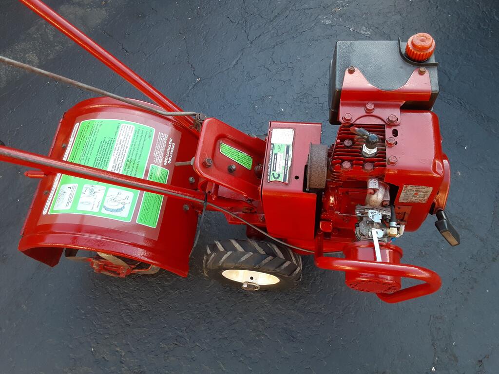

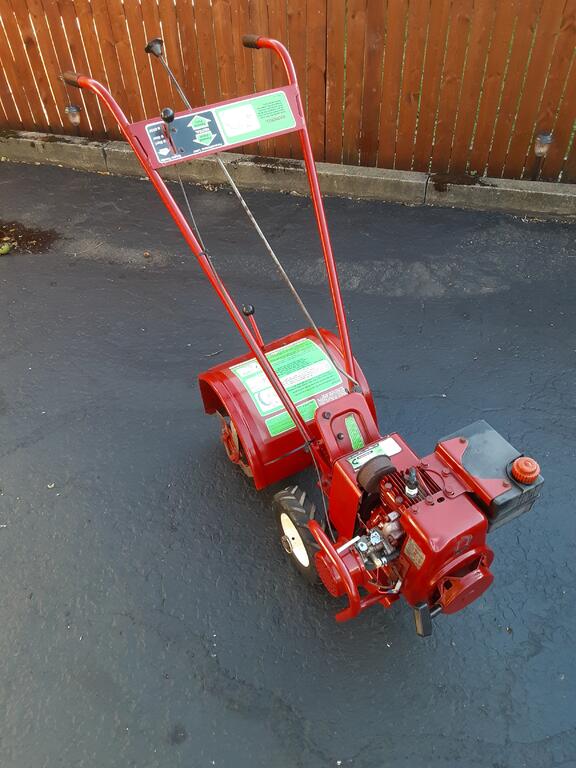

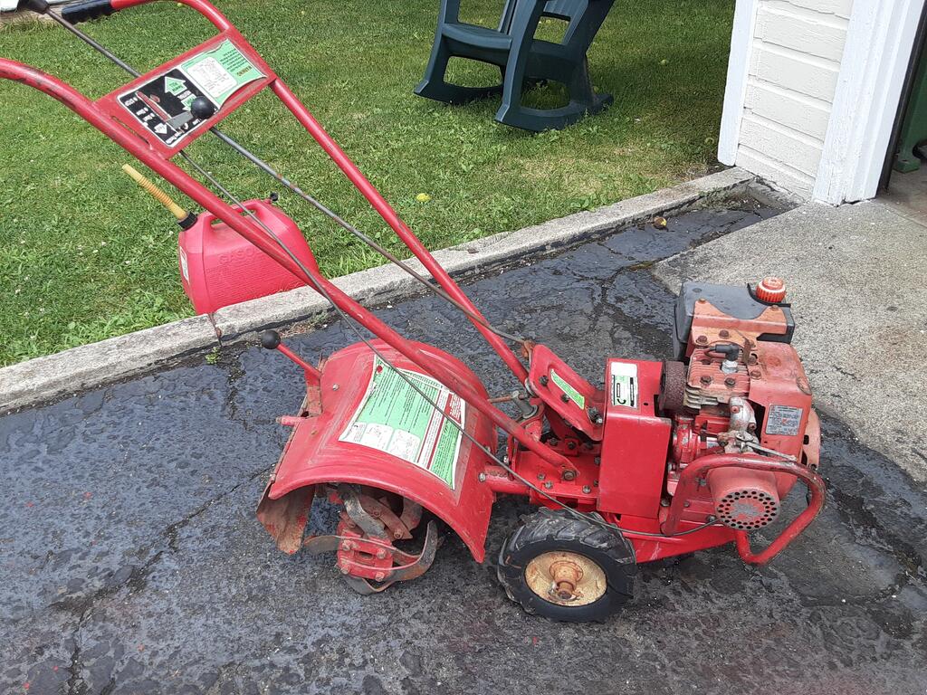

D_Mac 9,339 #13 Posted March 28, 2025 I did a small one up a couple years ago. It was a great little runner. Some before and after shots. Share this post Link to post Share on other sites

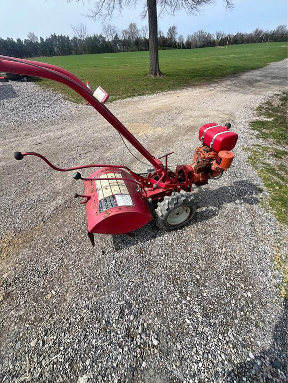

HyperPete 943 #15 Posted April 19, 2025 I just bought this for 75. Bad engine, I'm told. So the "recovery" is kinda resurrected. I'll swap the good engine off the 74 onto this one. It's suddenly raining rototillers! 1 Share this post Link to post Share on other sites
HyperPete 943 #16 Posted April 21, 2025 (edited) So,one $13 carburetor, 8" of fuel line, and 1 1/4 pints of 30W oil later, and I have a working tiller. (It's about time one of my projects went as planned!) EDIT: The crankcase was FULL of gasoline, and the carb was badly corroded. The only part I needed off the old one was the gas cap, to replace the incorrect universal cap that had been used. Edited April 21, 2025 by HyperPete Add detail about problem 1 Share this post Link to post Share on other sites
