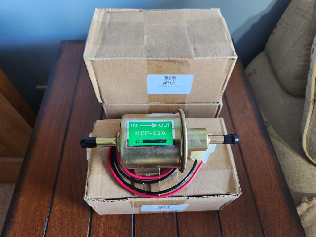

Racinbob 13,290 #15 Posted March 24, 2025 (edited) I have the Mr. Gasket 42S (about $50) on two of mine and two of the other tractors have the cheapies on them. So far no problems with any of them. The 42S pumps have a whir sound and I'd assume all the better units do. The cheapies sound like a little piston pump. Of course the sound doesn't matter once the engine is running. I decided a while back to get a spare cheapie for the shelf and I ended up with three for less than $20 delivered. I'm about set to use one of them on another machine. Edited March 24, 2025 by Racinbob 3 Share this post Link to post Share on other sites
midpack 1,148 #16 Posted March 24, 2025 39 minutes ago, Racinbob said: I have the Mr. Gasket 42S (about $50) on two of mine and two of the other tractors have the cheapies on them. So far no problems with any of them. The 42S pumps have a whir sound and I'd assume all the better units do. The cheapies sound like a little piston pump. Of course the sound doesn't matter once the engine is running. I decided a while back to get a spare cheapie for the shelf and I ended up with three for less than $20 delivered. I'm about set to use one of them and another machine. I use the HEP-02A pump as well, $12.00 and it's been running fine winter and summer for at least 6 years on a KT17. I just put one on Mongo (M18) when the fuel pump stopped working last fall 1 Share this post Link to post Share on other sites
pfrederi 21,342 #17 Posted March 24, 2025 2 hours ago, midpack said: I use the HEP-02A pump as well, $12.00 and it's been running fine winter and summer for at least 6 years on a KT17. I just put one on Mongo (M18) when the fuel pump stopped working last fall I bought 2 of these several years ago. One still works the other failed after a couple hours 2 Share this post Link to post Share on other sites
Racinbob 13,290 #18 Posted March 24, 2025 45 minutes ago, pfrederi said: I bought 2 of these several years ago. One still works the other failed after a couple hours Which is exactly why I wanted spare(s) on the shelf. 1 Share this post Link to post Share on other sites
Lee1977 7,813 #19 Posted March 24, 2025 29 minutes ago, pfrederi said: I bought 2 of these several years ago. One still works the other failed after a couple hours I bought 3 of those cheap ones two are still working and one lasted a couple of days. Share this post Link to post Share on other sites
