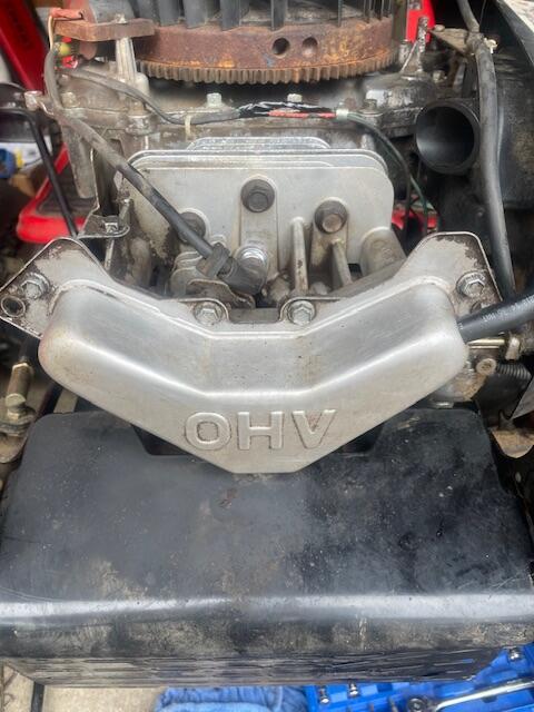

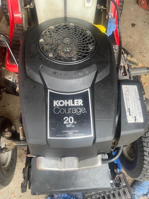

AHS 1,695 #1 Posted March 21, 2025 Ok, im working on my late father in laws Troy bilt tractor w/ Courage 20hp, single cylinder, 597cc. I did an oil and filter change, spark plug and air filter change. I know, kohler was getting cheap and they wanted to makes an engine for Troy bilt, husquvarna and any other brand of tractors. Horizontal and vertical shaft. OHV vs flat head. Cast iron vs aluminum (i guess?). I mean the 14hp K321 (512cc) would be the only compatible engine. I mean my B80 (312cc) would plow the driveway and runs circles around that Troy bilt!. Compare them; i guess. It’s like comparing an orange to a bowling ball i guess!! 1 5 Share this post Link to post Share on other sites

kpinnc 18,754 #8 Posted March 21, 2025 If you open that Courage engine up you will find several plastic gears. I mean the camshaft gear... The last "decent" Kohler engines were the Command line, and even they were nowhere near as rugged or dependable as the K series and Magnums. I've seen comments in lawn care forums referring to them as "you have to have courage to use one", and that says enough... 4 1 Share this post Link to post Share on other sites

RED-Z06 2,718 #10 Posted March 22, 2025 Courage 19hp had its issues early on, the upper closure plate bolts were not torqued properly new, they would back out, and the dowel pins would beat up the block until it cracked. Ive never seen one fail due to the plastic cam gears. The most common failure was the 1st generation anti'vibration mechanism, it would come loose and knock the back of the block out. But the thing is, the market demanded these engines exist. People needed a basic mower that could pull a 42, 44, 46" deck, and mow an acre...for under 1200 dollars. Briggs had their 13-21hp singles, but Kohler only had the Command single which was considered commercial grade, price reflected that at about $1400 engine only. If they put out a 2500 dollar basic rider, with a commercial engine, when the one next to it is identical besides a briggs...at half the price, guess which one sells? 2 Share this post Link to post Share on other sites
