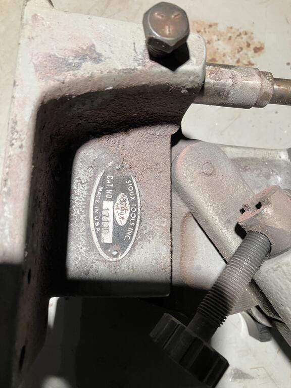

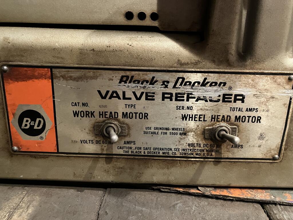

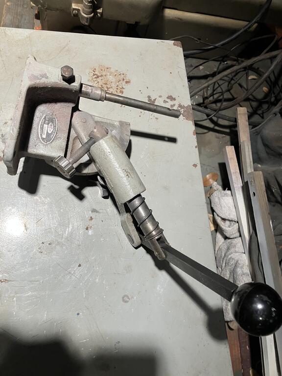

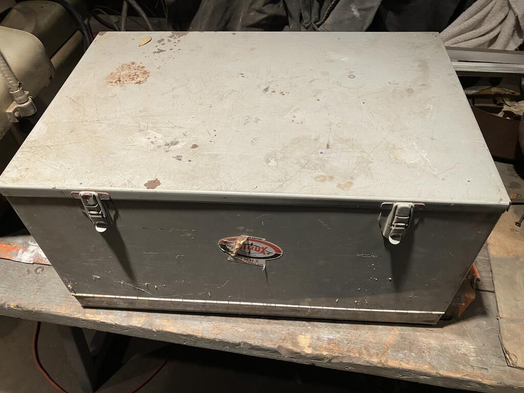

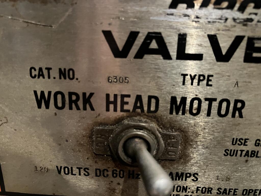

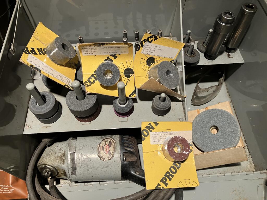

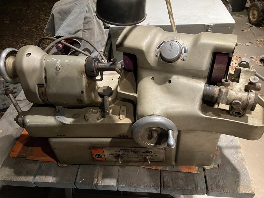

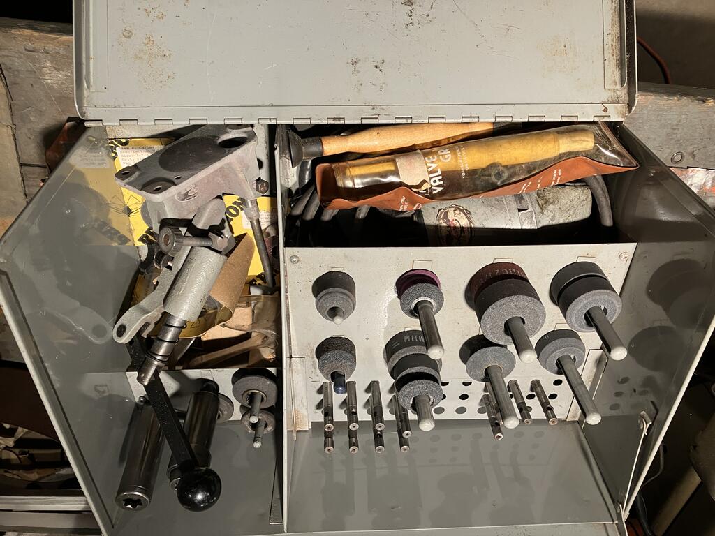

oliver2-44 11,753 #1 Posted March 18, 2025 (edited) So on my C101 thread I mentioned it needing valves and seats ground. I’ve called several engine machine shops and like my search in the past the only one that will touch a small engine is Villas Engine Works in Bryan Tx, 4 hours away. Last night my wife was looking on the Nextdoor Neighbor site for our area and said someone had a valve grinder for $70. She messaged them and I went to look at it this morning. The old hot rod guy had passed away and he wanted his tools to go to someone that would use them. Not just resell them. So after some question from his wife and my showing her my tractor pictures. She said it’s yours. The Black and Decker model 6305 Valve Grinder machine looked great. The stone on the left grinds the valve. The stone on the right is to grind the end of a valve shorter like needed on the Kohler 4,6,7,8 hp engines. It has a coolant pump and reservoir on the left lower side. So I asked her if there was a large silver box with parts in it. She looked around and found the box with the Sioux brand Valve Seat Grinder. I haven’t got into it far enough to figure out if it has the correct pins to fit the Kohler valve guides. Several new square edged stones. The larger new stone to the left is for the valve grinder. This is a diamond seat stone dresser. From what I can tell you buy a stone and dress it to the angle you want. Doing a little research, the “Goodson Company” looks to still lists a lot of (expensive) stuff that fits this model. I had used one similar back in my high school tractor shop days (with help) SO I HAVE A LOT TO LEARN, If anyone on here has experience with these, I’m all ears and thumbs. I’m currently searching for a manual for both tools. I do have some old valves and 2 bad/cracked blocks to practice on. I suspect some of the Machinist forum's may also be a place for help. Edited March 18, 2025 by oliver2-44 9 Share this post Link to post Share on other sites

ri702bill 13,069 #3 Posted March 18, 2025 JIm - great score. Almost identical to the ones we used in Auto Trade Shop School back in the early 1970's..... DO check the overall electrical condition of both tools - the brushes & springs may be gummed up, the cord insulation frayed. Check the valve guide arbor(s) for straightness and wear. Both conditions will result with an incorrect seat grind. Check the stones for visable cracks (they are probably way too small to "ring" them as you do with a bench grinding wheel) Using the seat cutter - light pressure and no more than a second at a time. Straight down engagement of the powerhead - no side-to-side. Check the runout of a known good valve in the valve dresser. Should be around .001 or dead on. FYI - I do a more backyard approach using a benchtop lathe & Dremel for the valves and a Shopsmith Mark V as a vertical drill press to grind the seats. Works well..... 1 Share this post Link to post Share on other sites

953 nut 69,369 #12 Posted March 19, 2025 On 3/17/2025 at 11:50 PM, oliver2-44 said: The Black and Decker model 6305 Valve Grinder machine looked great. There is no ZIP Code on the address so that is a pre 1963 unit, back when quality was important. It doesn't appear to have seen much use, looks like new. On 3/18/2025 at 5:11 AM, oliver2-44 said: suggestions for a product to wipe the machined parts down with to prevent future rust. How about giving it a wax job? Wax won't attract and hold dust and will clean up with a little mineral spirits when needed. 1 Share this post Link to post Share on other sites

BBQVultureWings 160 #16 Posted April 1, 2025 $70 ???? You made out like a bandit. the Sioux seat grinding kit alone should cost a guy $2,000.00 & more for a complete set. I have 3 partial seat grinding kits that make up 1 so I will be selling off some stuff soon & 2 Sioux 640 series valve grinders which between the 2, I will make 1 Perfect Machine & sell the other. I got really lucky with a FleaBay seller who did Not know what he had & I scored a Sioux 648 With the cabinet, full of tooling too for just under $400.00 a few years back...... Anyway I have a lot of this equipment & you just cant go wrong by having it. I have seen the empty cabinets alone go for over $900.00... so there is resale value in it if you decide it's too much technical stuff but most of us just keep on going once we get "the bug" for this part of the restoration work which I find to be a Particularly Admirable quality as opposed to just slapping some cheap crap in there to repower what is a True Classic in my not so humble opinion..... Or IF ya have a money tree in the back yard, the NEway equipment is dramatically smaller, compact & Excellent quality, Yet Very expensive.... You can fix & or just about rebuild every valve train there is with this stuff. A couple of the most common pilots are well worth the investment for New 1s for what they can do for you. Now that you have saved all that money by making such an incredible score, It's time for a Boring bar lol then you're almost set after the telescoping gauges for measuring Cylinders lol... & a few more Precision measuring tools... .. it's almost an addiction once you really start finding out how to do this work for yourself & how much money you can make from a simple valve job... I have a bunch of the charts for Kohler, Briggs, Tecumseh & others so let me know if you need something specific & I can consult my small "Library" of Dealer's Parts & Service Manuals I have amassed over the years. I would like to scan all this stuff but that takes a lot of time. Because you mentioned the Kohlers, I included the quick reference charts that I have for Kohlerr.... Anyway, Congrats on such a great score!! 1 Share this post Link to post Share on other sites
oliver2-44 11,753 #17 Posted April 1, 2025 @BBQVultureWings I sent you a PM Thanks for the reply, its good to hear from someone knowledgeable about using this equipment. I have the B&D valve grinder externally cleaned up. I got the coolant sump drawer cleaned up which was a chore. Dried oil and grinding dust make cement! My next step is the coolant pump. I've bumped the switch and heard it run, so that's good. What do you suggest I do next? I've watched some YouTube videos where guys take them apart, but do I really need to go that far? Could I put some paint thinner in the sump and see it it will circulate that for a while as a cleaner? Do I need to prime the pump somehow? I realize paint thinner is thinner that the oil, so will the pump even pick it up. Sorry, lots of questions and things to learn. 1 Share this post Link to post Share on other sites
lynnmor 9,041 #18 Posted April 1, 2025 You should chuck up a precision pin such as a drill blank and indicate it for play and runout, that may tell you if the spindle needs work. Until that is done there is no point in proceeding with other work. 1 Share this post Link to post Share on other sites
