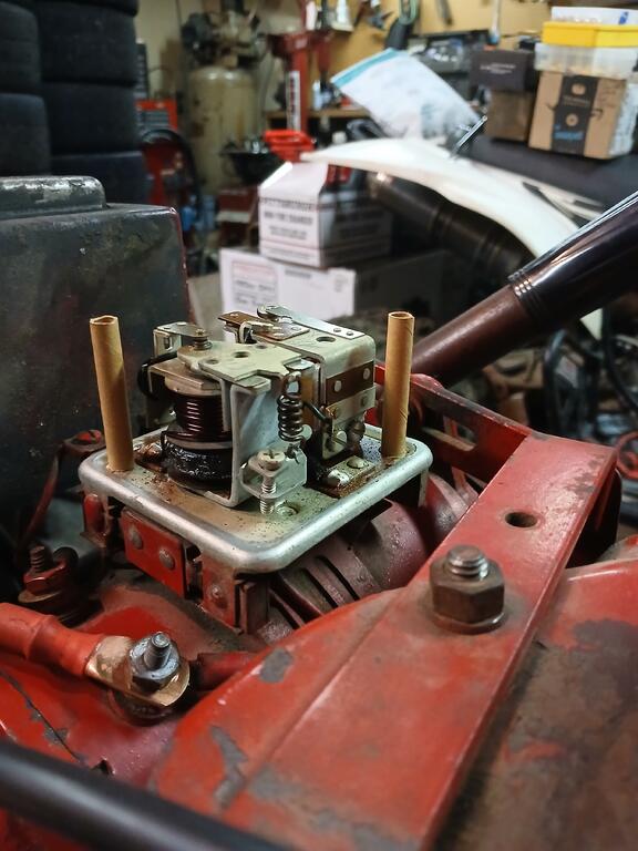

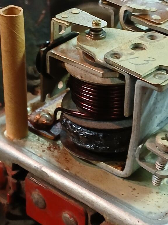

adsm08 5,247 #16 Posted March 16, 2025 1 minute ago, pfrederi said: The readings yo showed after you rebuilt t Those readings are not normal;12.61 I agree. It sounds like it is charging weakly and the battery is discharging slowly. Was the system polarized properly after the S/G rebuild? If not the regulator is likely fried (ask me how I know). Remove the two screws and the black cover from the regulator and look at the left rear corner as viewed from the seat. If you fried it the circled wire will be burnt off, just like it is in this picture: That's actually what happened to this regulator. I had the S/G rebuilt and forgot to polarize it before hitting the key. If that is what's wrong it is repairable. Select a piece of wire of about the same gauge, solder to the arm, wrap around the screw, adjust as necessary. Share this post Link to post Share on other sites

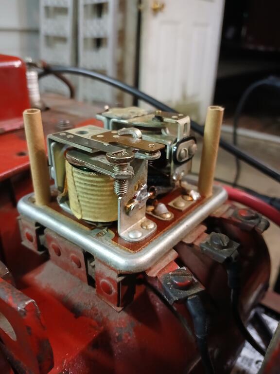

702854boy 1,245 #21 Posted March 17, 2025 @adsm08 I cant tell if anything is fried or not and mine looks a little bit different than yours does. Share this post Link to post Share on other sites
adsm08 5,247 #22 Posted March 17, 2025 7 hours ago, ri702bill said: Look over these ancient Delco-Remy files. The output voltage IS adjustable - early models had a screw, later ones the screw is gone - you have to gently bend the spring tab... a little goes a long way.... DELCO-REMY_SERVICE_BULLETIN.pdf 59.03 MB · 2 downloads Delco Remy IMG-150 Service Bulletin.pdf 722.78 kB · 0 downloads Delco Remy Regulator Manual 1R-116.pdf 1.76 MB · 0 downloads delco_remy_regulator_service 1R-111.pdf 1.06 MB · 0 downloads Delco-Remy SG Repair.pdf 826.86 kB · 0 downloads DELCO-REMY_SERVICE_BULLETIN.pdf 59.03 MB · 0 downloads 15 minutes ago, 702854boy said: How would that be done The PDFs that @ri702billlinked to. Manual 1R-116, page 4. Share this post Link to post Share on other sites
adsm08 5,247 #23 Posted March 17, 2025 1 minute ago, 702854boy said: This picture, the trace in question is next to the cardboard tube. Runs from the button on the base plate to the button on the bottom of the arm right above it. Share this post Link to post Share on other sites
702854boy 1,245 #24 Posted March 17, 2025 23 minutes ago, adsm08 said: Runs from the button on the base plate to the button on the bottom of the arm right above it. Is this what your talking about Share this post Link to post Share on other sites
