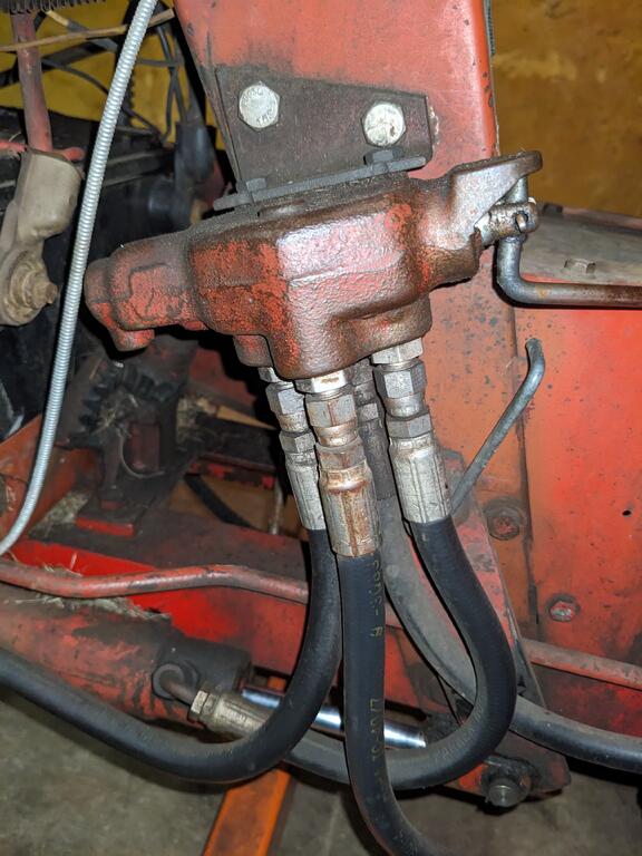

Handy Don 17,197 #10 Posted March 15, 2025 A picture will confirm what sort of valve you have for possible replacement Share this post Link to post Share on other sites
pfrederi 20,994 #11 Posted March 15, 2025 Control valves on Charger electros use a cup shaped ring not a pure o ring. A picture of your valve would help ID it... Share this post Link to post Share on other sites

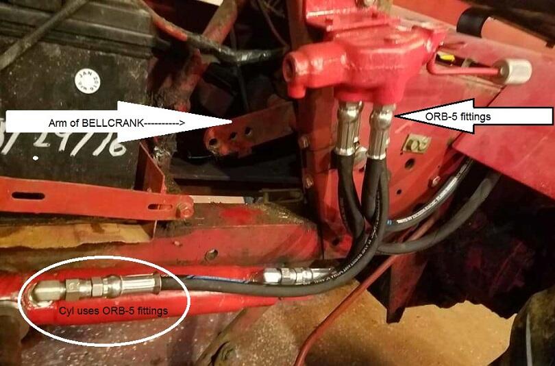

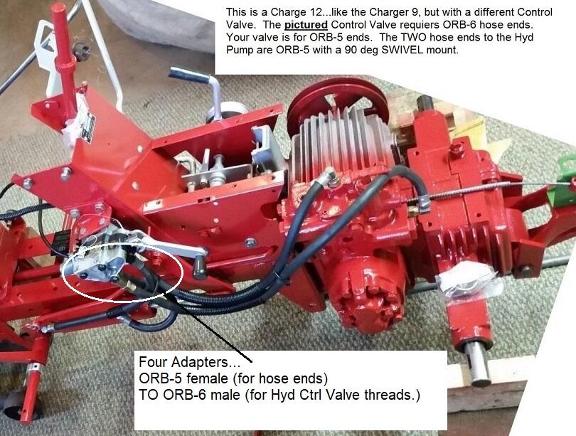

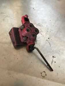

daveoman1966 3,884 #13 Posted March 16, 2025 (edited) My Bronco 14 had this style of hyd control valve and I swapped it out with a control valve from a newer model C-160. (Most of the C series after 1973 use this style of control valve.) Your 4 hyd lines to the 1276 are male end size ORB-5....as are the female threads of the control valve. The C-160 style hyd control valve has ORB-6 female threads. You will need FOUR hyd hose end adapters with ORB-5 FEMALE and ORB-6 MALE threads to make the same swap-over as I did. I got my fittings mail-order from OIL-AIR Products Inc P.O.Box 41430, Plymouth,l MN..55441 NOTE---if the replacement valve you use still leaks down, there are kits available to install new o-rings. Edited March 16, 2025 by daveoman1966 1 Share this post Link to post Share on other sites

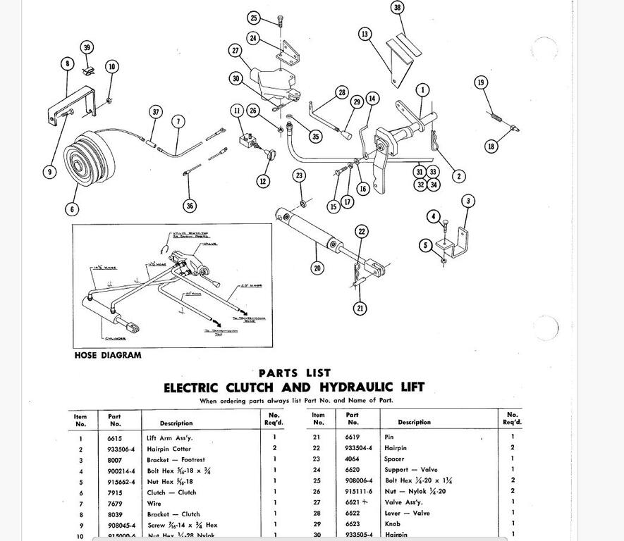

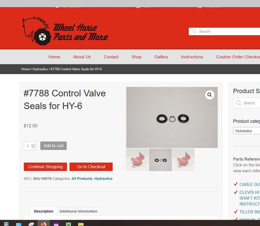

pfrederi 20,994 #14 Posted March 16, 2025 13 hours ago, kb65 said: Wheel Horse parts and more has the special cupped O rings and tiny snap ring Share this post Link to post Share on other sites
kb65 12 #15 Posted March 16, 2025 (edited) where do i get the valve shown on the charger 12? do you have a part # the o rings or cup seals only stop external leaks Edited March 16, 2025 by kb65 Share this post Link to post Share on other sites
pfrederi 20,994 #16 Posted March 16, 2025 6621 any used valve is probably going to need the cup seals... Share this post Link to post Share on other sites

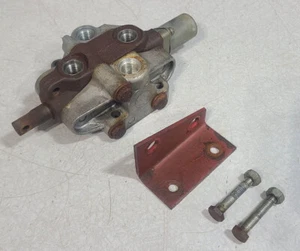

daveoman1966 3,884 #18 Posted March 18, 2025 This one sold on Ebay---it is from a B-100 for parts only. This is the style that COULD replace the older hyd valve you now have. To convert, you will need the ORB adapter fitting noted earlier There was ANOTHER ---just like yours---sold on Ebay...$50 bux. . Share this post Link to post Share on other sites
