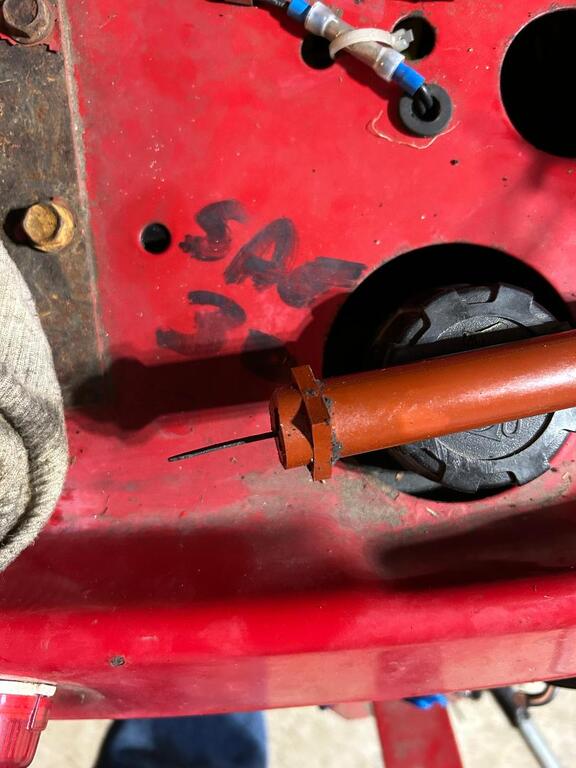

cgambino1018 28 #1 Posted March 13, 2025 1990ish 520H, when trying to pull the dip stick out of hydro, I broke the dip stick tube very close to the tranny. (see pic) I have not taken off the back cover yet. First I am trying to find out if I can buy a new tube? is it easy to screw off (without dripping plastic into the Tranny)? or will I be trying to JD welding it back on? All thoughts and advice appreciated. also, all hydro oil (5 qts) is out of the tranny right now. Chris 1 Share this post Link to post Share on other sites
WHX?? 57,640 #2 Posted March 13, 2025 (edited) Looks like it broke off flush with the case. Try and finesse it out with a needle nose. I doubt JB weld or some kind of plastic epoxy will work. Might not get it out without wrecking it but I'm sure some one has a replacement. put an add in wanted and try searching ebay. I may even have one have to look. Edited March 13, 2025 by WHX?? 1 Share this post Link to post Share on other sites
lynnmor 8,970 #3 Posted March 13, 2025 You can likely find one at A to Z, one of our vendors. Your biggest problem will be getting that broken piece out without getting fragments inside. It is just like a plastic pipe nipple and you might be able to force a square bar in and turn it out like an EZ Out. Just so you know, that SAE 30 should be 10W-30. 1 Share this post Link to post Share on other sites

Ed Kennell 46,794 #7 Posted March 13, 2025 I've used the tapered tang of a large file as an easy out. 4 1 1 Share this post Link to post Share on other sites

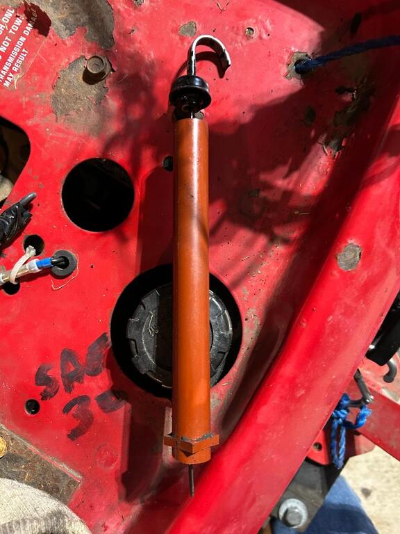

cgambino1018 28 #14 Posted March 16, 2025 All help is appreciated. I removed the back fender and now have a clearer pic of the other end of the dip stick tube. see link to pics. Wheel horse trany tube any advice on how to remove without dripping into the tranny is appreciated. Thank you in advance. Chris Share this post Link to post Share on other sites
Wayne0 1,606 #15 Posted March 16, 2025 4 minutes ago, cgambino1018 said: All help is appreciated. I removed the back fender and now have a clearer pic of the other end of the dip stick tube. see link to pics. Wheel horse trany tube any advice on how to remove without dripping into the tranny is appreciated. Thank you in advance. Chris File tang! 2 Share this post Link to post Share on other sites
wallfish 20,380 #16 Posted March 16, 2025 Or a large flay screwdriver. It's threaded so it will need to be twisted out. Maybe even heat the large screwdriver tip so it melts that plastic a little for some grooves which will give it something to bite to for spinning it. 2 Share this post Link to post Share on other sites

cgambino1018 28 #20 Posted April 3, 2025 reporting back. warming a fat flat screwdriver and just making an indent in the tube was a great idea.. once cooled the screw driver turned the tube with easy. ebinmaine. thanks again for the tube. Cheers all Chris 4 1 Share this post Link to post Share on other sites
