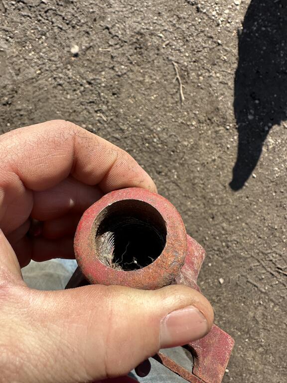

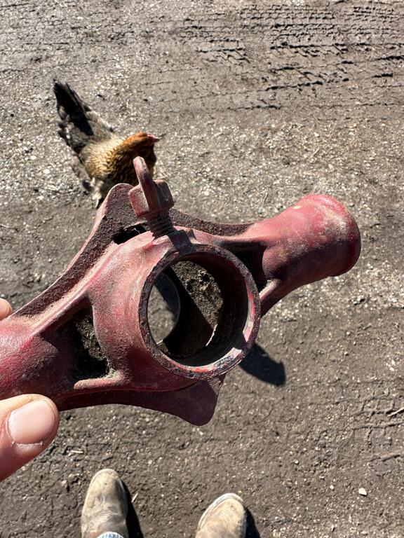

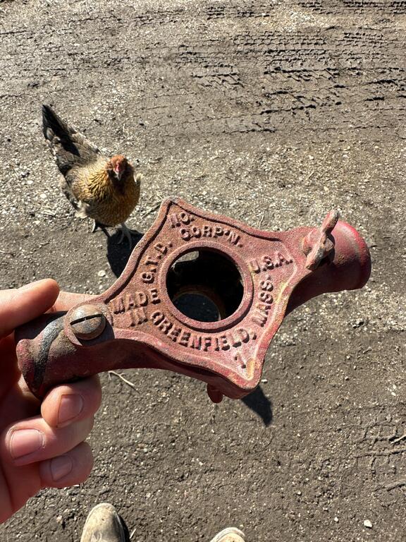

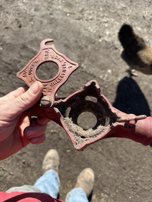

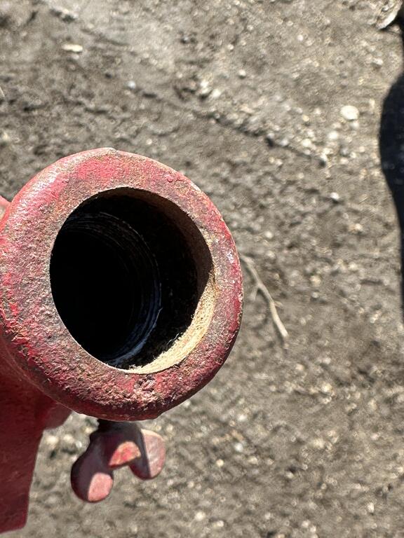

Pullstart 70,820 #1 Posted March 10, 2025 I don’t know the answer, but my first inclination is a tap handle. The ends are threaded for pipe “handles”, but what gets me is the thumb set screw on the back. What would it be for? 3 Share this post Link to post Share on other sites
953 nut 67,564 #2 Posted March 10, 2025 (edited) 30 minutes ago, Pullstart said: tap handle. Bingo, we have a winner. Most came in sets of 1/4, 3/8, 1/2, 3/4, and one inch pipe dies. You would provide the pipes for handles. Edited March 10, 2025 by 953 nut 5 Share this post Link to post Share on other sites
SylvanLakeWH 31,815 #3 Posted March 10, 2025 Large gauge die handle... but... would also work on that chicken's neck... 7 Share this post Link to post Share on other sites
ebinmaine 79,755 #4 Posted March 10, 2025 Very cool piece! Good Barn art! Share this post Link to post Share on other sites
WHX?? 57,472 #5 Posted March 10, 2025 1 hour ago, 953 nut said: Bingo, we have a winner. Yep got one just like it with all the dies... good shop art. 1 Share this post Link to post Share on other sites
Pullstart 70,820 #6 Posted March 10, 2025 What’s the thumb screw on the back for? Share this post Link to post Share on other sites
WHX?? 57,472 #7 Posted March 10, 2025 3 minutes ago, Pullstart said: What’s the thumb screw on the back for? Good ? ... I'll see if mine has that. 1 Share this post Link to post Share on other sites
Pullstart 70,820 #8 Posted March 10, 2025 2 minutes ago, WHX?? said: Good ? ... I'll see if mine has that. that’s what stumped me the most. Why would you want to lock onto the very piece you’re trying to spin the tool around? 1 Share this post Link to post Share on other sites

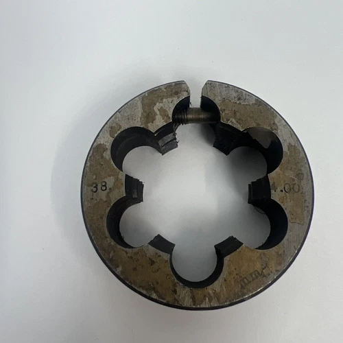

parsonsponyz 376 #9 Posted March 10, 2025 You put the pipe in the threaded ends then place the die in the middle and thumb screw holds that in place. 2 1 Share this post Link to post Share on other sites
SylvanLakeWH 31,815 #10 Posted March 10, 2025 Holds die in place... 1 1 Share this post Link to post Share on other sites
953 nut 67,564 #11 Posted March 10, 2025 5 hours ago, Pullstart said: What’s the thumb screw on the back for? It keeps the round die from spinning inside the unit, sets down in the opening in the die. 1 1 1 Share this post Link to post Share on other sites
Pullstart 70,820 #12 Posted March 10, 2025 I figured the die sat in the square space a bit higher. I see now! Share this post Link to post Share on other sites
