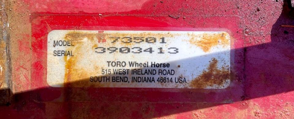

Wayne0 1,476 #11 Posted February 22, 2025 4 hours ago, 953 nut said: Not all 520s are wired the same, give us the Model number and it can be narrowed down. 1 Share this post Link to post Share on other sites

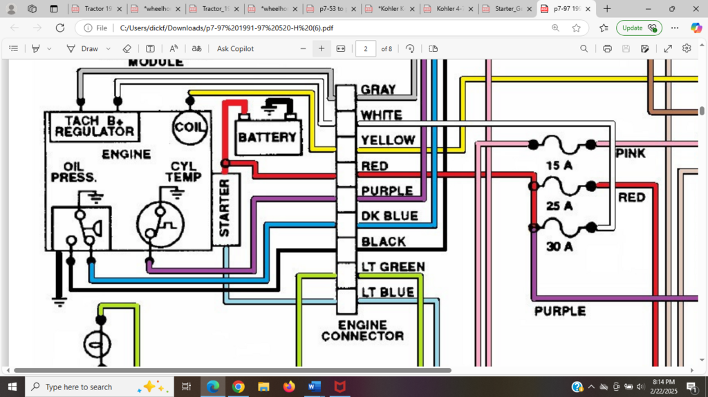

953 nut 63,984 #15 Posted February 23, 2025 Thanks for posting the model number. The white B+ wire from your voltage regulator goes through the 9 Pin connector to the 25 Amp Fuse then back through the 9 Pin on the Red wire on its way to recharge the battery. A bad fuse holder, fuse, 9 Pin or regulator connector could cause the lack of charging. Share this post Link to post Share on other sites
Wayne0 1,476 #16 Posted February 23, 2025 @953 nut Thanks for that. I believe I solved the problem. Have AC in to the reg, but no DC out. 1 Share this post Link to post Share on other sites
