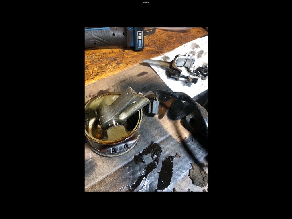

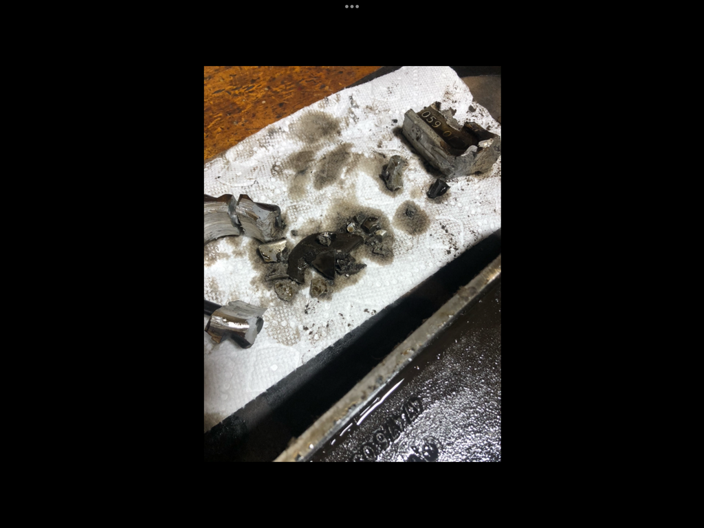

squonk 48,207 #14 Posted February 20, 2025 Probably broke the connecting rod. When it let go, it locked up for a second and that's why the belt flew off. 1 Share this post Link to post Share on other sites
richmondred01 2,393 #15 Posted February 20, 2025 Your rod is broken. Share this post Link to post Share on other sites

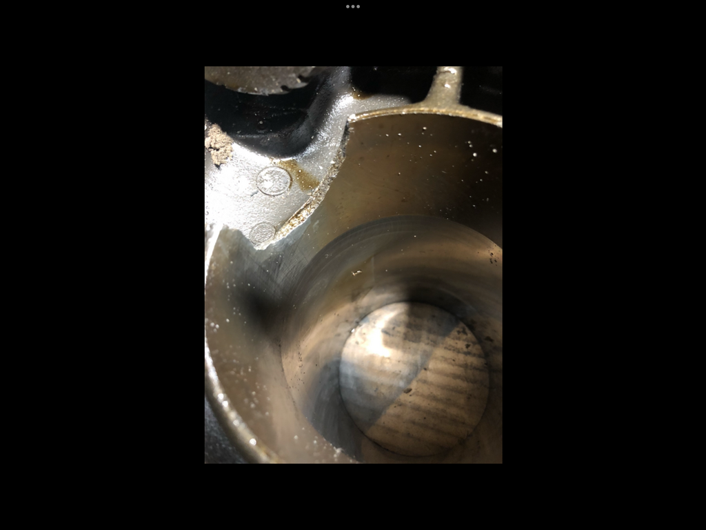

richmondred01 2,393 #16 Posted February 20, 2025 (edited) If it chipped the apron skirt you will need to sleeve the cylinder. Edited February 20, 2025 by richmondred01 3 Share this post Link to post Share on other sites
RED-Z06 2,720 #17 Posted February 20, 2025 Where was the oil level at failure? Share this post Link to post Share on other sites
Wheelhorse#1 1,997 #18 Posted February 21, 2025 9 hours ago, richmondred01 said: If it chipped the apron skirt you will need to sleeve the cylinder. @richmondred01Would it run without being sleeved if the skirt was broken ? Share this post Link to post Share on other sites
RED-Z06 2,720 #19 Posted February 21, 2025 16 minutes ago, Wheelhorse#1 said: @richmondred01Would it run without being sleeved if the skirt was broken ? If the cylinder is broken high enough that the thrust face of the piston pushes into it, or if the ring catch it, it might run...briefly, the cylinder skirt helps to stabilize the piston at the bottom of the stroke. 2 Share this post Link to post Share on other sites
richmondred01 2,393 #20 Posted February 21, 2025 1 hour ago, Wheelhorse#1 said: @richmondred01Would it run without being sleeved if the skirt was broken ? It may run for awhile, maybe not, but why do a have smacked job? Do it once and do it right. 2 Share this post Link to post Share on other sites
