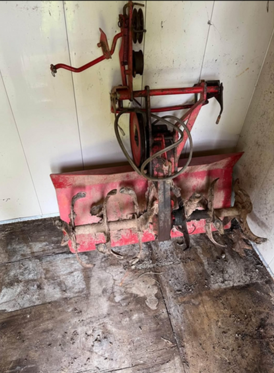

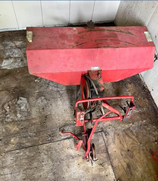

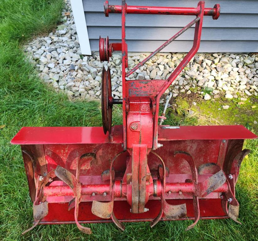

HyperPete 939 #76 Posted February 23, 2025 Ok, so I guess I should focus on function over form. I can always get another tractor in the future if I want. I need a rototiller. I can always buy a walk-behind unit, but with 2 trashed shoulders and a painful damaged wrist, I'd rather not go that route. Knowing, now, that a 6-speed or 8-speed is what I want, and the rototillers seem better suited for newer models, what should I consider? Or, do I just rent a rototiller this spring, and wait for the show? This rototiller is available, but "buried in a shed right now", so I can't inspect it. They are also asking $400, which you have told me is pretty much top end for one in great condition. Share this post Link to post Share on other sites
kpinnc 18,836 #77 Posted February 23, 2025 (edited) 40 minutes ago, Pete D said: This rototiller is available, but "buried in a shed right now", so I can't inspect it. They are also asking $400, which you have told me is pretty much top end for one in great condition. That is actually in better overall shape- especially the tines. It looks like it has a bit of a leak on the shaft, but that might be beneficial when it comes time to replace the axle seal. Those tines can be an absolute bear to remove. Also, that is an older tiller (1967- probably 1972). All the hookups with it should work with tractors more like what you've been looking at. If the axle bearings are good- the price is in the "not crazy" range. You can check the bearings by hand: with the tiller standing off the tines, you shouldn't be able to wiggle them up or down and side to side. Minor In/out axial is ok because the axle is solid. Edited February 23, 2025 by kpinnc 1 Share this post Link to post Share on other sites

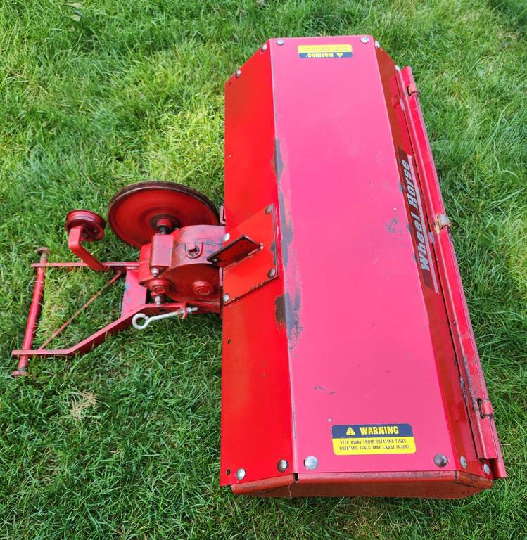

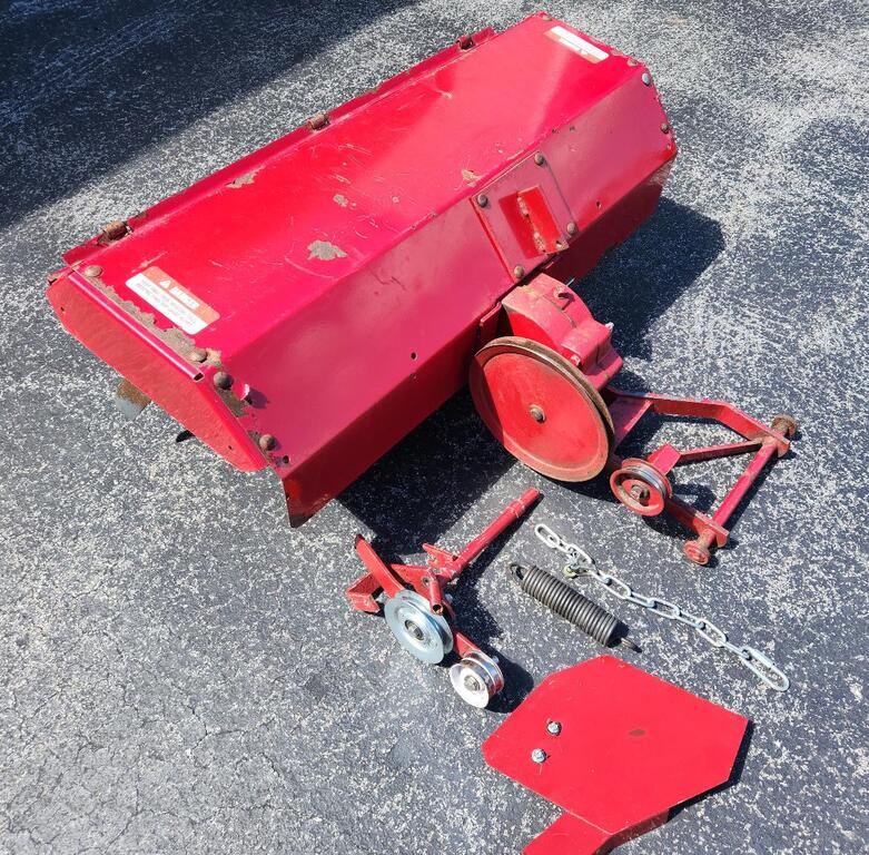

Dan 312-8 594 #81 Posted February 23, 2025 Pete, This is from craiglist (Lebanon, PA), about an hour or so from you. Been posted for a while. It has Toro decals on it, so it's for the newer models as @c-series don mentions. "Wheel horse tiller for sale.call 7179263783 only.. It has new seals in it And was repainted in the detail..Lebanon pa" 1 Share this post Link to post Share on other sites

HyperPete 939 #83 Posted February 23, 2025 10 minutes ago, Daniel Bailor said: Pete, This is from craiglist (Lebanon, PA), about an hour or so from you. Been posted for a while. It has Toro decals on it, so it's for the newer models as @c-series don mentions. "Wheel horse tiller for sale.call 7179263783 only.. It has new seals in it And was repainted in the detail..Lebanon pa" I saw that on FB marketplace, listed twice, but he does not show the tines, and he also lists some highly modified items, making me wary of what he is selling. 1 Share this post Link to post Share on other sites

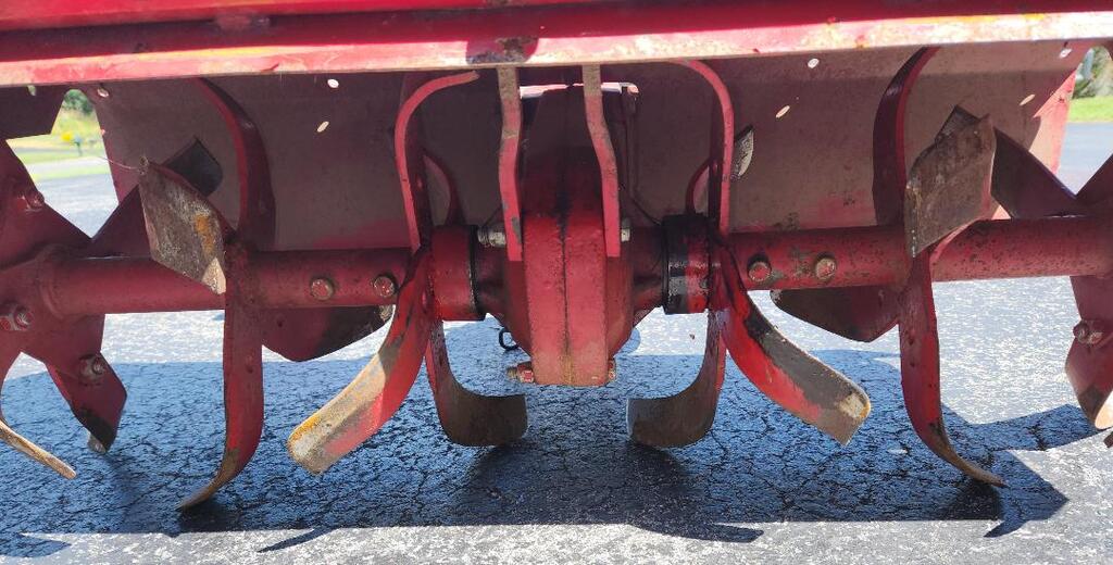

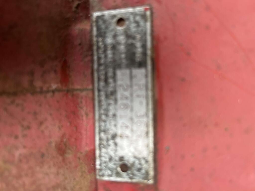

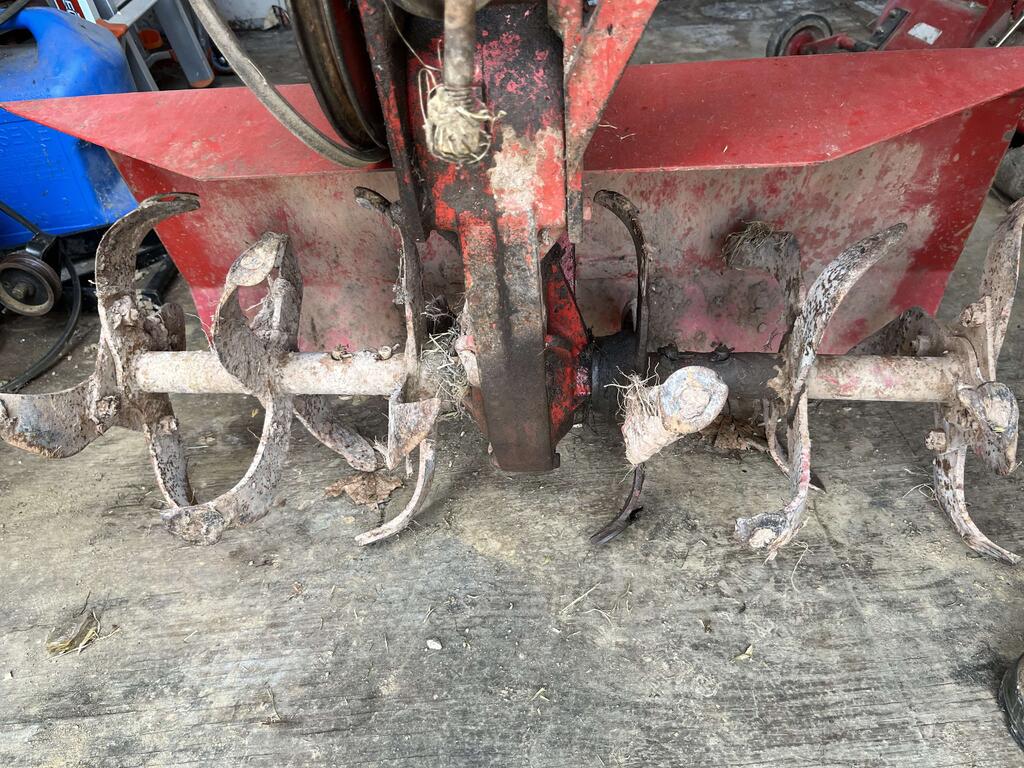

HyperPete 939 #87 Posted February 23, 2025 (edited) Well, this one is a bit dirty, and the right side needs some attention, but they are asking 400. I'll point out the seal and see if they will accept 350. It's been on marketplace 7 months. * 36” Rt-366. 246144 * Edited February 23, 2025 by Pete D Share this post Link to post Share on other sites
kpinnc 18,836 #88 Posted February 23, 2025 1 hour ago, Pete D said: Well, this one is a bit dirty, and the right side needs some attention, That picture is better than the previous one. Someone welded something on the tips of those tines. So they are worn more than I previously thought. And while that tiller will fit newer models, the front pulley assembly shown with it will not. The assembly is for pre-1972 models. 1 Share this post Link to post Share on other sites
c-series don 12,293 #89 Posted February 23, 2025 Nope personally I’d hold off on purchasing that. 1 Share this post Link to post Share on other sites

HyperPete 939 #92 Posted February 24, 2025 (edited) @kpinnc - I looked more closely at that photo of the rototiller, and I see exactly what you were saying about something being welded on them. Looks like big washers or something. So I canceled next Saturday to go see it. @c-series don & @Handy Don - I have located a C-121 not too far from me. The guy has about 20 wheel horses, so I think I'm going to take a ride out there and see what he's got. He has a bunch with bad engines, but unless I can find a bolt-in engine, I'm really not thinking that I want to deal with a complete overhaul. (Maybe if I can grab something for $100 I will consider finding an engine). I know that things like engine overhauls can get expensive very quickly, and I want to have this ready by spring tilling season without dumping big money into it. I guess it's time for me to re-register my trailer and get going to see some stuff. Edited February 25, 2025 by Pete D Share this post Link to post Share on other sites

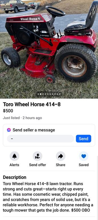

HyperPete 939 #97 Posted February 25, 2025 I keep looking. This just came up. Very boring style to me, but function over form (for now). Many more photos, but this thread is already too long. Attach-o-matic? 1 Share this post Link to post Share on other sites
ebinmaine 80,045 #98 Posted February 25, 2025 25 minutes ago, Pete D said: Attach-o-matic Yep Share this post Link to post Share on other sites
adsm08 4,881 #99 Posted February 25, 2025 I'd pay $500 for that. 1 1 Share this post Link to post Share on other sites
HyperPete 939 #100 Posted February 25, 2025 1 hour ago, ebinmaine said: 1 hour ago, Pete D said: Attach-o-matic Yep So, 1) Is the tractor decent at 5 bills, and 2) is "attach-o-matic" a pro or a con? 1 Share this post Link to post Share on other sites
