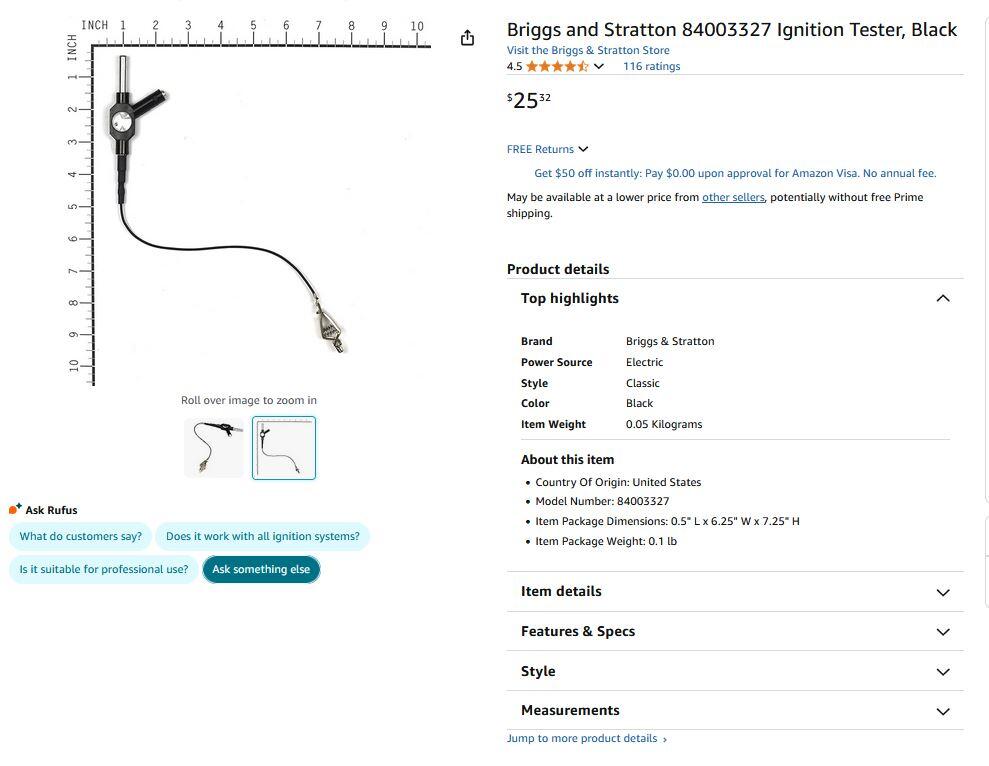

ebinmaine 80,279 #26 Posted February 16, 2025 Somebody have a part number for this tester? I'd love to have one. Share this post Link to post Share on other sites
pfrederi 21,046 #27 Posted February 16, 2025 (edited) 7 minutes ago, ebinmaine said: Somebody have a part number for this tester? I'd love to have one. There are a lot of cheaper knock offs Edited February 16, 2025 by pfrederi 2 1 1 Share this post Link to post Share on other sites

Racinbob 13,110 #29 Posted February 16, 2025 25 minutes ago, Ed Kennell said: Bob, did you have a spark tester on at the 20 minute mark. Any difference in the spark when she got ill.. Oops,I see Paul types faster than me. Not at the 20 minute mark. But my tester is or is the same as the cheap HF thingy. Share this post Link to post Share on other sites

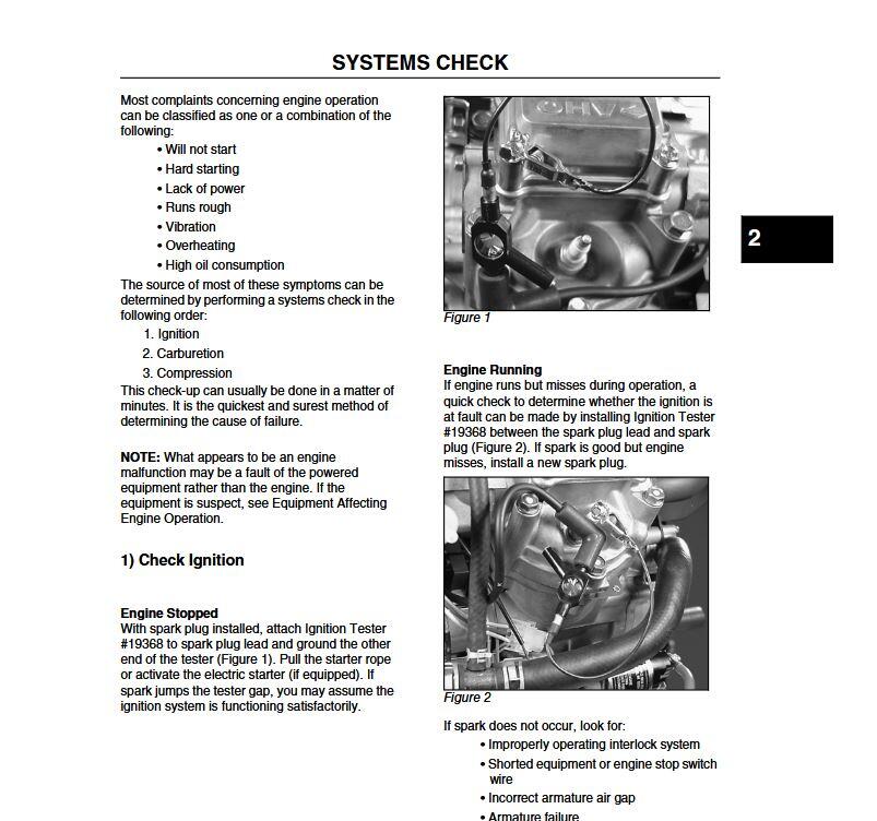

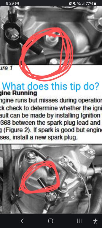

ebinmaine 80,279 #32 Posted February 16, 2025 See pic. What does the circled (extra) metal tip do?? Apologies for hijacking @Racinbob. I'm hoping this is semi related to the learning curve for myself and others. 1 Share this post Link to post Share on other sites

Racinbob 13,110 #34 Posted February 16, 2025 4 minutes ago, ebinmaine said: See pic. What does the circled (extra) metal tip do?? Apologies for hijacking @Racinbob. I'm hoping this is semi related to the learning curve for myself and others. My threads can't be hijacked Eric. I think that's to check the spark on your big truck. I just ordered one of Pauls type. 1 1 Share this post Link to post Share on other sites

Lane Ranger 12,092 #36 Posted February 16, 2025 I bought two like Paul has several years ago. They work great and are reasonably priced ! They work well too! You can see without getting shocked!!! 1 Share this post Link to post Share on other sites

David Blanchard 14 #48 Posted February 16, 2025 5 hours ago, ebinmaine said: See pic. What does the circled (extra) metal tip do?? Apologies for hijacking @Racinbob. I'm hoping this is semi related to the learning curve for myself and others. The extra leg is for sticking into a regular coil 1 Share this post Link to post Share on other sites

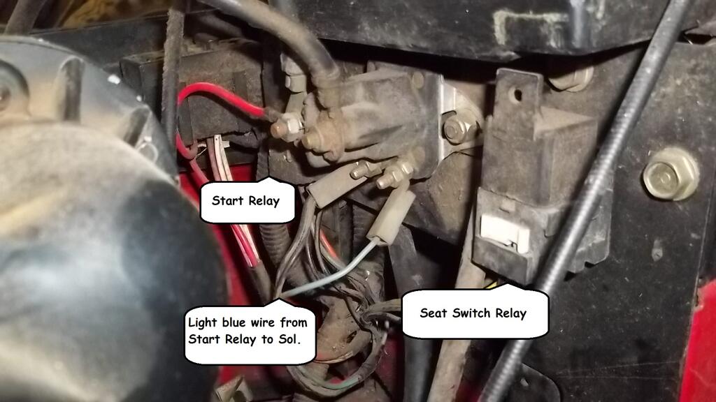

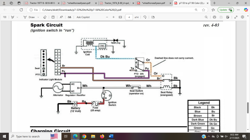

953 nut 68,503 #49 Posted February 17, 2025 Eliminating some of the rabbit holes that you have been told to look down I took a look at the wiring diagram (my guess is you already did that). There is no kill relay so that isn't the problem. The clutch and neutral switches have nothing to do with maintaining ignition. Much like any other model the PTO switch and seat switch (and relay) are a part of the ignition system. If you locate and unplug the seat switch relay it can no longer provide a path to ground for the magneto. If that allows mowing beyond the twenty minute mark then a new $ 5.00 relay could be all you need. 2 Share this post Link to post Share on other sites
Racinbob 13,110 #50 Posted February 17, 2025 (edited) For the sake of this thread, I just went ahead and assumed that the 'kill relay' that was referred to was anything that would kill the engine when I didn't want it to. On this tractor that would be the seat and PTO switches. Again, with the issue being what it is and not actually killing the engine I don't see it as being electrical. Regardless, the potential culprits have already received the electrical version of a catalytic converter test tube. Of course, it will be removed when the problem is found. Edited February 17, 2025 by Racinbob 1 1 Share this post Link to post Share on other sites
