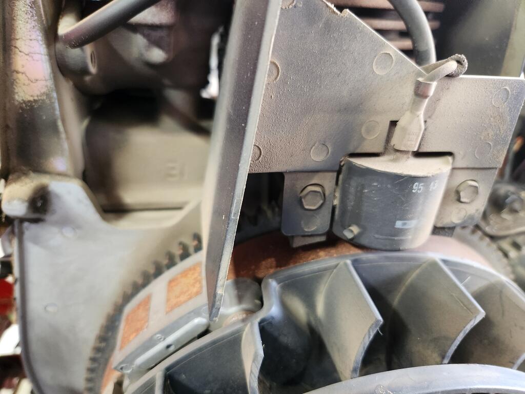

Racinbob 13,290 #8 Posted February 16, 2025 11 minutes ago, David Blanchard said: Realy does sound like fuel issue but sometimes I have used inline B&S spark tester to verify the spark stays strong &blue not yellow and weak just enough for engine to stay running Yup. I know it does. But I'm confident it isn't. The spark it strong but I wonder if the coil heating up might be a thing. Share this post Link to post Share on other sites

ri702bill 13,393 #10 Posted February 16, 2025 My money is on a bad coil. Had one on a 7HP Kohler that you could set your watch by - 7 minutes. Did the inline spark checker - great spark when cold. After it heated up 7 minutes later - no spark. 6 Share this post Link to post Share on other sites
Racinbob 13,290 #11 Posted February 16, 2025 8 minutes ago, Ed Kennell said: Could a valve be affected by heat causing a failure to close???? I was wondering about that Ed. I guess the head has to come off to check that. I'm not sure what to look for to determine that. Or what to do. 8 minutes ago, ri702bill said: My money is on a bad coil. Had one on a 7HP Kohler that you could set your watch by - 7 minutes. Did the inline spark checker - great spark when cold. After it heated up 7 minutes later - no spark. I'm thinking I should just get one of those aftermarket coils coming. It's obvious this tractor had the issue when I bought it. But I truly believe the seller didn't know about it. First, he seemed like a great guy. Then, considering it was only used to push snow it never saw the heat conditions that summer mowing brings. 1 Share this post Link to post Share on other sites

Racinbob 13,290 #21 Posted February 16, 2025 This is incredible but not unexpected here. I started this thread about an hour ago and already so much help. Thanks everyone and keep the ideas coming. So far I think this is my plan: 1) Order a head gasket and a coil 2) Get the tractor in the garage. 3) Check valve clearance 4) Pull head to inspect 5) Replace coil 6) Install exhaust 'test pipe' If I find something obvious along the way the steps could stop or be delayed. The plan is subject to modification based on more ideas from you all. 1 Share this post Link to post Share on other sites
