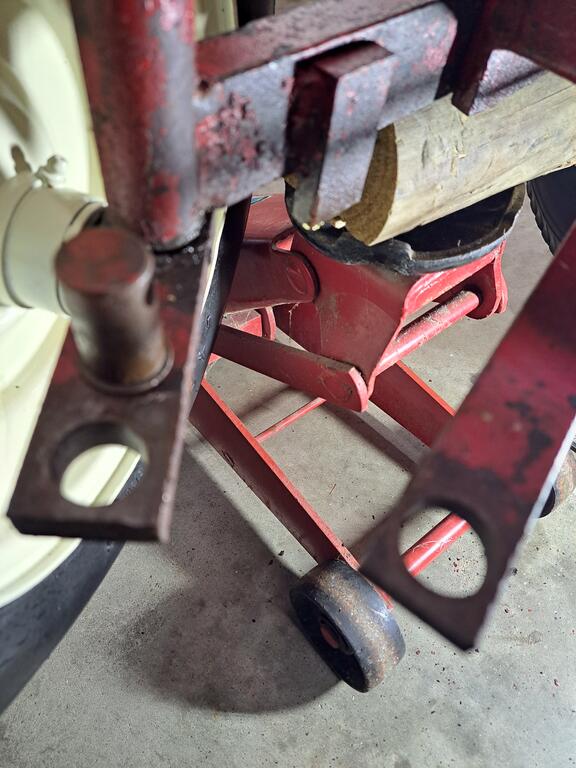

dmoore 1,034 #1 Posted February 13, 2025 Anyone know if these steering link pins are anywhere to be had? Thanks! Share this post Link to post Share on other sites

dmoore 1,034 #4 Posted February 14, 2025 Thanks, Looks like his last visit to the site was June 2022. Share this post Link to post Share on other sites

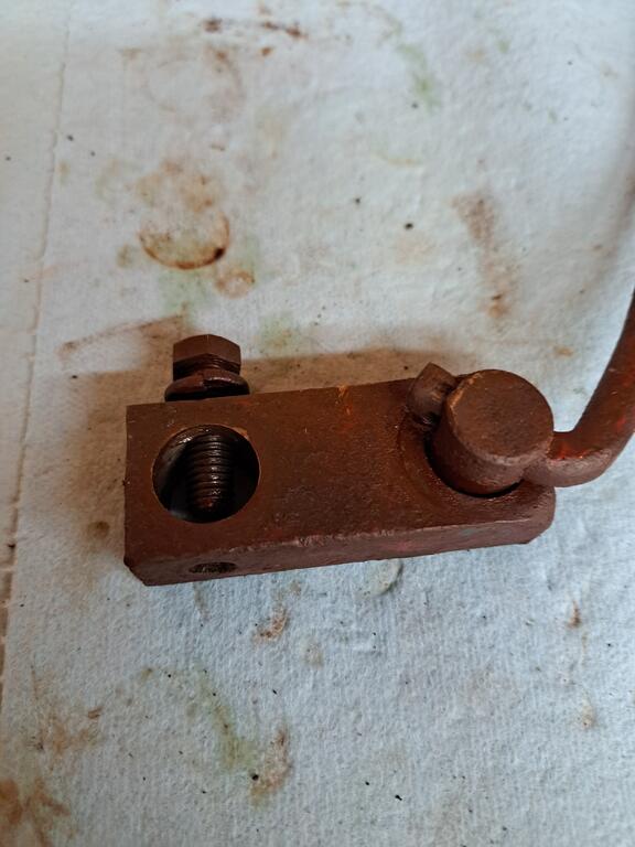

dmoore 1,034 #7 Posted February 15, 2025 I don't see how enough force would be present to make any difference in this application. Mine has actually been drilled out and tapped with a bolt being used rather than the roll pin. Sure would like to find 2 of those pins! Share this post Link to post Share on other sites
wallfish 20,217 #8 Posted February 15, 2025 Are those steering pins themselves worn or is it the steel pieces that are worn? or both? The holes in the steel can be drilled and bronze bushings used to take up the slop. If you drill them so the bronze goes in tight is also squishes the hole closed too. Then the original pins can be spun down to fit if they're not worn too much to begin with. That could be done carefully with a file. @MikesRJ did a complete thorough thread (a long time ago) documenting EVERYTHING he did on a full blown RJ-58 restore. Maybe you can find the thread if it didn't get wiped out when the forum moved. Tons of good information on every aspect of those tractors. There will definitely be enough forces involved to pinch those pin slots closed on that steering block, otherwise nothing would ever wear out in the first place. Share this post Link to post Share on other sites
dmoore 1,034 #9 Posted February 15, 2025 The pins seem to be worn more than tye flat bar. I believe I did see @mikesrj thread. May have to revisit. Thanks Wallfish! Share this post Link to post Share on other sites

dmoore 1,034 #11 Posted February 15, 2025 Mike I looked through your thread but couldn't find page concerning that. Looks like pics are gone as well? Share this post Link to post Share on other sites
MikesRJ 562 #12 Posted February 15, 2025 (edited) 5 minutes ago, dmoore said: Mike I looked through your thread but couldn't find page concerning that. Looks like pics are gone as well? Long story short I heated the piss out of the shaft and drove the old pin out. Chucked both shaft and block in a vice and drilled an oversize hole and used a larger spring pin. Too long ago to remember dimensions though. As for the pins, I had a local machine shop turn a pair for me. Edited February 15, 2025 by MikesRJ Share this post Link to post Share on other sites
dmoore 1,034 #13 Posted February 15, 2025 Gotcha, I have a shop here..if he can't remake them they can't be remade! Looks like someone drilled and tapped my block to utilize a bolt. 1 Share this post Link to post Share on other sites
