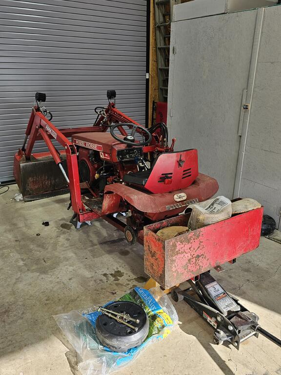

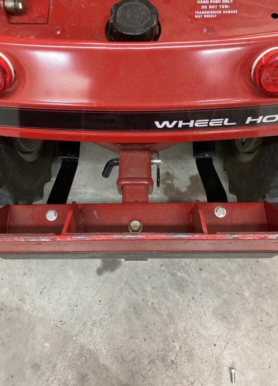

HyperPete 949 #1 Posted February 11, 2025 Weights are an attachment right? My 1-0440 has a weight box I just removed to sand & paint, but I also have 4 JD suitcase weights. I can't imagine that it would be too hard to fab amount for these, so my question is, which would be "better"? No, I don't have a definition for "better". I also have beet juice filled rear ag tires and wheel weights. 2 Share this post Link to post Share on other sites

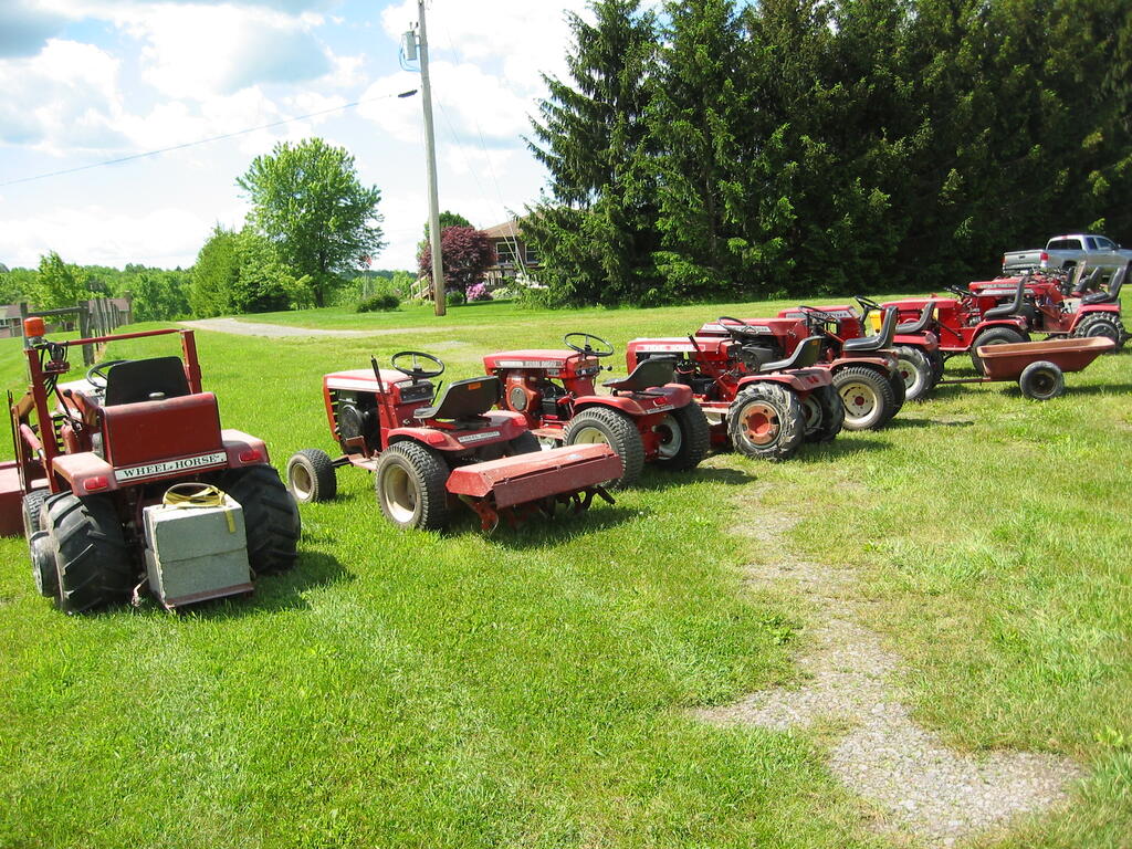

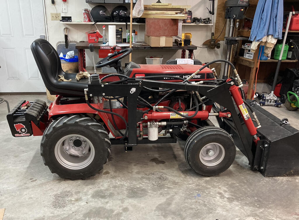

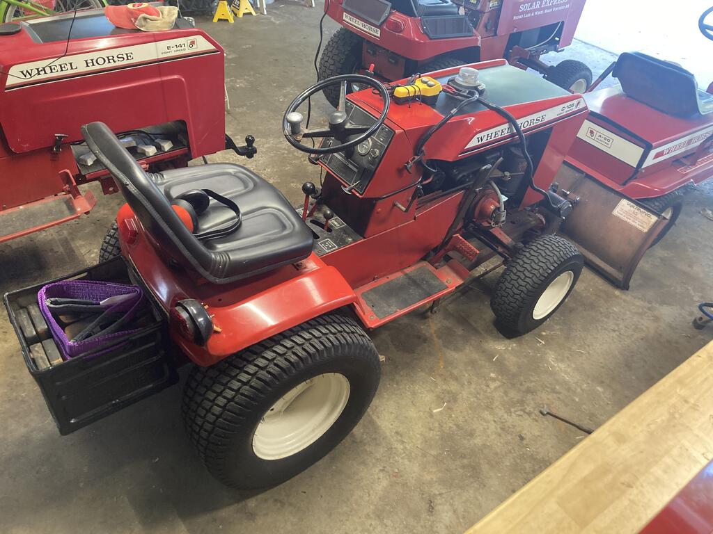

WHX?? 58,388 #2 Posted February 11, 2025 (edited) Hey Pete Which type it purely what you prefer. Weight is weight no matter what type. I like suit cases as one can take them off to get at things for maintenance or if not needed. Or move them to another tractor. I like a box too ... you can keep chains, tools, hitches and other possibilities in it as well as weights. Always seems out on the ranch working those lifting chains are back at the warehouse! Best of both worlds I have a box and put suit cases in it. and other heavy chunks of steel. Plain old simple chunks of heavy rocks work good in a box for filler. The ags with juice are a huge plus inside and outside weights. This FEL i now have a 2" automotive type receiver out the back for a ball or draw bar Edited February 11, 2025 by WHX?? 2 2 Share this post Link to post Share on other sites
HyperPete 949 #3 Posted February 11, 2025 Nice setup! I may have to try to emulate that. 1 Share this post Link to post Share on other sites
WHX?? 58,388 #4 Posted February 11, 2025 Thanks ... I don't like my box ... not big enough. Should be more like yours but just something I had laying around. 1 Share this post Link to post Share on other sites

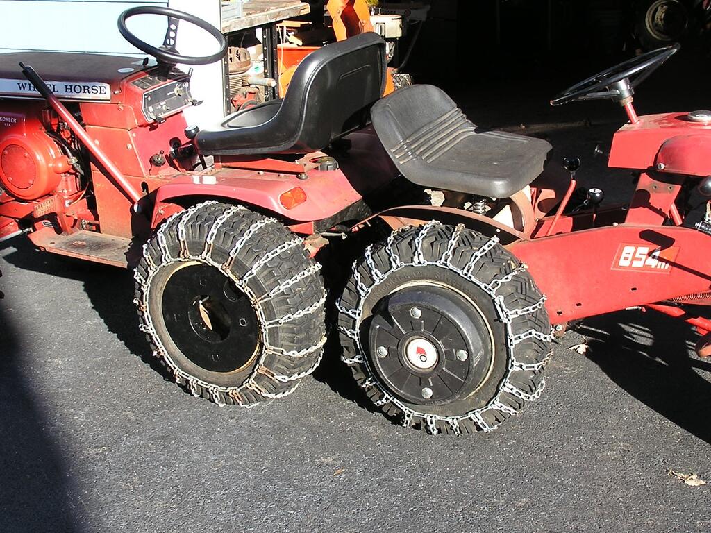

ri702bill 13,394 #7 Posted February 11, 2025 6 hours ago, WHX?? said: plus inside and outside weights. The "best" choice to add weight - does not affect the axle bearings - just like running filled tires..... My C81 has filled tires, chains with extra cross links - weigh about 75 pounds each. A 75 pound cast iron outer weight with a 20 pounder inside it - another 95 pounds each. Total added weight is over 340 pounds - all in or on the tires..... 2 2 Share this post Link to post Share on other sites
ebinmaine 81,282 #8 Posted February 11, 2025 @1mor Project. @ri702bill makes a great point. Do all you can to get more weight inside the tires, along with inside and outside the wheel FIRST. 2 Share this post Link to post Share on other sites
WHX?? 58,388 #9 Posted February 11, 2025 3 hours ago, ebinmaine said: outer wheel bearings could/ should have been a little more robust. but guys are carrying a lot more weight than what I am and they don't seem to be worried so I'm not gonna either. @Ed Kennell has got a stack of gym weights on that gotta be a ton. Tapered bearings would have been nice but it is what it is. Keep the tranny oil fresh & clean & hubs tight I guess. 1 1 Share this post Link to post Share on other sites

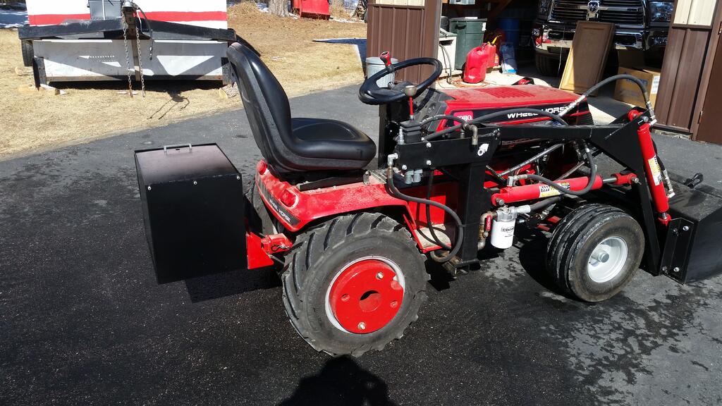

pfrederi 21,342 #14 Posted February 11, 2025 Since The original; question involved a FEL I have to say i do not think you can avoid using some sort of weight box. There is no way you can come up with sufficient weight in filled tires, inner and outer wheel weights. My D200 has big filled tires, outside weights and a counter weight of two large Cement block filled with cement. She could use more counter weight as she can get a bit tippy when i pick up something really heavy. 4 1 Share this post Link to post Share on other sites

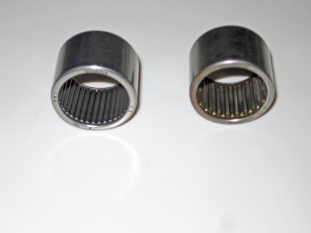

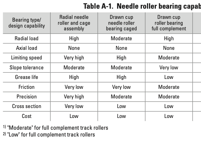

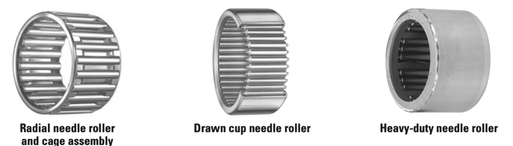

pfrederi 21,342 #16 Posted February 11, 2025 5 minutes ago, ebinmaine said: I've been wondering for several years if there was such a thing as a super heavy duty B1816 bearing or, using a wider one would be better, or a different brand is better than another one. Smaller rollers versus larger rollers. Things like that. Interesting thoughts I have come across two styles of needle bearings in WHs I assume the full complement (left) are better but The spaced ones were used by WH at some points. I use the full complement ones when i replace them. 2 1 1 Share this post Link to post Share on other sites
WHX?? 58,388 #17 Posted February 11, 2025 9 minutes ago, pfrederi said: I have come across two styles of needle bearings in WHs Interesting ... Wonder what the difference in ratings are on the two. Share this post Link to post Share on other sites
ri702bill 13,394 #18 Posted February 11, 2025 McMaster listing may tell you..... Share this post Link to post Share on other sites
ebinmaine 81,282 #19 Posted February 11, 2025 20 minutes ago, pfrederi said: I use the full complement ones I use those on my bigger heavier C Series tractors. On Trina's smaller lighter machines I don't get concerned either way. 10 minutes ago, WHX?? said: Interesting ... Wonder what the difference in ratings are on the two. 1 minute ago, ri702bill said: McMaster listing may tell you..... I feel a research project coming on 1 Share this post Link to post Share on other sites
Ed Kennell 47,946 #20 Posted February 11, 2025 1 hour ago, ebinmaine said: I feel a research project coming on I think we did this a few years back. I sorta remember due to the slow speed and low loads, the bearing life wasn't affected by increasing the load from 500 to 700 lbs. Maybe @Handy Don will do the math. 2 Share this post Link to post Share on other sites

Handy Don 17,735 #23 Posted February 11, 2025 I dug through some articles on calculating allowed static and dynamic radial loads on bearings (the later being the supported load while the bearing is rotating within its specified speed range). The limits are where the force causes either the needle or the cup to incur inelastic deformation. Conceptually very neat, but the formula for static is very complex and the industry standard for calculating dynamic is to simply apply a “load factor” to the static. Then I realized these numbers are probably readily available in the catalogs for off-the-shelf bearings like the B1816. And they are. Below are two clips from Koyo Bearing’s engineering document. WH transaxle outer bearings use drawn cup style, either caged or full complement. The chart mentions the comparative difference in radial load for the two types (Moderate and High, respectively). BTW, axial loading is along the direction of the axle--WHs don’t put any. Elsewhere I found the B1816 specs (drawn cup, full complement) for static and dynamic load and converted them to pounds. Static: 18,142 lbs. Dynamic: 7.846 lbs. Remember that in most tractor situations, there will be two bearings, one for each axle, sharing the load equally. 2 Share this post Link to post Share on other sites
ebinmaine 81,282 #24 Posted February 11, 2025 25 minutes ago, Handy Don said: Elsewhere I found the B1816 specs (drawn cup, full complement) for static and dynamic load and converted them to pounds. Static: 18,142 lbs. Dynamic: 7.846 lbs. Remember that in most tractor situations, there will be two bearings, one for each axle, sharing the load equally I know these Transmissions are over built but those numbers are far higher than I thought they were 1 Share this post Link to post Share on other sites
