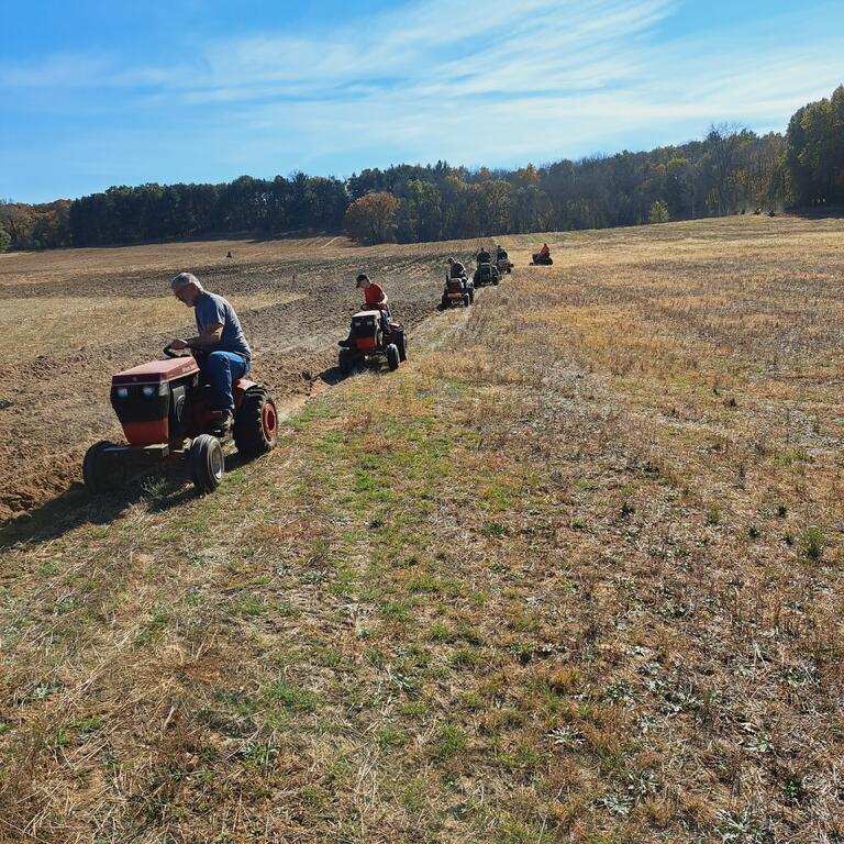

WHX?? 55,299 #5 Posted February 9, 2025 Yeah a 312-8 with a 10 0r 12" Brinly is the way to go. An excellent combo. Plows go for 125 -150 good used and a slot hitch adapter for way less than 100 or a Brinly hitch for 80 -100. You might need some ags & weights but there are workarounds there too. Load some turfs and chains. Lets see your tractor Ed. If you can't turn clay your not set up properly. Every soil type requires a different set up. New plots can be difficult but just gotta stay at it. Lots of good threads here on plowing. A Suburban cutting the mustard and when the big boys get together. 2 Share this post Link to post Share on other sites

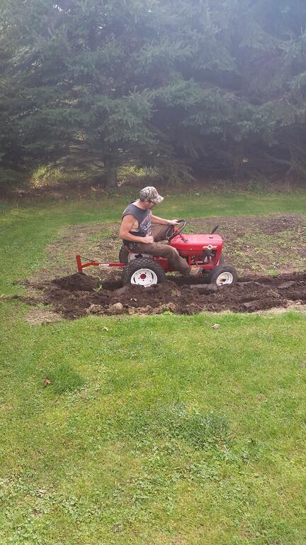

WHX?? 55,299 #6 Posted February 9, 2025 A really good one by @PeacemakerJack Share this post Link to post Share on other sites
