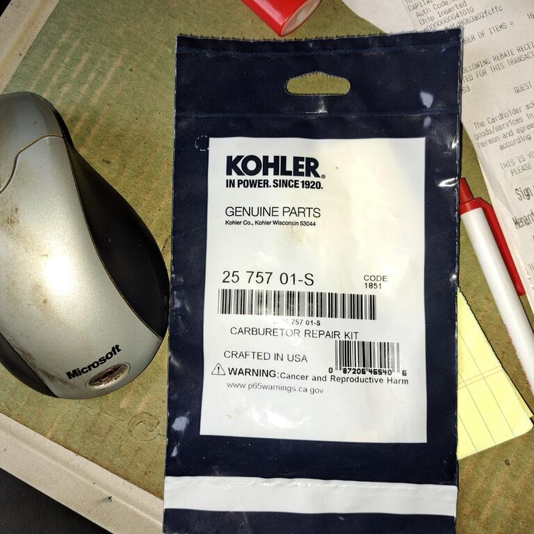

WHX?? 57,799 #26 Posted February 9, 2025 Definitely need a new plunger and something doesn't look right with the inlet seat. Correct one would not have the screwdriver slots. When rebuilding carbs ALWAYS use a Kohler kit. That one has not. The needles look pretty rough too. @ebinmaine care to add? Time for a new carb. Try https://isavetractors.com/ or yes K&B if not fond of offshores. http://www.psep.biz/index.htm used to have them best call to see if they still do. if you see them for this price it's an off shore https://www.amazon.com/labwork-Carburetor-Kohler-4685301-S-4605303-S/dp/B0719B6PD5/ref=asc_df_B0719B6PD5?mcid=349f01a53b0f344693cf781c0f2421f8&tag=hyprod-20&linkCode=df0&hvadid=693770001515&hvpos=&hvnetw=g&hvrand=4393961188063983633&hvpone=&hvptwo=&hvqmt=&hvdev=c&hvdvcmdl=&hvlocint=&hvlocphy=9019459&hvtargid=pla-523073608488&psc=1 Personally i've not had much problems with them but others have reported bad luck. Points push rod may be found here http://www.psep.biz/store/kohler_points_condensers.htm but again best call. I don't have one apart to get a measurement on length. Share this post Link to post Share on other sites

WHX?? 57,799 #31 Posted February 9, 2025 Just now, dmoore said: That's what you get nowadays in a kit. Yes Mr. Moore in the offshore kits which aren't worth a hill of beans and again are dirt cheap ... 4 for 10 bucks. Ok if you are just going to use the gaskets for bowl cleanings but DO NOT use the the inlet parts they will not work. You must get the one that are in the Kohler packages --- around 15 for one! 2 minutes ago, dmoore said: $46.00 for that little points rod?? Ha! Yeah,ok....And $18.00 for the other??? Must be rare as hen's teeth! I agree Kohler parts are getting nuts but shop around ... You'll find them much cheaper. You can get the ones for big blocks and trim to length. Diameter is the same. https://isavetractors.com/points-plunger-push-rod-for-kohler-k-series-engines/?srsltid=AfmBOoos0L-Clw265Q-caDq3CbGTmOugMeqpbmPTnT2GHevfFP-d_JUik8E&gQT=2 https://www.ebay.com/itm/186557649517?chn=ps&mkevt=1&mkcid=28&google_free_listing_action=view_item&srsltid=AfmBOoptpfagZ3O8U3riWmlzHizIRpFBm-rlqwlq9EfbvG6c9VglZTfUiAs&com_cvv=8fb3d522dc163aeadb66e08cd7450cbbdddc64c6cf2e8891f6d48747c6d56d2c 1 Share this post Link to post Share on other sites

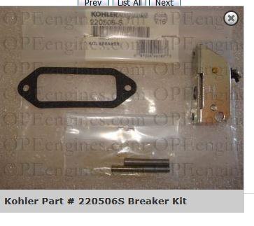

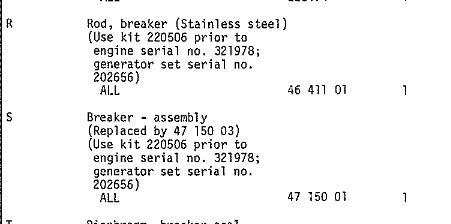

pfrederi 21,046 #32 Posted February 9, 2025 Points push rod apparently changed after a point. If you google eh Kohler Kit 220506 (used on older engines) it comes with two different push rods. 4 Share this post Link to post Share on other sites
