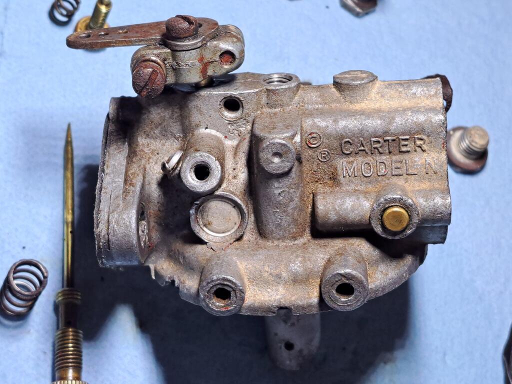

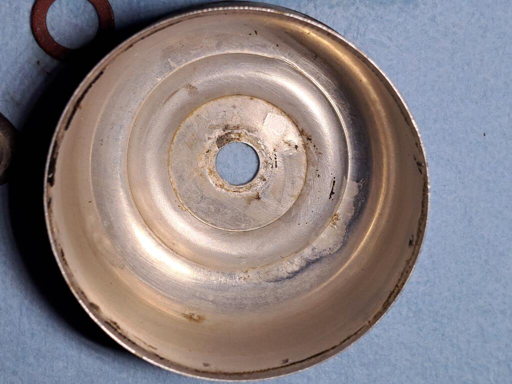

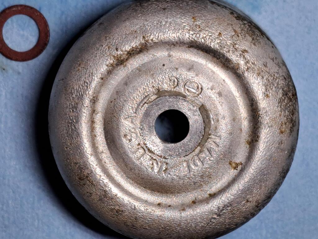

dmoore 1,040 #14 Posted February 8, 2025 Ok, set points at 0.18..timing marks are aligned perfectly @ TDC. I removed the carb to re-check everything since it floods so easily. Look at the erosion on body where bowl contacts. I had this engine running shortly after buying last year but it was always hard to start. I'm not sure if this is my problem or not. You guy's? Share this post Link to post Share on other sites
dmoore 1,040 #16 Posted February 8, 2025 I'm also guessing that bowl held water and eventually corroded away that portion of the carb. Would this cause excessive fuel level knowing needle & seat are new? Share this post Link to post Share on other sites
dmoore 1,040 #19 Posted February 8, 2025 I removed the throttle linkage to check shaft play and there is a lot. 20250208_123107.mp4 Share this post Link to post Share on other sites

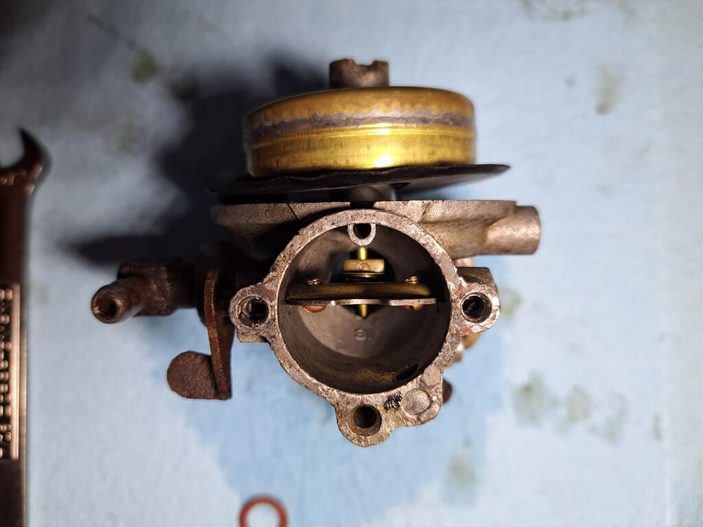

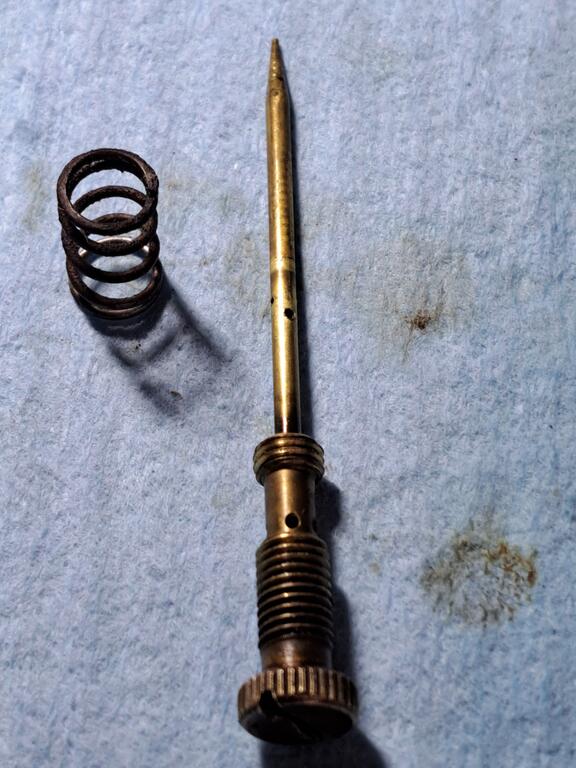

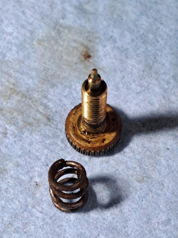

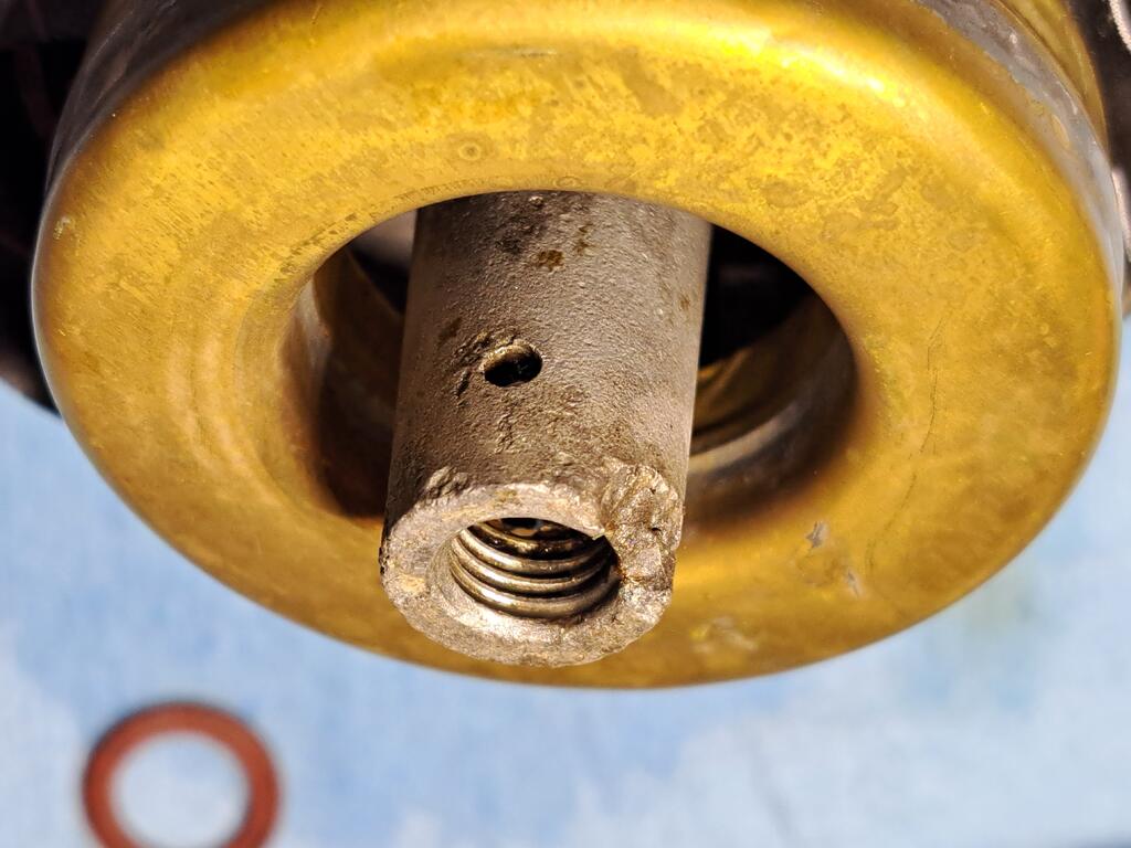

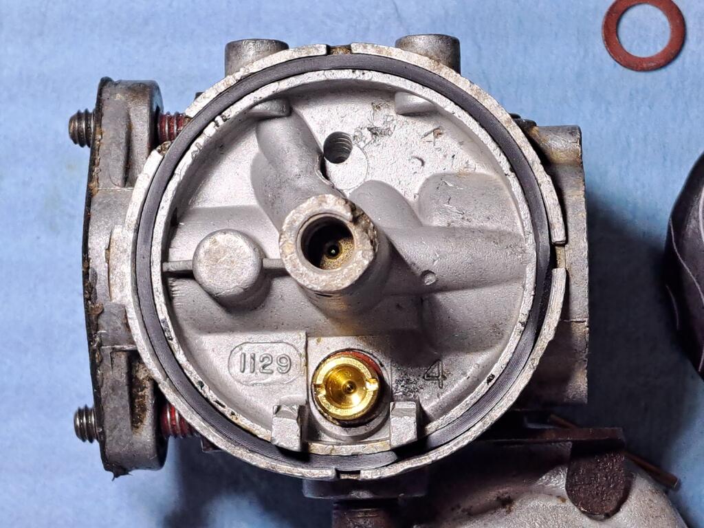

dmoore 1,040 #20 Posted February 8, 2025 I think it's time for a new carb. She had a good run. Share this post Link to post Share on other sites
squonk 47,887 #21 Posted February 8, 2025 Air leaking by the throttle will cause it to be lean not rich but yes looks like it's time. Brian at K&B Horse Parts had some nice looking carbs at the show last year. Maybe he has one you could use. 1 Share this post Link to post Share on other sites

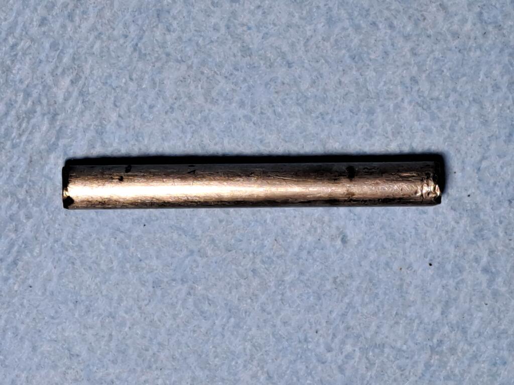

dmoore 1,040 #23 Posted February 9, 2025 I went back to the points again because I lost fire at the plug. Pulled the cover off again and watched the opening while rotating the crank. They didn't seem smooth and would not open on every rotation, sporadic if you will. Removed the point assy then removed the point plunger. It appears to me as if this plunger is worn down and maybe shorter although I have nothing to compare it to. Are these supposed to be a certain length? One end (crank) looks to be a little mushroomed. As far as I know it could be the 65 year old original. Share this post Link to post Share on other sites
dmoore 1,040 #24 Posted February 9, 2025 (edited) Crank end is on right. Edited February 9, 2025 by dmoore Share this post Link to post Share on other sites
pfrederi 21,046 #25 Posted February 9, 2025 Kohler used 2 different point plungers over the year. Have to think a bit an look to see if there were measurements... 1 Share this post Link to post Share on other sites
