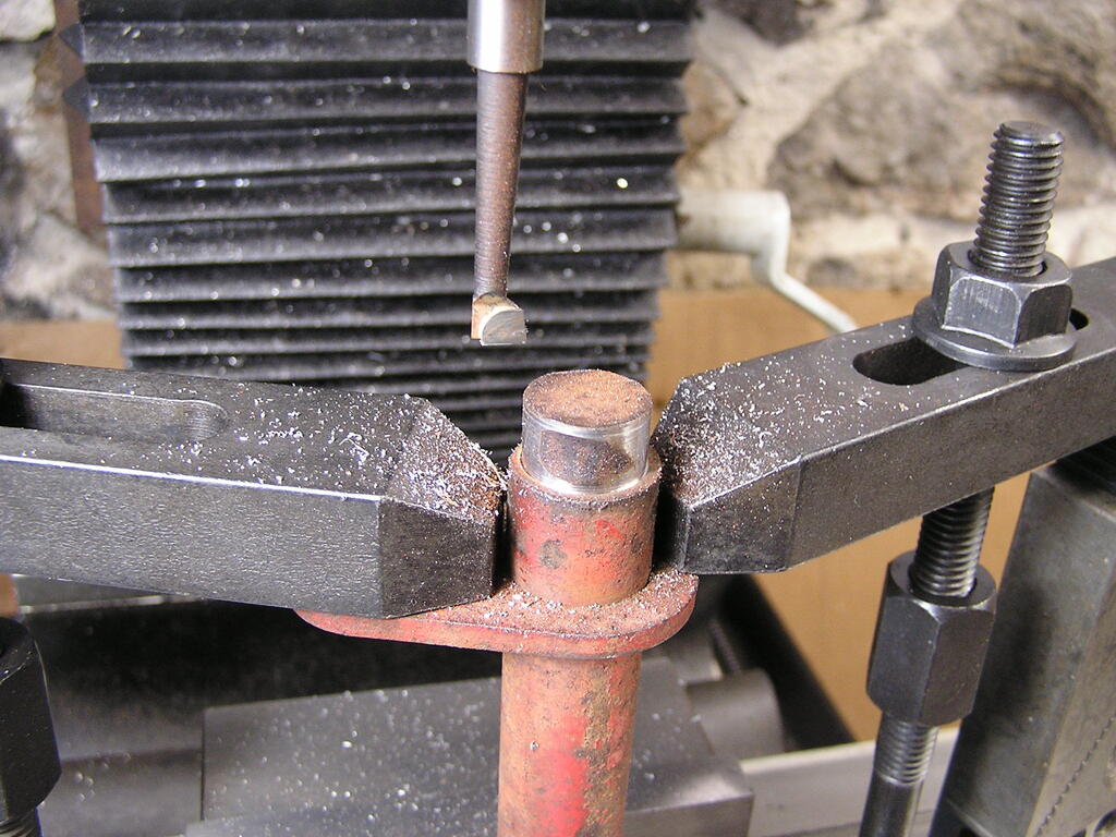

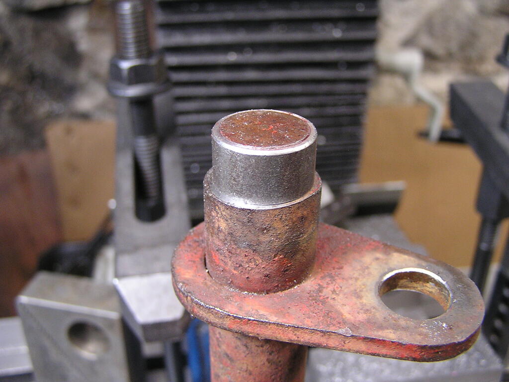

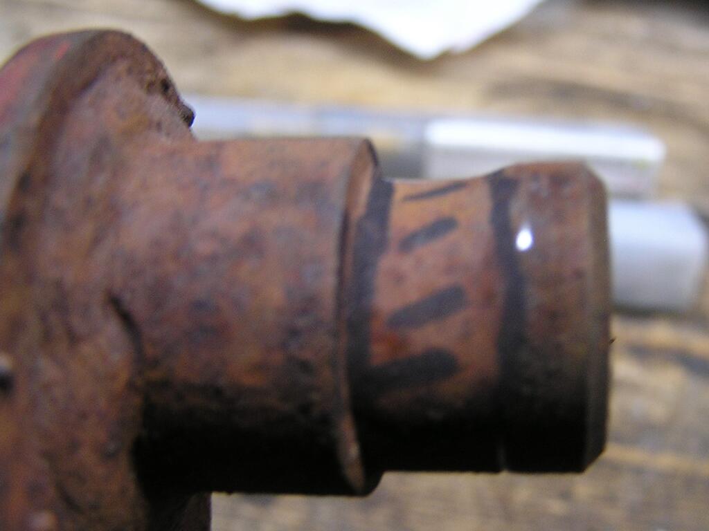

ri702bill 12,542 #18 Posted February 2, 2025 20 minutes ago, ebinmaine said: Can an average mill do some light lathe drilling like a spindle? Yes, with the proper fixturing it can. I repaired the well worn front mount for a couple of gear driven cutting decks using the milling machine to turn down the shaft ends for a pressed on steel bushing. That part was too big to chuck up in my lathe... I also added grease passages & fittings at both ends. BTW, I showed the finished part to @Handy Don - he told me I was just showing off 2 4 Share this post Link to post Share on other sites

Handy Don 17,012 #20 Posted February 2, 2025 3 hours ago, ri702bill said: BTW, I showed the finished part to @Handy Don - he told me I was just showing off I admit it. Doing it with such precision seemed over the top at the time. Thankfully, he didn’t throw me out of the shop! On the other hand, how many of us have, know how to use, and have the time to utilize machines like that? It is something well out of my reach, for sure. I repaired the same piece, on my gear deck with built up weld, a grinder, and files--not nearly as precisely. I didn’t dare ask Bill for an assist 1 Share this post Link to post Share on other sites
