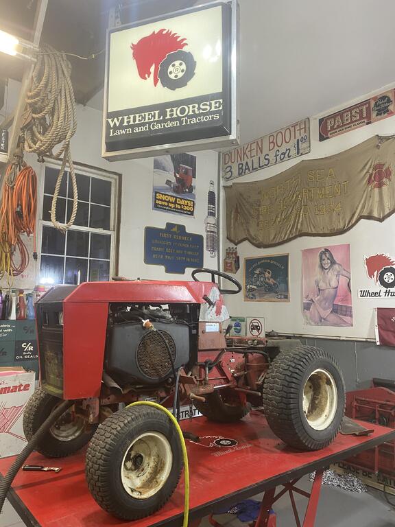

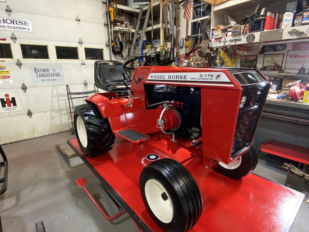

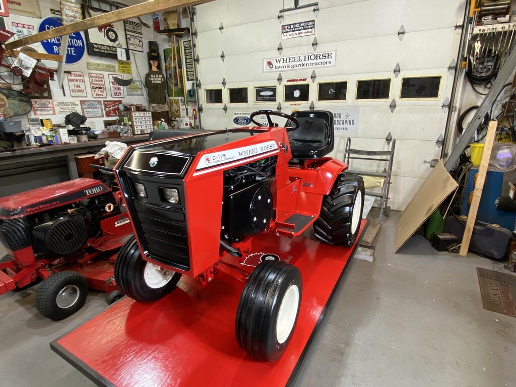

c-series don 12,752 #34 Posted February 6, 2025 (edited) When replacing the fuel line I use a double barbed 1/4” fitting to push into the old line and the other end into the new one. Check to see if the old line is fastened anywhere, remove fasteners and then just pull the new line in while pulling out the old. Works like a charm and saves time trying to route the new line in.Glad to see you are saving that tractor. My C-175 was in similar condition last year at this time and after five months of on and off work it looks like this. Edited February 6, 2025 by c-series don 5 Share this post Link to post Share on other sites
ebinmaine 81,282 #35 Posted February 6, 2025 5 minutes ago, c-series don said: When replacing the fuel line I use a double barbed 1/4” fitting to push into the old line and the other end into the new one. Check to see if the old line is fastened anywhere, remove fasteners and then just pull the new line in while pulling out the old. Works like a charm and saves time trying to route the new line in.Glad to see you are saving that tractor 👍🏻 That's a slick move. 2 Share this post Link to post Share on other sites
oliver2-44 11,847 #36 Posted February 6, 2025 9 minutes ago, c-series don said: When replacing the fuel line I use a double barbed 1/4” fitting to push into the old line and the other end into the new one. Check to see if the old line is fastened anywhere, remove fasteners and then just pull the new line in while pulling out the old. Works like a charm and saves time trying to route the new line in.Glad to see you are saving that tractor 👍🏻 I do similar and just duct tape the new line to the old line. 1 2 Share this post Link to post Share on other sites
Thor27 899 #37 Posted February 6, 2025 @c-series don that is one beautiful 175. 2 1 Share this post Link to post Share on other sites

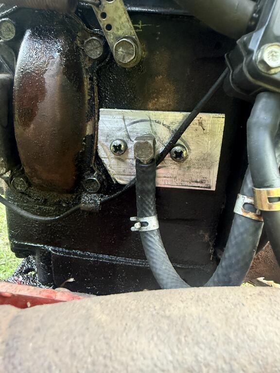

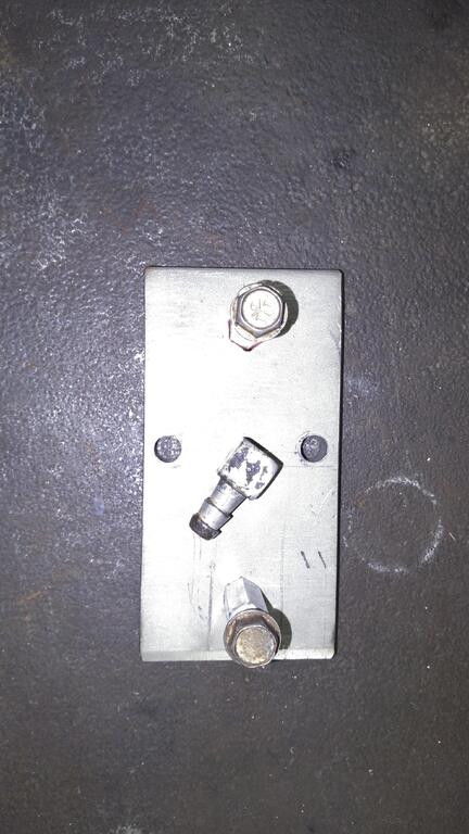

ElectricApprentice123 53 #38 Posted June 22, 2025 After a hiatus due to the summer heat ( work gets busy when it’s hot) I had some time to tinker around more with it. Back in February I ordered a new set of ignition components, a head gasket, fuel line, shutoff and a cheapish Amazon carb (planning on using it until I have time to rebuild the orginal one over the winter). Got everything installed, and found out that the fuel pump was not pumping. A little digging on the internet and I blocked off the oem kohler opening with some scrap Aluminum with a barb and converted it over to a vacuum style pump that I had laying around. (This plate will be permanent but I plan on cutting it down a little to make it fit better with some paint) Upon that repair it fired right up with some tweaking on the carb. Now that it’s running I’ve noticed some other issues…..clutch seems intermittently not returning along with the fact one of the tires seems to have a slow leak. The breather is also leaking some oil and it seems the gaskets have been compromised so I ordered some of those. The electric lift has also seemed to stop working and some digging lead me to believe that the control relay has failed as it’s getting both main and signal power but not out putting anything. It seems that this is a fairly common relay and I’ll be picking it up today to continue. after these are addressed I’ll move onto sourcing new isolators for the motor mounts, soldering the terminals on the headlights a little better and repairing the leaking wheel seal and transmission boot along with all the standard maintenance. 1 1 Share this post Link to post Share on other sites

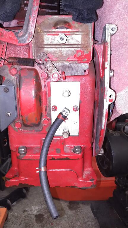

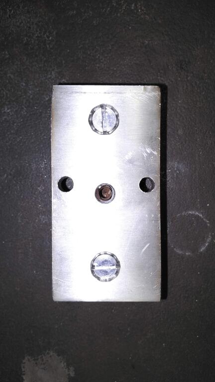

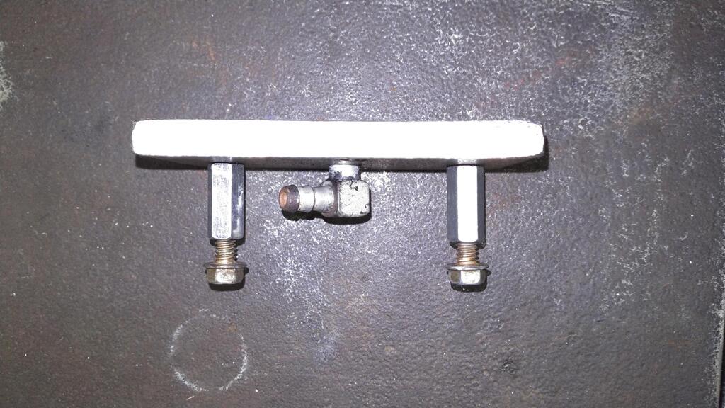

Bill D 3,213 #39 Posted June 22, 2025 Here's some pictures of the pump mounting plate I've made up. Never going back to mechanical pumps. Personally, I don't like electric pumps. 1 Share this post Link to post Share on other sites

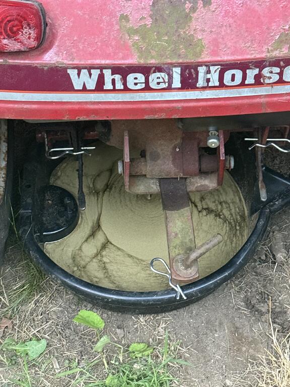

ElectricApprentice123 53 #42 Posted July 13, 2025 Made some more progress on The C105 this weekend…… Found the transmission only shifts into Reverse or first. Drained the oil out and I was reminded of milk so I’m going to have to do some digging on how to flush the transmission. I managed to get the plow hooked up and noted the overall stiffness of all the linkage so that also got added to the list. I still need to change out the throttle and choke cables as both cables and lever linkages are beyond saving. I also need to replace the front tires as one leaks out of the sidewall and the other has a slow leak. That’s all for now! (video of it running for the first time in 4+ years) IMG_2913.mov 1 2 Share this post Link to post Share on other sites
ebinmaine 81,282 #43 Posted July 13, 2025 3 hours ago, ElectricApprentice123 said: Drained the oil out and I was reminded of milk so I’m going to have to do some digging on how to flush the transmission This is quite common. To drain properly, raise the front of the tractor as much as SAFELY possible. There's a hump inside the transmission case at the middle bolt. This gets most of the front fluid to the rear well at the drain plug. Let the front end back down. Reinstall drain plug. Fill with 2 qts of diesel, kerosene, or an off the shelf motor flush. If possible drive the tractor for a minute or two each, in ALL gears. Do some figure 8s to get into the differential as much as possible. If it can't be driven at least do some manual operations to duplicate the above. Repeat raise front and drain. Repeat flush. Maybe twice? Fill with 2 qts of 75W, 80W, ish gear oil. 3 hours ago, ElectricApprentice123 said: I still need to change out the throttle and choke cables as both cables and lever linkages are beyond saving I may have some here for sale. They're universal replacement types that should work OK. PM if interested. 1 Share this post Link to post Share on other sites
