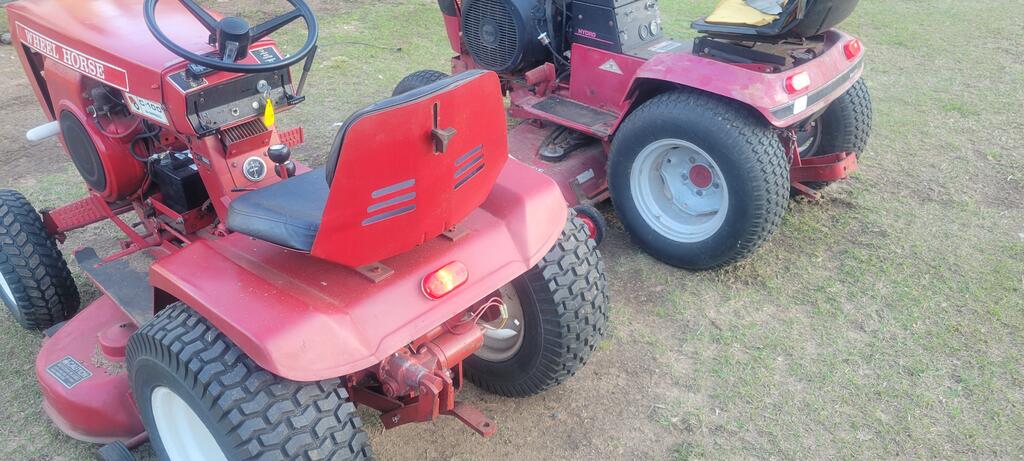

ElectricApprentice123 53 #1 Posted January 30, 2025 Howdy all, I found this gem on FB marketplace. I’m going to pick it up on Saturday for $200 as I couldn’t pass it up for the price. The main use will be to mow my small lot and to clear the occasional middle CT snow storm. (Apologies for the poor quality pictures. They are from the listing and I will get better photos after I pick it up.) Couple questions… Is the electric lift factory installed or a aftermarket lift as I can’t find anything on the internet for it? Is this a sought after model? And last but not least, am I getting robbed paying $200 for this unit as it’s been up for a while on the web. Thanks! 3 Share this post Link to post Share on other sites
kpinnc 18,967 #2 Posted January 30, 2025 The electric lift was an add-on option. I don't think you got robbed. It's a fairly common tractor, but you're getting a deck and snow blade too. All depends on what you can't tell from pictures. Condition of the engine and transmission will determine how you fare on the purchase. Share this post Link to post Share on other sites
Bill D 3,156 #3 Posted January 30, 2025 (edited) The electric lift is easily worth what you're paying for the tractor. If you need a rear fender, please let me know. I have a metal one that will fit that machine. Edited January 30, 2025 by Bill D 1 Share this post Link to post Share on other sites

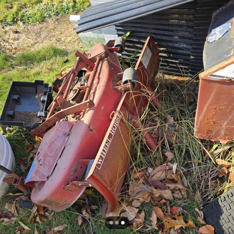

ebinmaine 80,723 #4 Posted January 30, 2025 7 hours ago, ElectricApprentice123 said: am I getting robbed paying $200 for this unit I price things as a total of parts. The plow alone here appears from the bottom corner to be minimally used. That's your $200. The transmission is the heavier duty 8 speed. That's another $100 to $200. I'd go so far as to indicate the seller is getting robbed. Not you! 4 Share this post Link to post Share on other sites
SylvanLakeWH 32,529 #5 Posted January 30, 2025 I have a C-105. Great machine! Fair price! Love the Black Hoods! 4 Share this post Link to post Share on other sites
c-series don 12,453 #6 Posted January 30, 2025 That’s been for sale for a while. If I lived nearby I would have bought it just for the electric lift! As others have mentioned, that in itself is worth $200. Keep us updated with your progress 👍🏻Just so you know, the nicest most helpful people are here on Red Square! 2 2 Share this post Link to post Share on other sites

Sparky-(Admin) 26,368 #8 Posted January 30, 2025 I went and looked at that one in December..it was real rusty and the deck was tight in a bad way. By hand I wasn’t able to spin the Kohler either, but I didn’t try to hard. Might just be the shroud is crammed with acorns from ambitious mice (seen that before) or maybe it’s seized. Steering seemed frozen as well, I suppose a good penetrant soaking might get the steering moving again. I walked. Doesn’t mean its not a fair price. But I felt it had been sitting a looooong time. The seller seemed to think it had been sitting for a couple years. I think it was much longer. Were you able to work into the deal the cast iron weights sitting behind it? I tried to get those included for the asking price of 2 bills, but was unsuccessful. Share this post Link to post Share on other sites
ElectricApprentice123 53 #9 Posted January 30, 2025 8 minutes ago, Sparky said: I went and looked at that one in December..it was real rusty and the deck was tight in a bad way. By hand I wasn’t able to spin the Kohler either, but I didn’t try to hard. Might just be the shroud is crammed with acorns from ambitious mice (seen that before) or maybe it’s seized. Steering seemed frozen as well, I suppose a good penetrant soaking might get the steering moving again. I walked. Doesn’t mean its not a fair price. But I felt it had been sitting a looooong time. The seller seemed to think it had been sitting for a couple years. I think it was much longer. Were you able to work into the deal the cast iron weights sitting behind it? I tried to get those included for the asking proce of 2 bills, but was unsuccessful. I haven’t looked at it yet, the seller is the friend of a friend I found out last night so I somewhat trust him. I didn’t spy the wheel weights so I will see what can happen with them. I take it you’re somewhat local to me if you went and looked at it? 27 minutes ago, TonyToro Jr. said: Also, as mentioned for a metal fender. If you would like to keep it original I have one for sale in a lot better condition then that. 12 hours ago, Bill D said: The electric lift is easily worth what you're paying for the tractor. If you need a rear fender, please let me know. I have a metal one that will fit that machine. I will keep you updated on when I need it…sounds like this thing needs a little love from what sparky said so I am going to try and get it operational before I dig into cosmetic work as this may turn into a restoration 🤩 Share this post Link to post Share on other sites
Sparky-(Admin) 26,368 #10 Posted January 30, 2025 34 minutes ago, ElectricApprentice123 said: I didn’t spy the wheel weights so I will see what can happen with them. I take it you’re somewhat local to me if you went and looked at it? The seller, Jeff, was a nice guy. The weights were sitting on the ground right behind it. Not official WH, but still usable. I’m in Andover but work for EB in Groton so went and looked on my lunch break. Share this post Link to post Share on other sites

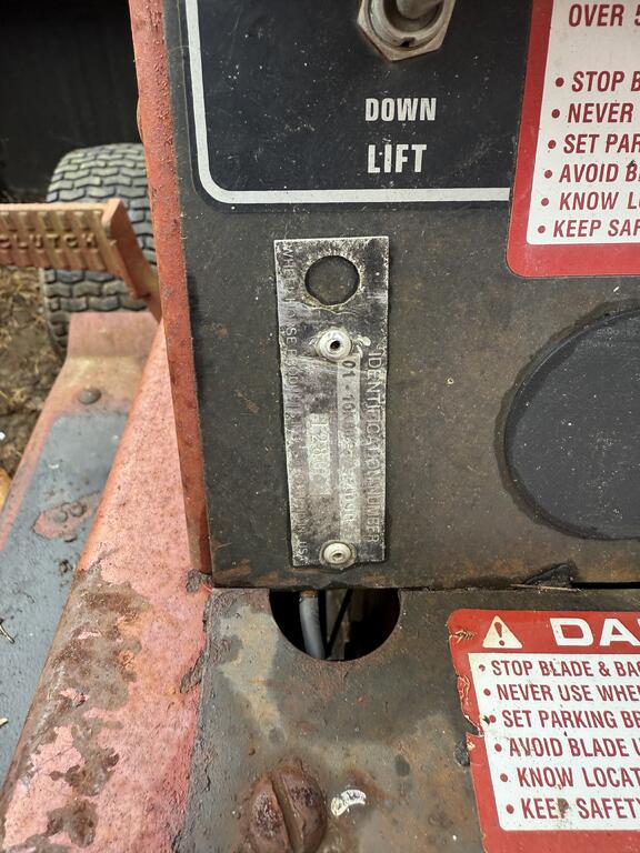

RED-Z06 2,720 #12 Posted January 31, 2025 Where is the electric actuator on this body style? In my C100 it is hanging out the rear 3 Share this post Link to post Share on other sites
Handy Don 17,474 #13 Posted January 31, 2025 11 hours ago, RED-Z06 said: Where is the electric actuator on this body style? In my C100 it is hanging out the rear Tucked into the same space as the hydraulic cylinders on the “-H” 300, 400, and 500 models. The side cover sticks out bit more as the actuator is fatter. 1 1 Share this post Link to post Share on other sites

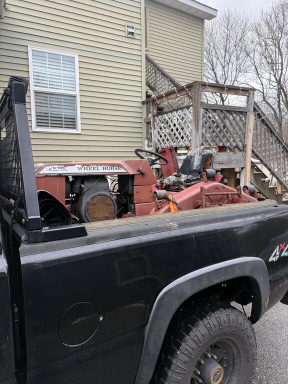

ElectricApprentice123 53 #16 Posted February 1, 2025 I picked it up this morning. I was able to secure the tractor, deck and plow for two bills. He wants another bill for the weights. Upon preliminary glances (wife has other plans for me so I didn’t have time to dig into it) I found the steering free. The key switch is mangled. Seems as if someone tried to jam a screw driver into it. Battery is of course dead and the fuel system seems dry. All 4 tires are either leaking or not holding air. The axle seals are toasted and seeeping oil. The engine seems to be locked up due to the mouse house . ( I was able to get a glimpse of it through the flywheel cover.) More pictures coming soon. 4 1 Share this post Link to post Share on other sites
peter lena 10,067 #17 Posted February 2, 2025 @ElectricApprentice123, don,t think you got stiffed , just parting that out , would recover the $ . the deck and plow set up alone , if not rotted out or wear strip / area ground away . is your return , having done a number of recoveries , always amazed , at opportunities totally ignored / not seen . where are you located in NORWICH ? just curious , pete 2 Share this post Link to post Share on other sites

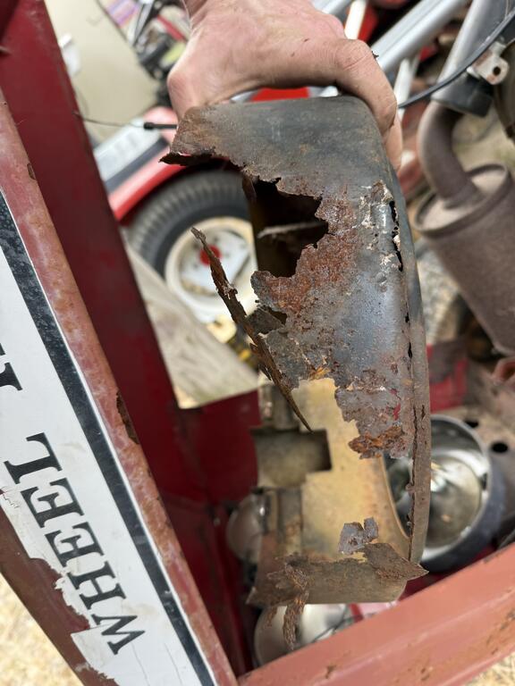

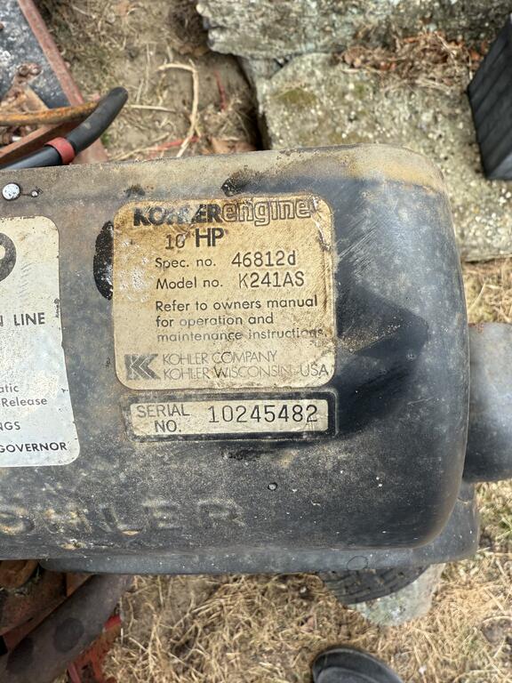

ElectricApprentice123 53 #21 Posted February 2, 2025 Update: I was able to take some time today and dig into it. I was able to remove the blower housing to find the bottom of it completely rusted out.(First picture) So I will be hunting for a new long along with the fenders, seat and ever growing parts list. @Sparky As shown in the second picture the engine was indeed locked up due to a giant mouse nest. I was able to clear it out with some compressed nitrogen and now the engine spins. After installing the new battery and key switch (the old ones were long dead) I am able to get the starter to move by jumping the solinoid. I’m assuming it is either a bad solinoid or something is going on with the brake as it doesn’t seem to have any spring action on it. The fuel system definitely needs a flush and new lines, shut off and filters installed all the way from the tank to the engine. I went ahead and ordered a carb from the jungle site based on the smell of the tank. (Planning on taking the time to rebuild and clean the OEM carb later and using the aftermarket as a spare) So far I’ve noted the axle seals, shifter boot, blower shroud and tie rod ends will all need to be replaced along with the big cosmetic stuff. The electric lift does seem to work after I installed the new battery. @Thor27 @Handy Don and @RED-Z06 The Electric lift actuator is mounted on the left side of the tractor almost where the manual lift handle is on my other Tractor (a Workhorse 800). I will take the covers off later in the week and get some better pictures of it when I start to look at the brakes. 3 Share this post Link to post Share on other sites
peter lena 10,067 #22 Posted February 2, 2025 @ElectricApprentice123 noting your fuel issue , like to run in anything I pick up on a separate gallon of heavily treated fresh gas , hose to jug and carb , also drop carb bowl , to clean out crud / debris , initial start , either a squeeze bulb with gas , or carb cleaner , verify engine oil statis first , probably best to just let it drain out , 30 wt oil , couple qts , give / take , if it starts , wake it up easy , don't scream the hell out of it , you can carb screwdriver , in a fast idle , let it run , and see if it starts to respond easily to lever movements . would also get some penetrating oil into the top ends of the choke and throttle cables , try those as you go , easier control as you go . that carb bowl , has a nut on the bottom , gently rock / remove bowl , probably loaded with debris , thats why I like a seperate gas jug , its clean / clear , bottle of carb cleaner would not hurt . probably smoke too at start up , thats varnish in the rings / glands , fast idle , will tell how its doing , good luck , pete 2 Share this post Link to post Share on other sites
Sparky-(Admin) 26,368 #23 Posted February 2, 2025 Glad to hear the motor wasn’t seized! Definitely a project, but take your time and it’ll be worth it in the end 2 Share this post Link to post Share on other sites
ebinmaine 80,723 #24 Posted February 2, 2025 1 hour ago, Sparky said: Glad to hear the motor wasn’t seized! Definitely a project, but take your time and it’ll be worth it in the end Looks like you've got a fair enough handle on the situation already. Looking forward to seeing your progress. 1 Share this post Link to post Share on other sites
kpinnc 18,967 #25 Posted February 3, 2025 Believe it or not, most of my machines were far worse when I first got them. The southeastern US just eats steel and iron like crazy. The engine being free, and the electric lift working are both very promising. Can't wait to see what you do with it! 3 Share this post Link to post Share on other sites
