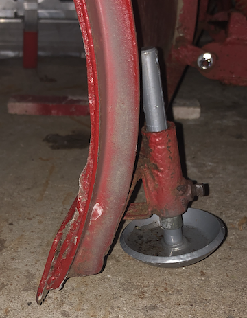

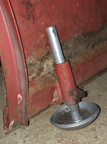

Handy Don 17,197 #5 Posted January 26, 2025 I’m using these semi-bowl style skid shoes. So far they are helping nicely, especially over the concrete sidewalk joints. I’m planning to modify the holders so that the shaft is vertical when the plow is tipped forward as it is now. Also, the plow’s holder sleeves are ¾” ID and these have ⅝” shafts. I made bushings out of some conduit slit lengthwise to make up the difference. (The second photo’s angle distorts the tilt.) This is a BD-4263, one of the few plows had the skid shoe holders built in. If you are adding shoes, be sure to check for interference with the front wheels are turned and the blade is angled (been there, done that). 1 Share this post Link to post Share on other sites

Handy Don 17,197 #10 Posted January 27, 2025 5 hours ago, peter lena said: thinking a short compression spring on that bottom vertical slide area , that would let that slide find its own happy spot . Pete, I get what you are suggesting, but I don’t get the value of having the plow suspended on springs at the skid shoes or of the risk of the shoes dropping down when the blade is lifted. I’ve locked the skid shoes in place with the set screws while the blade was at rest sitting on a pair of 3/32” shims on a flat floor. Share this post Link to post Share on other sites

Handy Don 17,197 #12 Posted January 27, 2025 20 minutes ago, peter lena said: spring supported slide mounts Pete, I don’t see any of those skids having springs mounted to support the weight of the plow on the skids, nor do I see any value in having the plow bounce on springs and thus not have consistent contact with the surface being plowed. Is your goal to somehow treat the plow like an automobile suspended on springs? To what end? Ride comfort for the blade? I cannot see the blade being better at its job when it can bounce. Several of the offered skids do have lower stops or other means of adjusting the skid’s vertical position but that is essentially the same as using a sleeve and setscrew as the WH plow does. Allowing the skid vertical motion well below blade edge, and thus dangle below the raised blade, makes no sense to me at all. I think you might be proposing a solution in search of a problem. 1 1 Share this post Link to post Share on other sites
