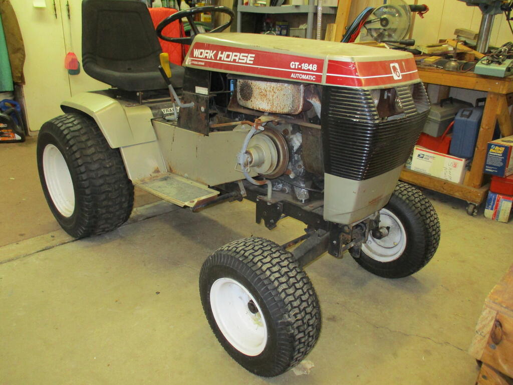

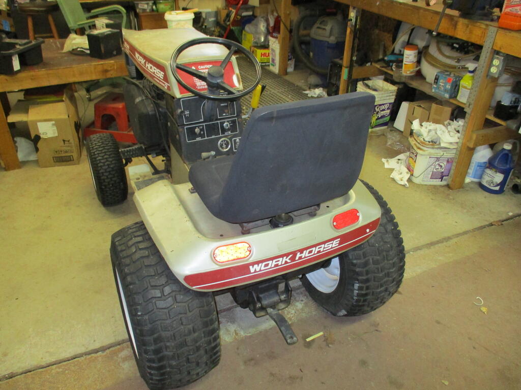

pfrederi 19,794 #1 Posted January 19, 2025 There have been several suggestions on how to coat a WH with something to resist rust and preserve what is left of original finish. Some involve oils (Marvel Mystery oil etc). I have recently got this GT1848. She will be a worker hooked up to the cyclovac. My concern here stems fro long time ago experience. Back in the old Army we liked our trucks to be a bit shiny (pre Camouflage days). Wiping the truck down with DF2 (diesel) before inspection made them look sharp....however within a day or two motor pool dust stuck to the diesel residue and you had a clean up issue. I do not want what ever i use on the GT to be a dust /dirt magnet (cylcovac work can be messy). What should I consider using... I have no interest in repainting what will be a worker. Finish now is in good shape just a few surface rust spots.... 1 Share this post Link to post Share on other sites

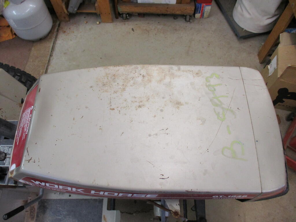

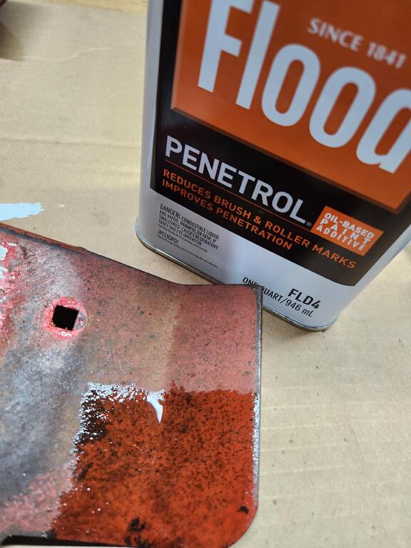

Racinbob 12,669 #15 Posted January 22, 2025 I certainly wouldn't use oil but I second (or 3rd, or 4th.....) the Flood Penetrol. I'm not going to use it on Dino but I just did a sample on one of the footrests. It was still wet when I took the picture so it may not end up quite as shiny but I think you'd like it. I might end up using it on my 76. 3 Share this post Link to post Share on other sites

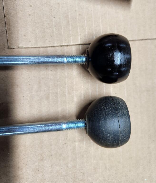

Racinbob 12,669 #16 Posted January 22, 2025 8 hours ago, Thor27 said: Flood also does a pretty good job on bringing plastic knobs and handles back too. And so I went back downstairs and did Dinos knobs. I like! 3 1 Share this post Link to post Share on other sites

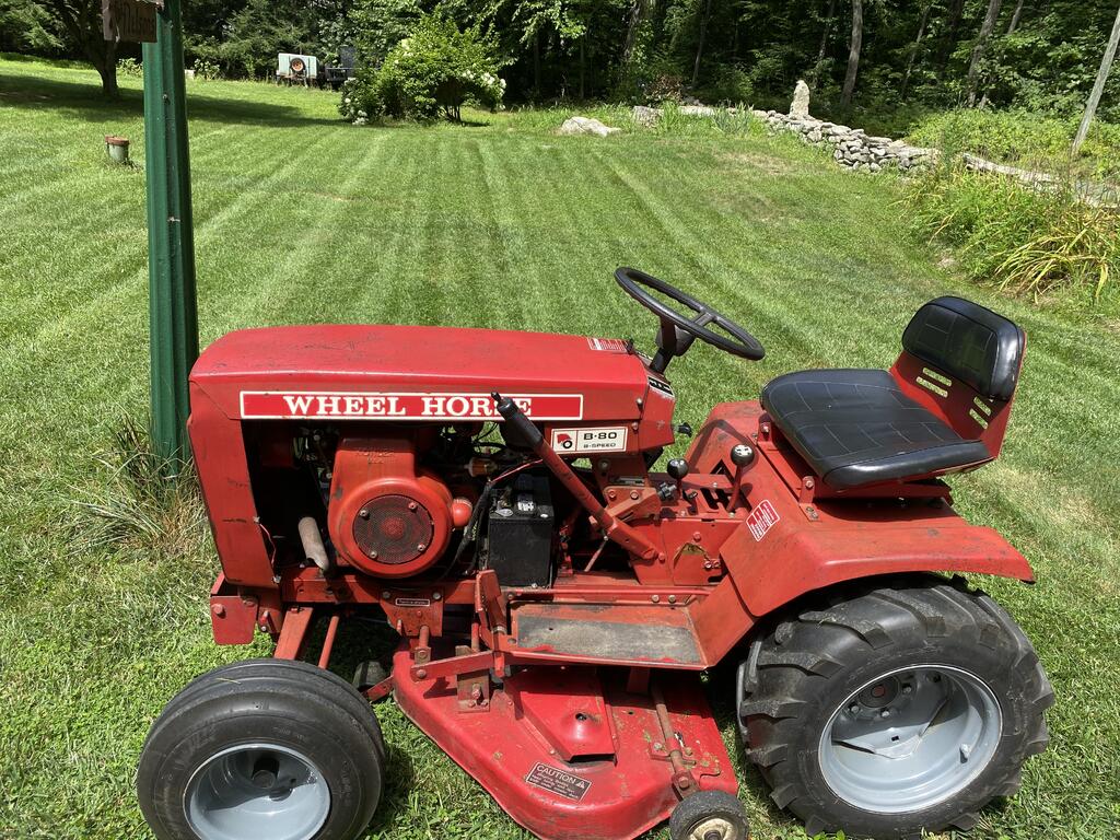

Sparky-(Admin) 24,542 #21 Posted January 22, 2025 Flood Penetrol is what I used on my 77 B-80. Skip the motor oil completely no matter what the “greasy guy” says on here. No oily residue and it’s not a dust magnet. I just wiped it on with a rag. 1 4 Share this post Link to post Share on other sites

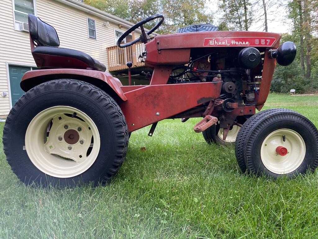

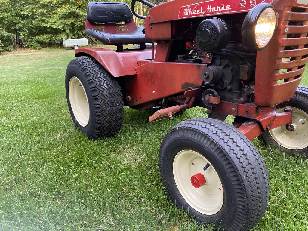

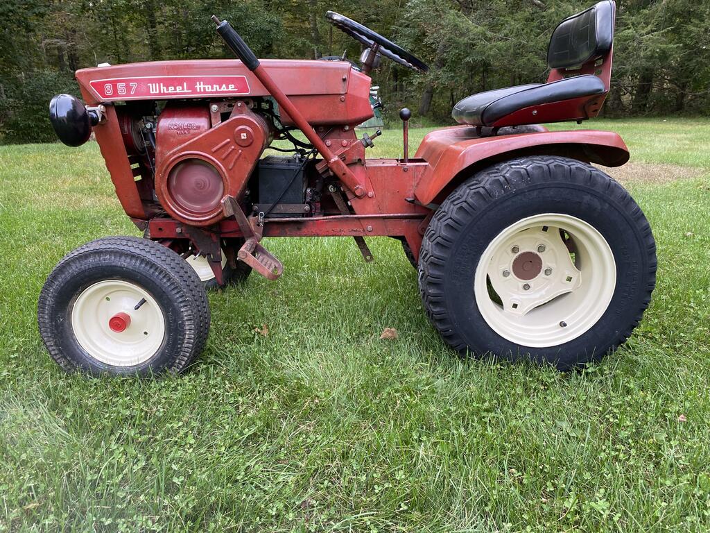

Sparky-(Admin) 24,542 #22 Posted January 22, 2025 This 857 was shot with a clear from a rattle can. I’m not a fan, or maybe I just don’t like how the previous owner skipped/missed sections. But I’m stuck with it now. 4 Share this post Link to post Share on other sites
