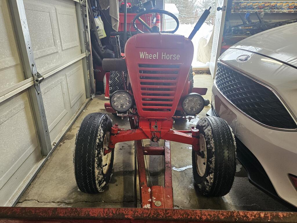

ML3 2,373 #1 Posted January 5, 2025 Want to figure out a winch setup for lifting/lowering plow blade on my 654 without getting into a huge engineering project. Not much room in front of tractor & along plow frame. Here's what I got.... Suggestions? Or better anyone got pics of what they did that works. Would like to find a smaller winch maybe??? 1 Share this post Link to post Share on other sites

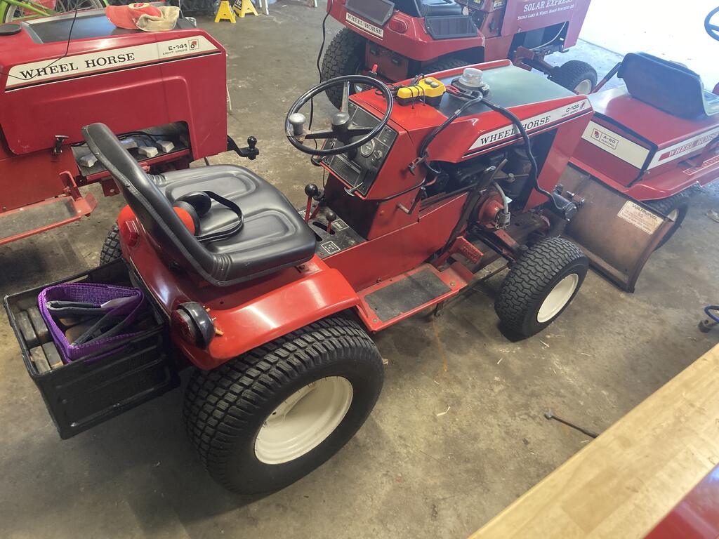

SylvanLakeWH 31,669 #5 Posted January 5, 2025 Here's what I did. Works like a charm... 4 Share this post Link to post Share on other sites

SylvanLakeWH 31,669 #8 Posted January 5, 2025 52 minutes ago, Ed Kennell said: How did you control the overrun Jim? I have soft hands... The controller is remarkably smooth. I push it for a second and it's up where I need it. Push it for a second and it's down... so far so good... I have confirmed that there is at least 2" slack going up... I keep it at 2" off pavement... I know I "should" add springs, but... the boss has me taking down Christmas decorations... so... maybe next summer... 1 1 Share this post Link to post Share on other sites

SylvanLakeWH 31,669 #10 Posted January 5, 2025 2 minutes ago, Ed Kennell said: Oh, guess mine are hard. I bent and broke some eye bolts and angle iron before I added the spring. Mine wench was also radio controlled. Maybe the waves were slowed by the heavy country air? The badland is hard wired and it is pretty consistent... I mounted it in the hood right in front of the steering wheel. As soon as it's off pavement I stop pushing the button and it ends up almost exactly 2" off pavement... I live 20 miles from Detroit, but nobody ever refers to it as "country air"... 1 1 Share this post Link to post Share on other sites

ML3 2,373 #12 Posted January 6, 2025 (edited) 2 hours ago, SylvanLakeWH said: Here's what I did. Works like a charm... Like your setup but I don't think I have enough room to mount winch on front with my tractor being a short frame. Edited January 6, 2025 by ML3 Share this post Link to post Share on other sites

SylvanLakeWH 31,669 #15 Posted January 6, 2025 29 minutes ago, ML3 said: Like your setup but I don't think I have enough room to mount winch on front with my tractor being a short frame. I think you'd be fine... 2" receiver with a winch plate and windlass... pull straight up and down... you're only talking about 2"-3" travel... that winch won't even know it's hooked up... 1 Share this post Link to post Share on other sites

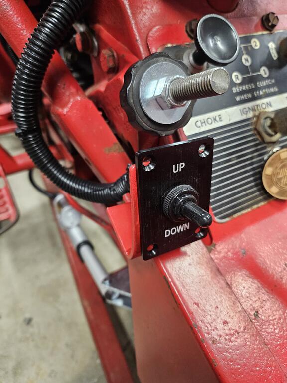

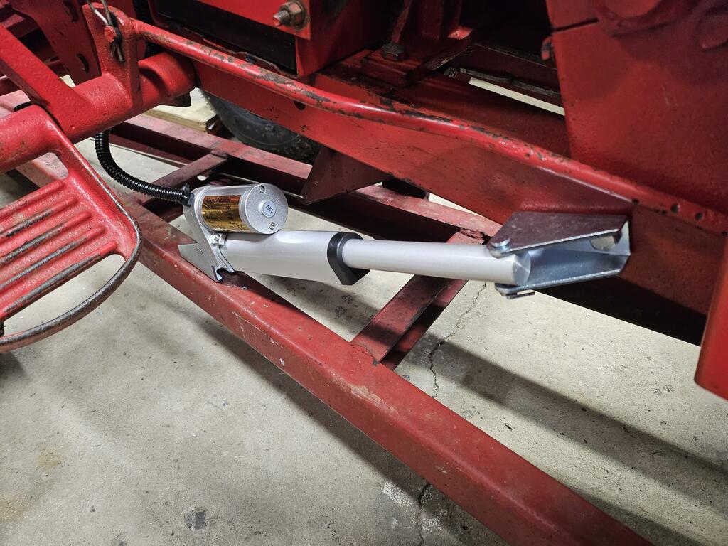

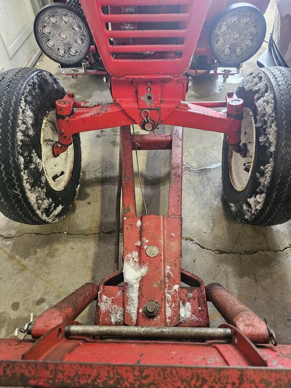

ML3 2,373 #24 Posted January 11, 2025 Got the actuator mounted. Was able to use existing holes, etc for all mounting including the switch. Therefore if it doesn't work it can easily be removed. Supposed to get snow overnight so I'll likely get to try it tomorrow. 🤞 I'm not too worried about static pressure as my driveway is flat & only 2yrs old. I have never even had the plow trip on the springs. I still may consider getting a 2" actuator & use a few links of chain. It appears like I could mount it on the rock shaft leaving the lift arm in up position & attaching bottom of actuator to chain which would attach to plow frame lift point. Hopefully.....I won't need my "plan b" 20250110_202831.mp4 3 Share this post Link to post Share on other sites
