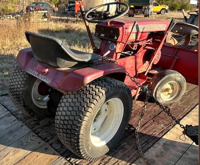

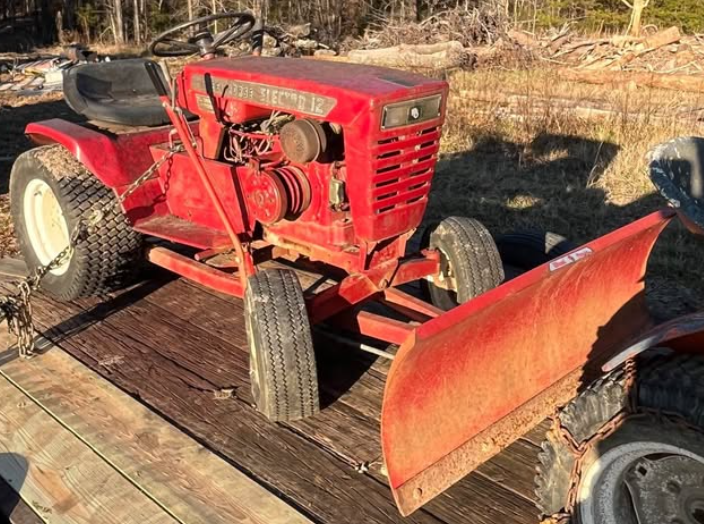

Jrblanke 976 #1 Posted January 4, 2025 Good evening y'all and Happy New Year! I've had a couple weeks off work during the holiday's and of course, and as most folks do, I browsed the facebook marketplace listings to see what's out there! I saw this Electro 12 listed as "wheel horse". That was it! I decided to use the excuse of not having a running truck as the reason for not going to buy it. (Though i'm sure @Wheel-N-It would have been more than happy to let me borrow a trailer). So anyways, I got to thinkin, I really don't know much about the Electro, Charger, or Raider. I assume they are from 1968-1972ish? Did they have numbered tractors during these years? Like the 857 would have been an 8hp from 1967, and a 1056 would be a 10hp from 1966. I know the Commando started in 1968, so I assume the electro, charger, raider were the just the higher horsepower versions. But im not sure what the names mean, or if they are for a specific horsepower or transmission. I thought the electro meant that it had an electronic PTO. Were all electros 12 hp? Were all electros automatics? What about chargers and raiders? Here is the electro 12 that was listed locally for $300 bucks. It has since sold. It was a nice tractor! I almost regret not going to get it! 1 1 Share this post Link to post Share on other sites

kpinnc 19,107 #4 Posted January 4, 2025 (edited) 1 hour ago, AlexR said: Not sure about Electro's I think you might be into it though because every electro I have seen has a electric pto But Raiders are manual's I believe 10-14hp and Chargers are automatic's also I believe 10-14hp Pretty much spot-on. In the late 60s Wheel Horse tried using names for models instead of numbers. Commando- 3 speed and 8hp Raiders- 6 speed transmission. 9-12hp. Chargers- hydro and manual lift. 9-12 hp. Electro- hydro, manual lift 12hp and electric PTO. Bronco- 1971 and 72 only, 14hp, hydro with hydraulic lift. Electric PTO. I think 1968-70 had the hood like the first picture above. 1971 and up had the hoods more like the early C-series. Edited January 4, 2025 by kpinnc 3 1 Share this post Link to post Share on other sites
