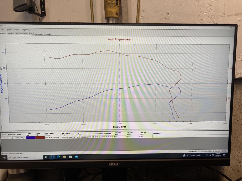

TonyToro Jr. 2,560 #37 Posted January 4, 2025 When we built the engine for my Economy stock this year out of and K series 14. Had about 18 hp with Midwest super cubs Piston, Rings, and Connecting rod. Then ordered a Vogel cam and valves and got 28hp out of it. So I’m happy with their stuff. 1 Share this post Link to post Share on other sites

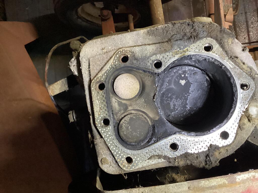

Easton Rich 1,292 #39 Posted January 4, 2025 I am going to have my local machine shop shave the head 0.050 over and I’m thinking about a cam Share this post Link to post Share on other sites
ebinmaine 81,281 #40 Posted January 4, 2025 2 minutes ago, TonyToro Jr. said: When we built the engine for my Economy stock this year out of and K series 14. Had about 18 hp with Midwest super cubs Piston, Rings, and Connecting rod. Then ordered a Vogel cam and valves and got 28hp out of it. So I’m happy with their stuff. You have access to a dyno or is that experience knowing/ estimates? What RPM? Share this post Link to post Share on other sites

Easton Rich 1,292 #42 Posted January 4, 2025 How do you clean your engine internals? Share this post Link to post Share on other sites
Easton Rich 1,292 #43 Posted January 4, 2025 Just learning others ways 1 Share this post Link to post Share on other sites

ebinmaine 81,281 #45 Posted January 4, 2025 6 minutes ago, Easton Rich said: How do you clean your engine internals? The area you can see around the valves and piston can be done carefully with a light duty wire brush AND A VACUUM. Same for rest of the outside of the block. Share this post Link to post Share on other sites
peter lena 10,125 #46 Posted January 4, 2025 @Easton Rich are you talking paint patina / vintage ? of recovery ? my typical look at a long neglected tractor or any used to be painted anything is the OPPORTUNITY to retain that with an oiled look , IRONICALLY YOUR FRONT AXEL ENDS are showing you what a lubrication soak , starts . personally would NOT REMOVE ANY OF THAT PAINT IN ANY WAY / knock r loose , penetrant , is a good spray down and let it sit , till the moisture soak in , then rub it down , with more penetrant , let soak , or mineral oil , like a clean soft cloth , any paint that lightly pulls out with an deeper oil look would be perfect on that . BTW first thing I do on any old painted finish , is to get a lube spray down going on , your clean oiled cloth rub down will show you how its going . my paint recoverys , on just starting a fade , usually buff right out , would let that paint absorb , lubricant first , used 6 " electric palm buffer , cleaner wax to pull these out , yours would be darker OILED PATINA , good fit for era, pete Share this post Link to post Share on other sites
TonyToro Jr. 2,560 #47 Posted January 4, 2025 23 minutes ago, ebinmaine said: You have access to a dyno or is that experience knowing/ estimates? What RPM? Yes we had access to a dyno. It was at 4000 RPM 2 1 Share this post Link to post Share on other sites
ebinmaine 81,281 #48 Posted January 4, 2025 3 minutes ago, TonyToro Jr. said: Yes we had access to a dyno. It was at 4000 RPM Very cool Share this post Link to post Share on other sites
ebinmaine 81,281 #49 Posted January 4, 2025 29 minutes ago, Easton Rich said: I am going to have my local machine shop shave the head 0.050 over and I’m thinking about a cam Double check with the machine shop or piston supplier to understand where the piston top will be at full RPM and Top Dead Center. A stock setup will likely be lower than the engine block but an aftermarket piston could come up higher. That changes your spacing for valves and cylinder head. Remember that the camshaft is literally the controller of your engine and it's scope of breathing. Be aware of the RPM potential and its limitations. The stock rod and flywheel should NEVER be pushed past 4000. Share this post Link to post Share on other sites
