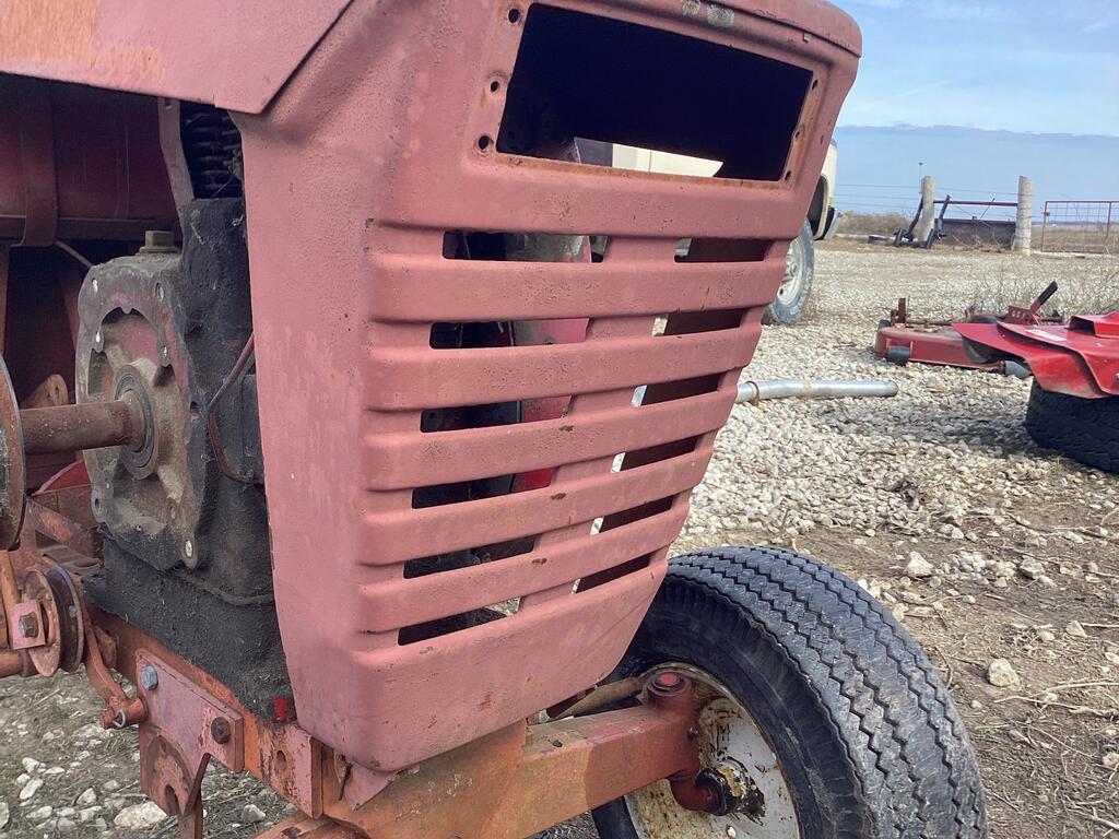

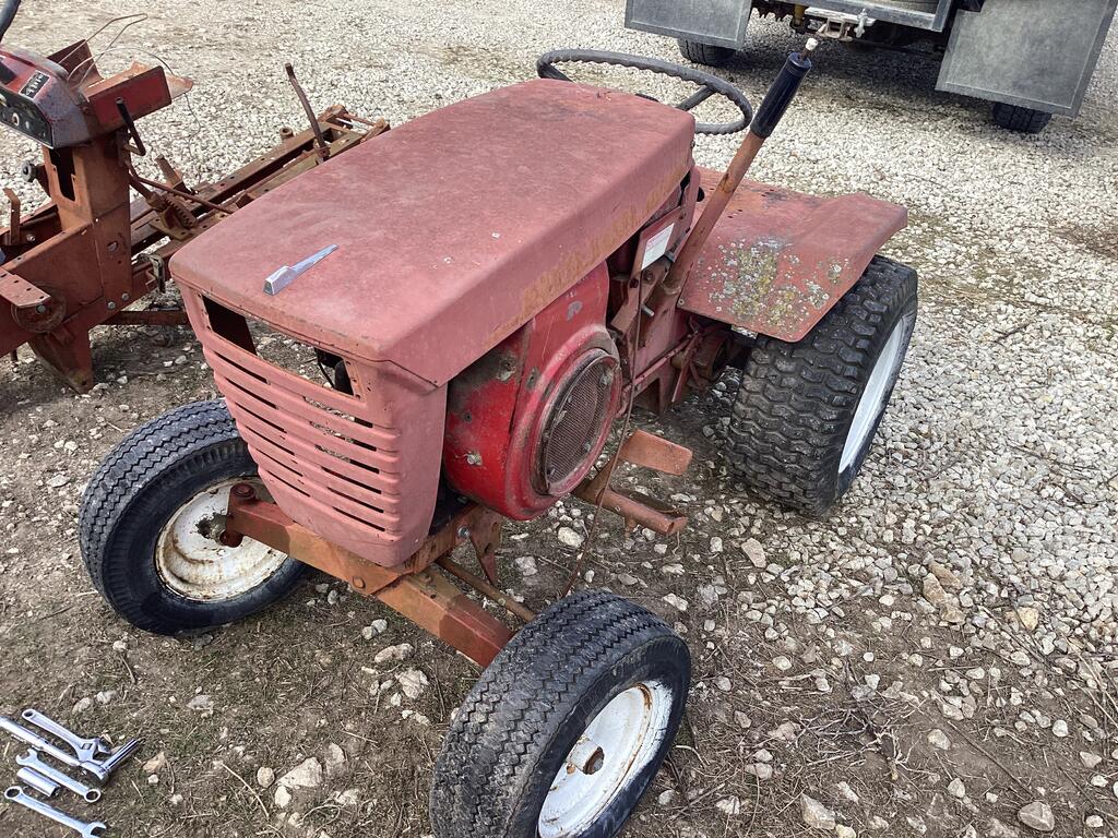

Easton Rich 1,284 #1 Posted January 3, 2025 This is my 2025 project, I’m combining a commando 8 and a b80. The reason is both were free and the k241 was $50. SCORE IN MY BOOK!!! 3 3 Share this post Link to post Share on other sites
Easton Rich 1,284 #2 Posted January 3, 2025 Have any of you jammed a k241 in a commando or anything like it? If so I need advise on how, my hood is 2 or 3 inches from sitting in the slot. 2 Share this post Link to post Share on other sites
ebinmaine 81,208 #4 Posted January 4, 2025 5 hours ago, Easton Rich said: Have any of you jammed a k241 in a commando or anything like it? If so I need advise on how, my hood is 2 or 3 inches from sitting in the slot. Personally I'd run a stubby spark plug and raise the hood hinge. Kinda like what Wheelhorse did for the 1974 C160-8 Tecumseh engine tractors. 3 Share this post Link to post Share on other sites
Easton Rich 1,284 #5 Posted January 4, 2025 Didn’t think of that, the dang spark plug is like 4inches long! 3 1 Share this post Link to post Share on other sites
ebinmaine 81,208 #6 Posted January 4, 2025 A 10 HP should be an RJ19LM. Check the threads and length on a CJ8 or J8C. Share this post Link to post Share on other sites

Achto 32,943 #9 Posted January 4, 2025 (edited) @Easton Rich Check out my thread on building Radpferd. I had to raise the hood 3" to get the Hatz diesel stuffed in a short frame tractor. Post #32 goes into the lift kit for the hood. Edited January 4, 2025 by Achto 2 1 Share this post Link to post Share on other sites

ebinmaine 81,208 #13 Posted January 4, 2025 2 minutes ago, Easton Rich said: I read through your extension part I will probably do the hood one but not the dash one because it is not that much of a difference I can show pics with the difference between the Kohler hood and Tecumseh hood tomorrow. The Tecumseh is an OHV160. Over Head Valve. Much taller engine than the Kohler. The hood hinge is maybe 1.5" taller. Share this post Link to post Share on other sites

Easton Rich 1,284 #15 Posted January 4, 2025 What can I use to bring this paint around? Share this post Link to post Share on other sites

ebinmaine 81,208 #18 Posted January 4, 2025 2 minutes ago, Easton Rich said: What can I use to bring this paint around? Start with a thorough cleaning. From there I'd do a good wet sanding. There're threads that show that. When done maybe a clear coat? Share this post Link to post Share on other sites

Easton Rich 1,284 #20 Posted January 4, 2025 Yes for sure a clear coat 1 Share this post Link to post Share on other sites
