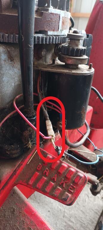

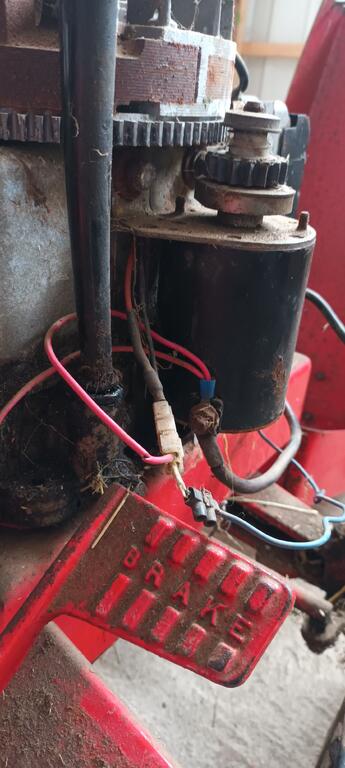

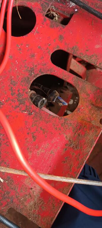

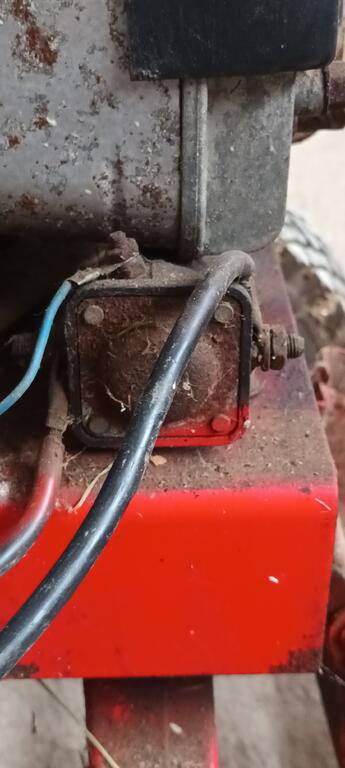

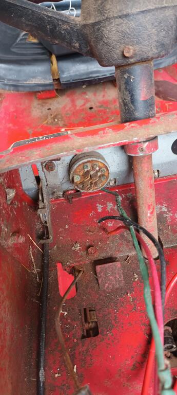

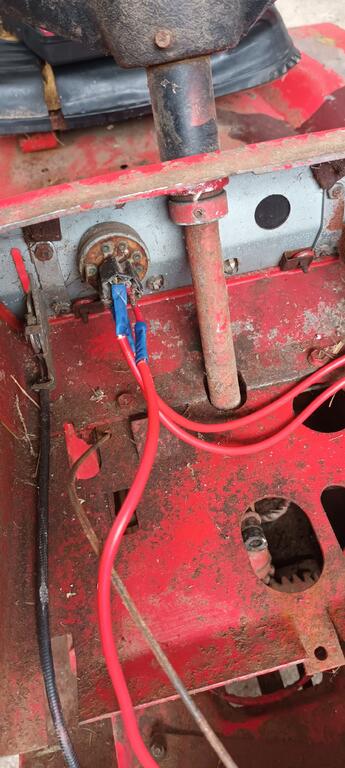

A800 FAN 1 #6 Posted January 4, 2025 15 hours ago, WHX?? said: Shouldn't be too difficult to figure out the wiring it's a pretty basic tractor. Then again i can talk smart wiring is my only strong suit. Pics might help abit ... the back of the ignition switch. Thank you for your response. I have taken a few photos of the electrics. There were 3 wires connected to the back of the ignition switch : 1 green, 1 red & 1 black (photo # 110453). The cables had been completely removed by the previous owner, presumably because they had melted through. I replaced the 3 cables on the ignition lock with 3 new ones (the 3 red ones - photo # 110510). Unfortunately, I don't know where to connect the other end of them. In my opinion, the black cable was connected to the cable that comes out from under the fuel tank and goes to the 2 switches to the clutch and the mower (photo # 110625). I would prefer to bypass these 2 switches anyway. However, I don't know where the blue cable in the same photo was connected. For the sake of completeness, I have also taken a photo of the solenoid, the starter and the ignition coil. I have not found a voltage regulator on the lawn tractor. I hope, someone could help me. Thank you ! Share this post Link to post Share on other sites

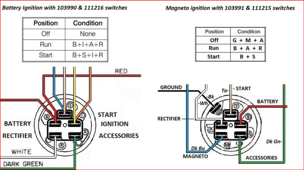

WHX?? 56,591 #7 Posted January 4, 2025 (edited) Ok first thing is get one of these on order if you can. https://www.amazon.com/DVPARTS-Ignition-Connector-725-3026-925-3026/dp/B09FDYYSLC/ref=rtpb_d_sccl_2/144-0580377-3899262?pd_rd_w=vfoOH&content-id=amzn1.sym.ecc04cf7-51e4-4f3c-90a2-8bee4ffadf01&pf_rd_p=ecc04cf7-51e4-4f3c-90a2-8bee4ffadf01&pf_rd_r=0X7W7VG6W7P5R2GXZBF8&pd_rd_wg=mAEoO&pd_rd_r=b7db3fc0-c4cc-4b22-a8e4-59e605d599f7&pd_rd_i=B09FDYYSLC&psc=1 This will plug right on to the back of the ignition switch for a clean start. You will not be able to use the wiring diagram Garry graciously provided. That is for a battery/points system and you have a magneto ignition.@953 nut do you have one of your nice diagrams for magneto.? Next remove any and all traces of existing PO wiring molestation. You are going to want to start from scratch. Here is a diagram of the back of the switch. you are concerned with the magneto style on the right. Try and save this connector .. it will make things much easier. On the tractor side of the plug extend the wiring. I prefer what we call a western union splice with solder and shrink wrap. Google it good u tubes on doing it. Leave the wires plenty long. Correct me if I am wrong fellas but is that a diode I spy on the engine side? Never mind Richard I think this is it ... please verify... Now I could be dead nuts wrong here but I almost think that the red wire on the engine side of the plug is the charge wire and the white is the magneto. You will need to verify this. Most times standard on a Briggs I believe. Again triple check. Edited January 4, 2025 by WHX?? 1 1 Share this post Link to post Share on other sites
WHX?? 56,591 #8 Posted January 5, 2025 On a side note ... very important ... The switch terminal designations on the switch diagram and the wiring diagram are not the same. Check yours for correct labeling. Cleaning the back of the switch up should reveal the letters. Also the some of the wire colors on the switch pigtail will likely not correspond with what is shown on the diagrams. It might be wise to check your existing switch for proper connections in all positions. Another important note is make sure 12 volts IS NOT applied to the M wire. You will let the smoke out of the Magneto and or wires. The M wire gets grounded when the switch is in off to kill the engine. TRIPLE CHECK ALL WIRING CONNECTIONS BEFORE APPLING POWER! 1 1 Share this post Link to post Share on other sites
953 nut 66,044 #9 Posted January 5, 2025 10 hours ago, WHX?? said: you have a magneto ignition.@953 nut do you have one of your nice diagrams for magneto.? 10 hours ago, WHX?? said: Never mind Richard I think this is it ... please verify... NO, That diagram is for a battery ignition system, don't use it @A800 FAN, please check you ignition switch and let us know if it matches the 103 991 switch shown. The diagram below is a basic wiring diagram for a magneto powered ignition system. The charging portion from your B&S may not be the same. 1 Share this post Link to post Share on other sites

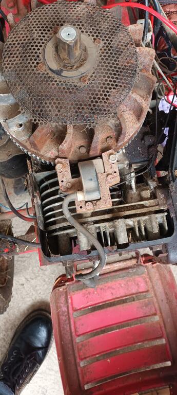

A800 FAN 1 #11 Posted February 12, 2025 On 1/5/2025 at 2:13 PM, A800 FAN said: Hello, Many thanks for your tips. I will check the ignition lock more closely in the next few days. In the meantime, I have already ordered a new wiring harness, delivery should take +/- 10 days. After that I will get back to you. Hello friends, Many thanks for your help ! After some time, here is an update on my project: I replaced the wiring harness. It is a 3-pole system with ground cable, positive cable and cable to the ignition coil. After replacing, I discovered that the starter motor and the ignition coil were also defective. After replacing both parts, the starter runs perfectly, now the problem is the ignition coil: when I connect a spark tester directly between the ignition cable and the engine block, a spark can be seen in the tester. As soon as I fit the spark plug on the engine and place the tester between the ignition cable and the spark plug, there is no more spark. The same happens when I leave the tester out and hold the spark plug on the engine block. No spark. It looks as if the spark is too weak. The earth cable, which is used to switch off the engine, is not connected. I don't know what to do.... Does anyone have any ideas? Thanks ! Share this post Link to post Share on other sites
A800 FAN 1 #12 Posted February 13, 2025 (edited) Hello friends, Many thanks for your help ! After some time, here is an update on my project: I replaced the wiring harness. It is a 3-pole system with ground cable, positive cable and cable to the ignition coil. After replacing, I discovered that the starter motor and the ignition coil were also defective. After replacing both parts, the starter runs perfectly, now the problem is the ignition coil: when I connect a spark tester directly between the ignition wire and the engine block, a spark can be seen in the tester. As soon as I fit the spark plug on the engine and place the tester between the ignition wire and the spark plug, there is no more spark. The same happens when I leave the tester out and hold the spark plug on the engine block. No spark. It looks as if the spark is too weak. The ground wire, which is used to switch off the engine, is not connected. I don't know what to do.... Does anyone have any ideas? Thanks ! Edited February 13, 2025 by A800 FAN Share this post Link to post Share on other sites
gwest_ca-(File Mod) 12,233 #13 Posted March 12, 2025 You could try a new spark plug. If it does not correct the problem remove it and save for the next time. Spark plugs can fire out of the engine but fail to spark when they are under compression in the cylinder. Share this post Link to post Share on other sites
