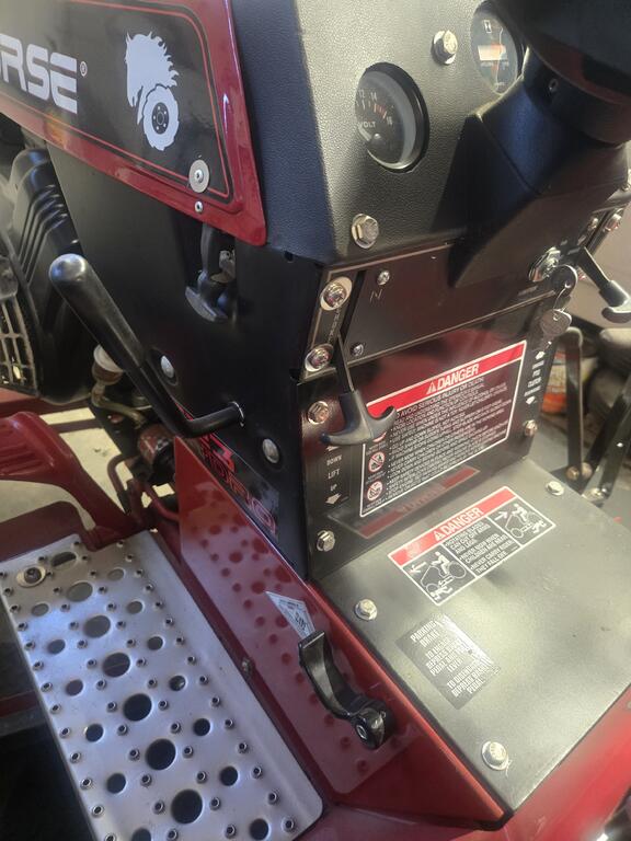

Brockport Bill 2,359 #1 Posted January 2, 2025 have a 1983 WH C175h -- just replaced the 2 short hoses from master valve unit to the lift cylinder by the left foot rest -- also removed shaft inside the master valve and replaced the two O rings -- what is the whining noise when operating the lift -- is it when the lift gets to its end range? Noise existed before and after repair project --- What causes it -- is it an issue? thanks, Bill Share this post Link to post Share on other sites

kpinnc 18,251 #23 Posted January 7, 2025 1 hour ago, Handy Don said: So much depends on the shape and size of the fluid passageways. Could it be possible that your control linkage isn’t fully opening the valve? Ours squeal all the time if we try to feather the control. Exactly my thoughts as well. This particular machine is a late 80s setup where the lift handle mirrors the PTO handle on the opposite side. It's possible the handle meets the stop before the valve does. 1 Share this post Link to post Share on other sites
cleat 8,979 #24 Posted January 7, 2025 20 minutes ago, kpinnc said: Exactly my thoughts as well. This particular machine is a late 80s setup where the lift handle mirrors the PTO handle on the opposite side. It's possible the handle meets the stop before the valve does. Some of my 520's have that configuration. That is my personal favorite. No issue with the valve with these. I think the control under the steering wheel would be the most likely to have the valve not work fully if not adjusted properly. 1 Share this post Link to post Share on other sites
