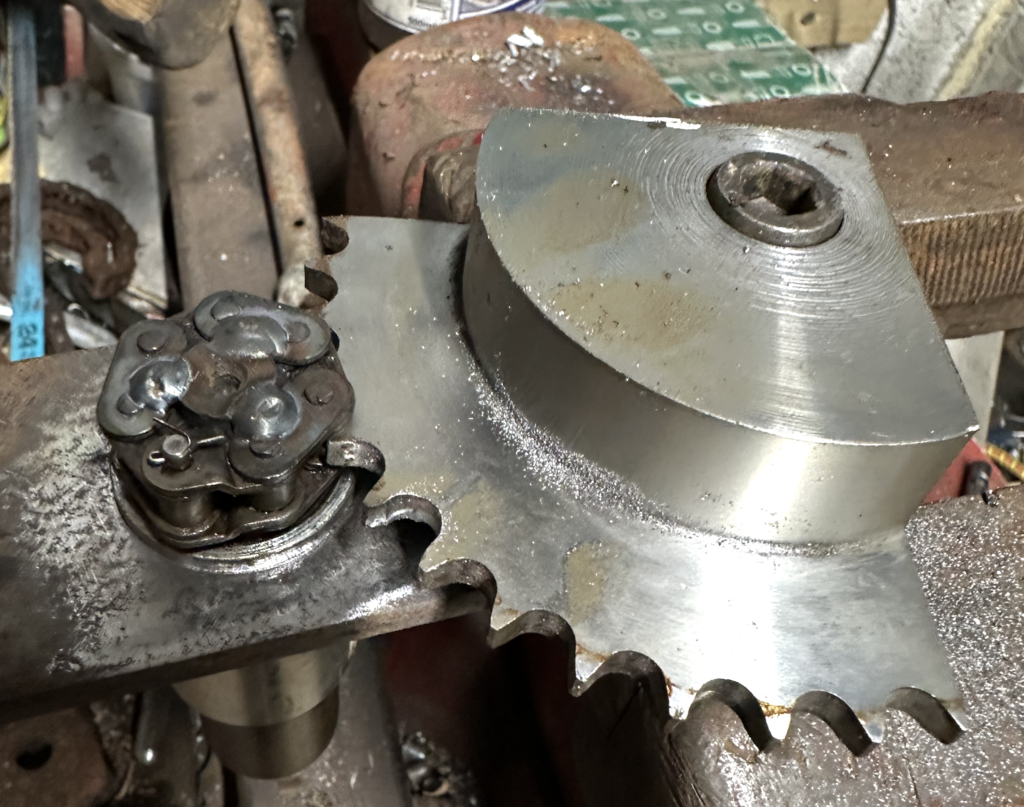

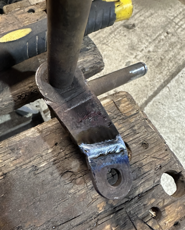

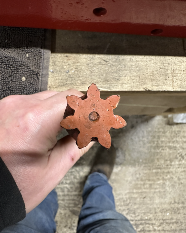

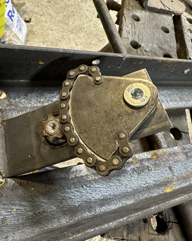

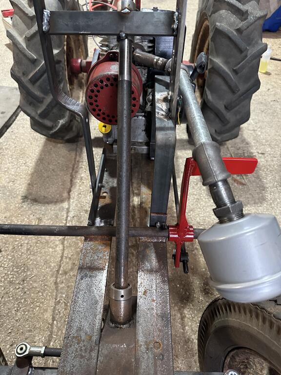

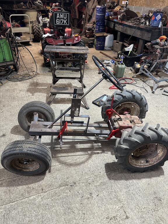

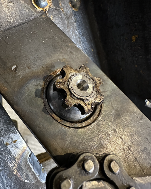

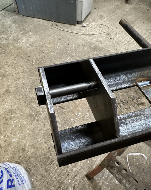

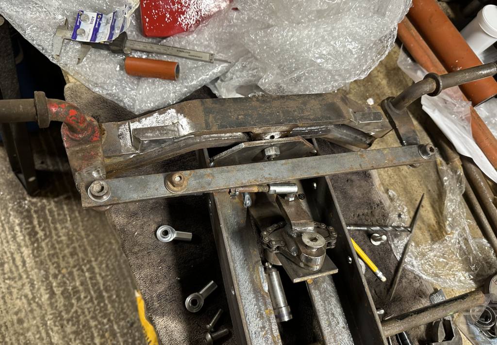

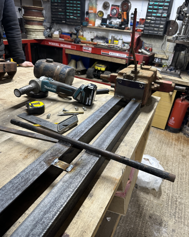

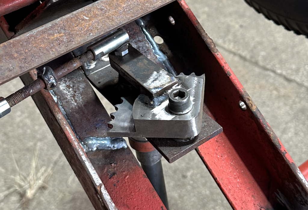

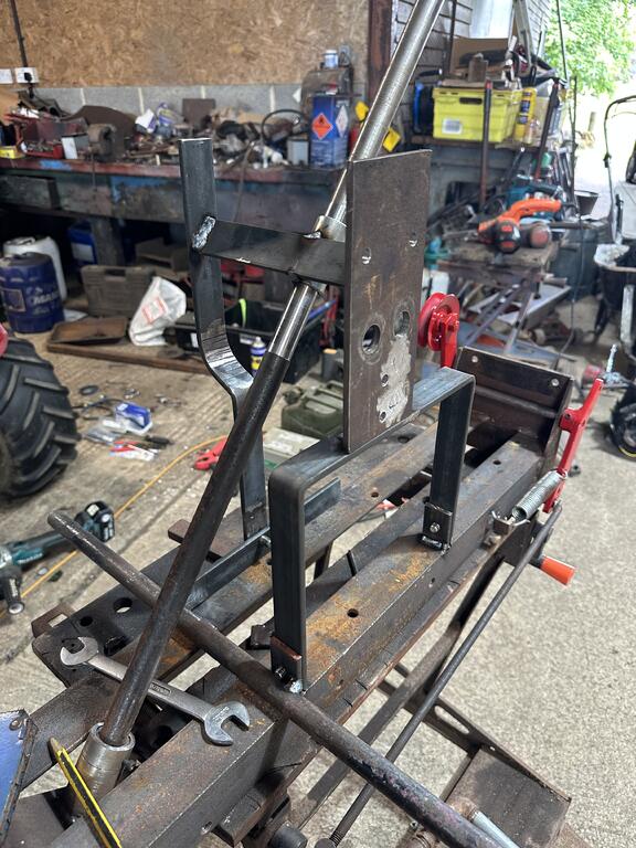

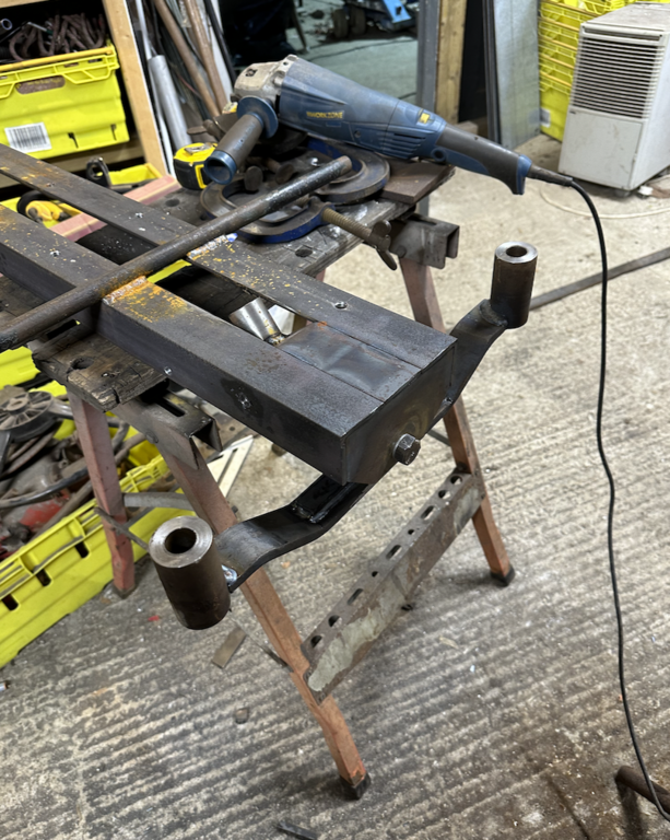

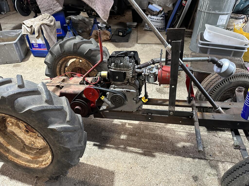

meadowfield 3,190 #1 Posted January 2, 2025 A guy can never have two many projects It's 10 years since I almost finished one, and I decided to start another.... With an early two piece trans lying around and a few pictures, I decided to build a 551 from scratch. Big shout out to @oliver2-44 and @Shaun turner for pictures/dimensions and bits to copy. The frame came together pretty quickly. It gets a bit trickier after that - especially on the steering, but I thought I could do my own spin.... drilling and filing a 7 tooth 3/8 sprocket was fun! but the principle works well onto making an axle from bits! 2" flat bar and Volvo C30 driveshaft.... you guys know I love a bit of recycling. Lots of layers and bending. quick modification to C series spindles. and some experimenting to get the tie rod and ackerman perfect. more to follow.... 3 14 2 Share this post Link to post Share on other sites
953 nut 69,325 #2 Posted January 2, 2025 Utilizing the roller chain as you did on the steering is a clever idea. 4 3 Share this post Link to post Share on other sites

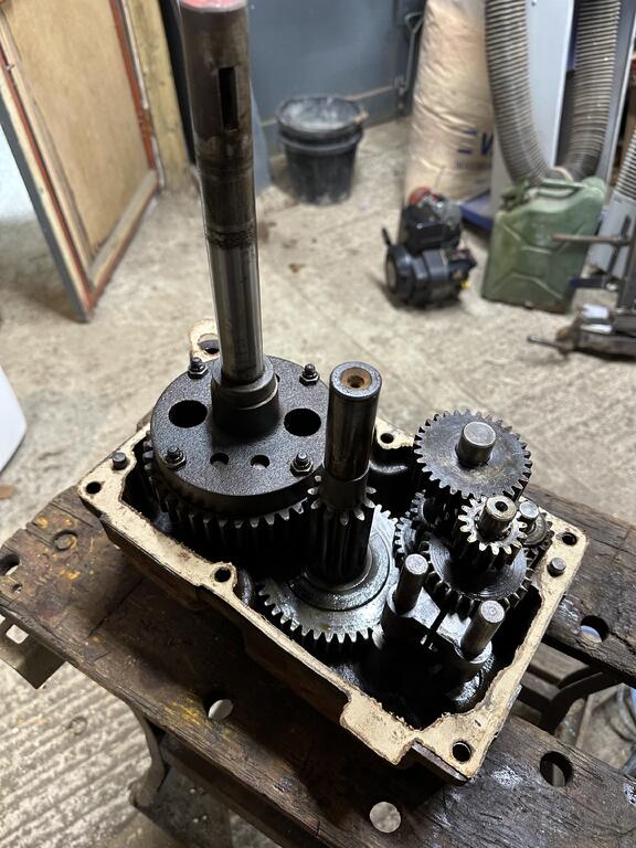

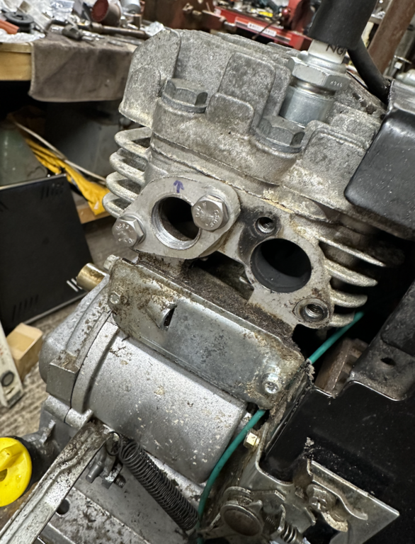

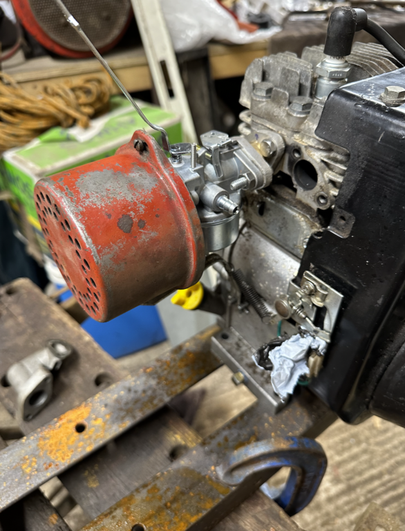

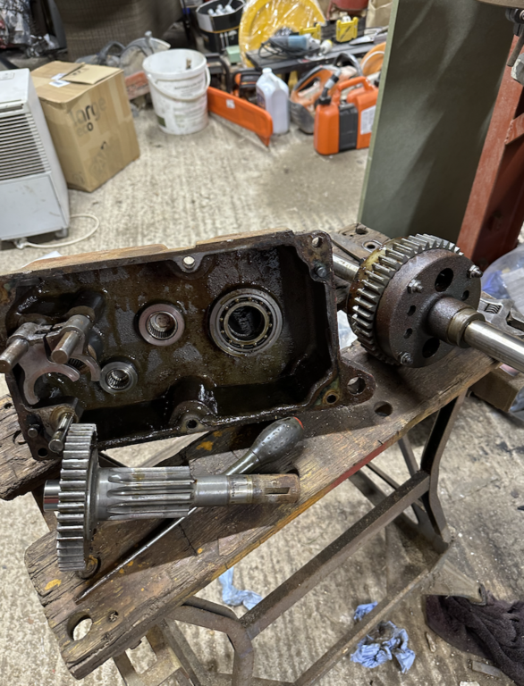

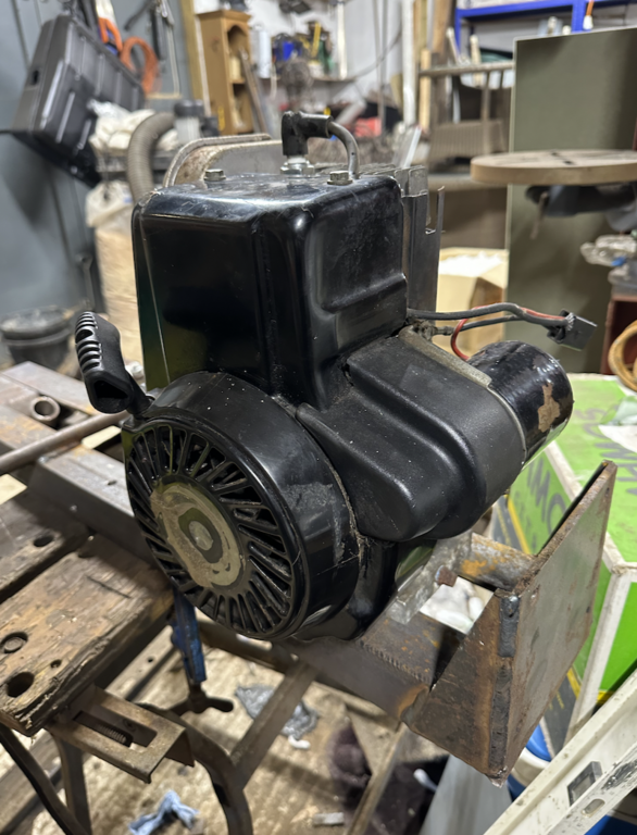

meadowfield 3,190 #6 Posted January 3, 2025 H55 and H60 are tricky to get in the US - even rarer over here in the UK. However we have a cylinder (reel) mower made here that uses a very similar engine. A Tecumseh AQ148 - it's a very similar version of the old design, electric start and comparable HP. a very obvious difference is the inlet and exhaust are swapped!!! so might need some work to solve... onto that early two piece.... thought I had best take a peek inside - remarkably good, quite a lot of wear on the drive gear onto the brake drum spur. All three 1" bearings are shot, they've just crumbled. Assume it is the shell rusting and no longer retaining the needles. New bearings and seals ordered (not cheap in the UK) Onto the clutch Idler, my best estimation from the photos. 7 Share this post Link to post Share on other sites

peter lena 10,065 #9 Posted January 3, 2025 @meadowfield is that 3/8 angle steel ? on the frame set up ? have some left from back in the day , dumpster diving , nice looking welding flow , also that steering chain is a definite , you cant do that , from the purists , another ,those frame rails are a good place to lay in a 5/16 steel brake line , eliminate a lot of fuel hose break down , fit it into the angle bend area , then a short run to fuel tank / carb , that clutch idler is a regular lubrication failure / also undersize bearing , good spot to eliminate that . thank you for the pictures , pete Share this post Link to post Share on other sites
meadowfield 3,190 #10 Posted January 4, 2025 On 1/3/2025 at 3:52 PM, peter lena said: @meadowfield is that 3/8 angle steel ? on the frame set up ? have some left from back in the day , dumpster diving , nice looking welding flow , also that steering chain is a definite , you cant do that , from the purists , another ,those frame rails are a good place to lay in a 5/16 steel brake line , eliminate a lot of fuel hose break down , fit it into the angle bend area , then a short run to fuel tank / carb , that clutch idler is a regular lubrication failure / also undersize bearing , good spot to eliminate that . thank you for the pictures , pete It’s 1/4” x 2” angle, thanks 1 Share this post Link to post Share on other sites

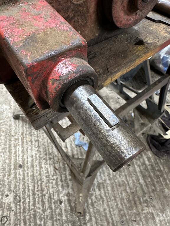

meadowfield 3,190 #11 Posted January 4, 2025 (edited) Little more today, 3x new 1” needles and seals, new gasket and hopefully good for another 60 years! new keys for the axle too, before sliding the hubs on. Edited January 4, 2025 by meadowfield 2 2 Share this post Link to post Share on other sites

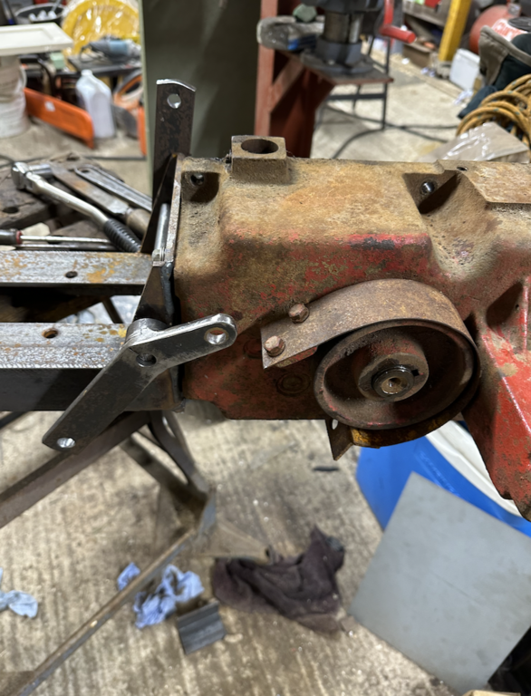

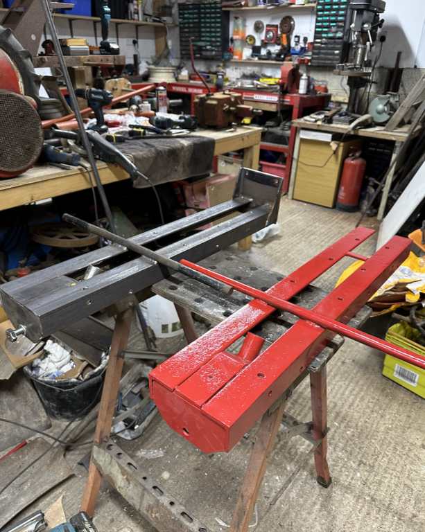

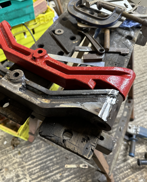

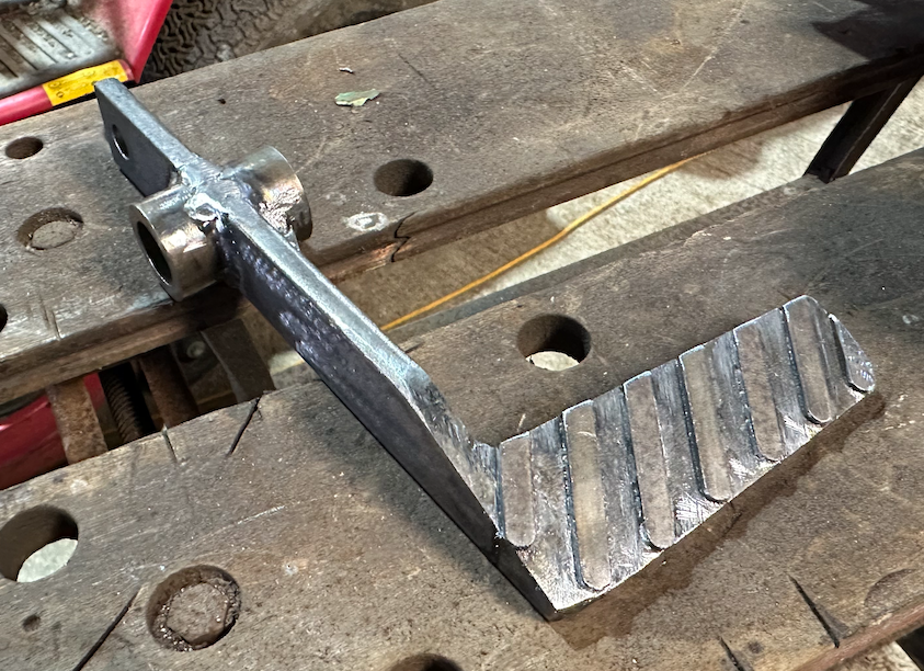

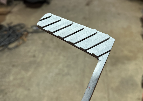

meadowfield 3,190 #13 Posted February 17, 2025 small update - busy on other things. But managed to do a reasonable copy of the clutch/brake pedal. Main bit by me, the detail that makes it look a bit more authentic was by Ewan. 7 8 Share this post Link to post Share on other sites

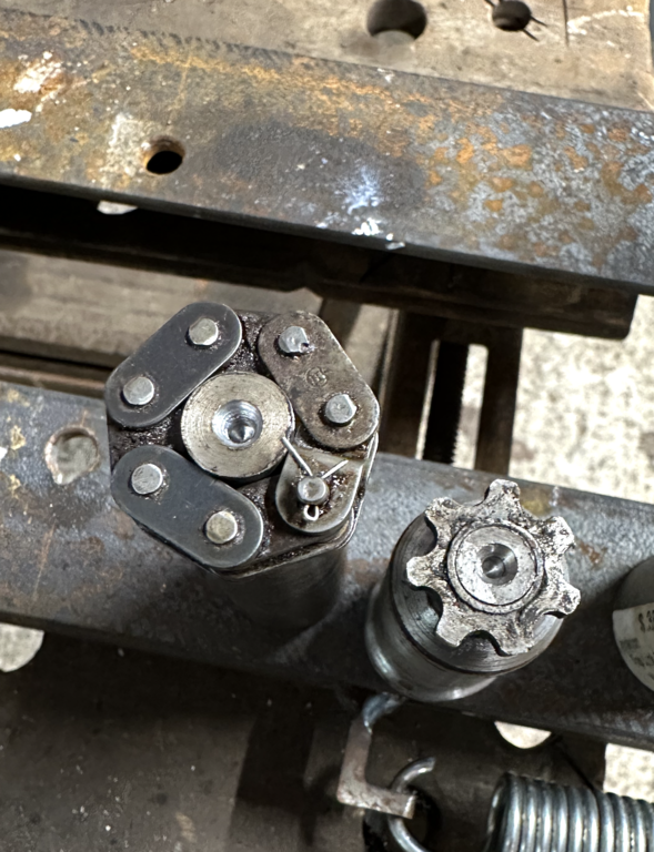

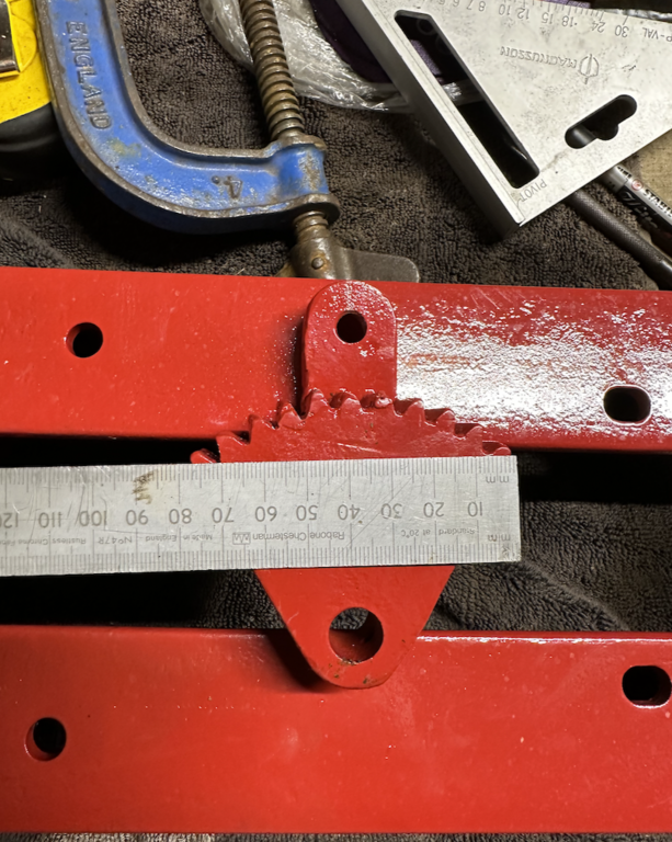

meadowfield 3,190 #16 Posted May 1, 2025 Had another think of the steering - not happy with the small homemade 7 tooth steering sprocket.... Works very well and smooth! I think it will outperform the original in terms of lifetime 1 8 1 Share this post Link to post Share on other sites

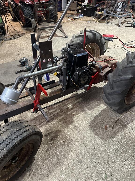

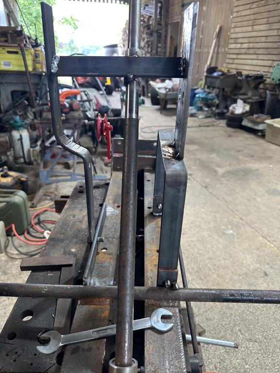

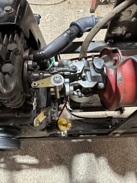

meadowfield 3,190 #18 Posted July 19, 2025 Few more updates… the drawings from @oliver2-44 were spot on, but had to cut tabs off and mirror the frame due to the swapped ports on the engine. 6 1 Share this post Link to post Share on other sites
wallfish 20,618 #19 Posted July 19, 2025 Nice work That mirrored hood stand is going to send someone's head spinning in the future! 2 Share this post Link to post Share on other sites

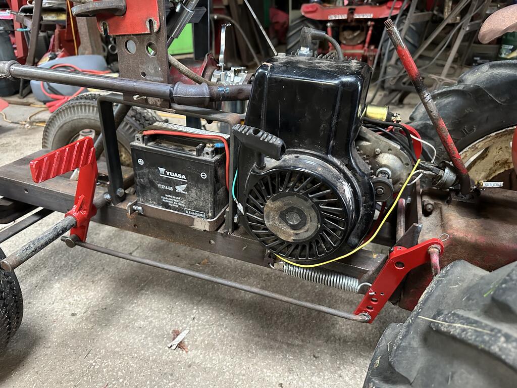

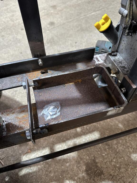

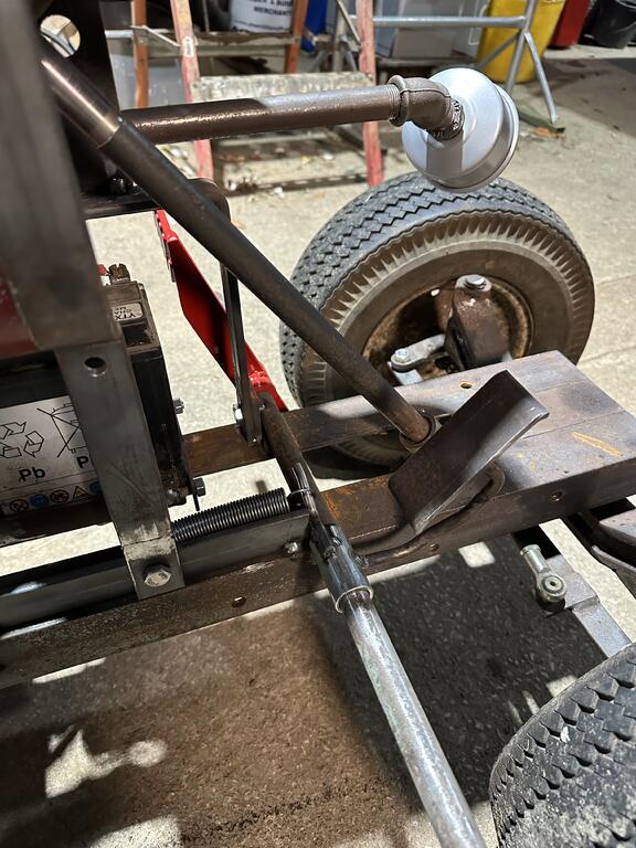

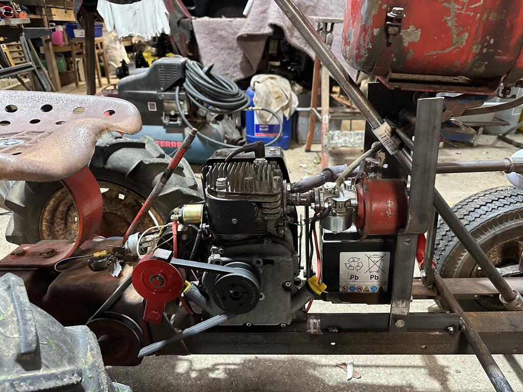

meadowfield 3,190 #24 Posted September 7, 2025 (edited) Latest update made a battery tray Idler and clutch sorted Starts on the key, just missing a throttle lever! Had to go for a spin! D91CC3A5-8B40-413C-9590-4B2A69D9EA58.mov Edited September 7, 2025 by meadowfield 6 Share this post Link to post Share on other sites
meadowfield 3,190 #25 Posted September 11, 2025 (edited) A bit more, added a gas pedal and sorted out the convoluted throttle linkage... pretty nippy and a bit more fun to drive Edited September 11, 2025 by meadowfield 4 Share this post Link to post Share on other sites
